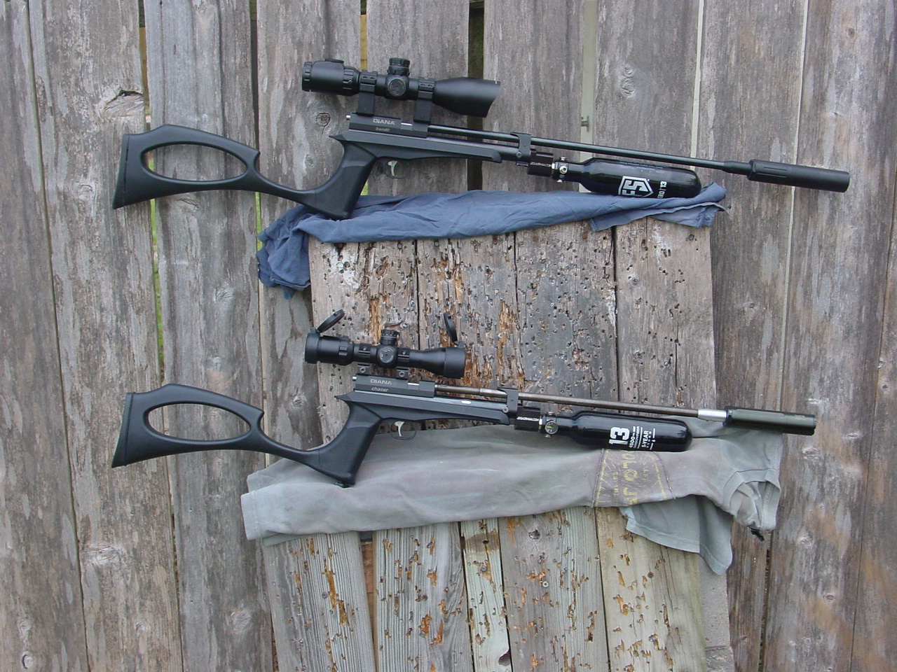

My Bandit and Chaser bottle guns
Both guns are setup low pressure 13 ci/ 1000psi first strike hero regulators on the bottles. Bandit shooting hades 10.3 725/720fps no shot count as of yet. Chaser shooting 680/690fps no shot count yet. How ever I have did a shot count with the Chaser 13ci aluminum bottle 3000psi down to 500psi.

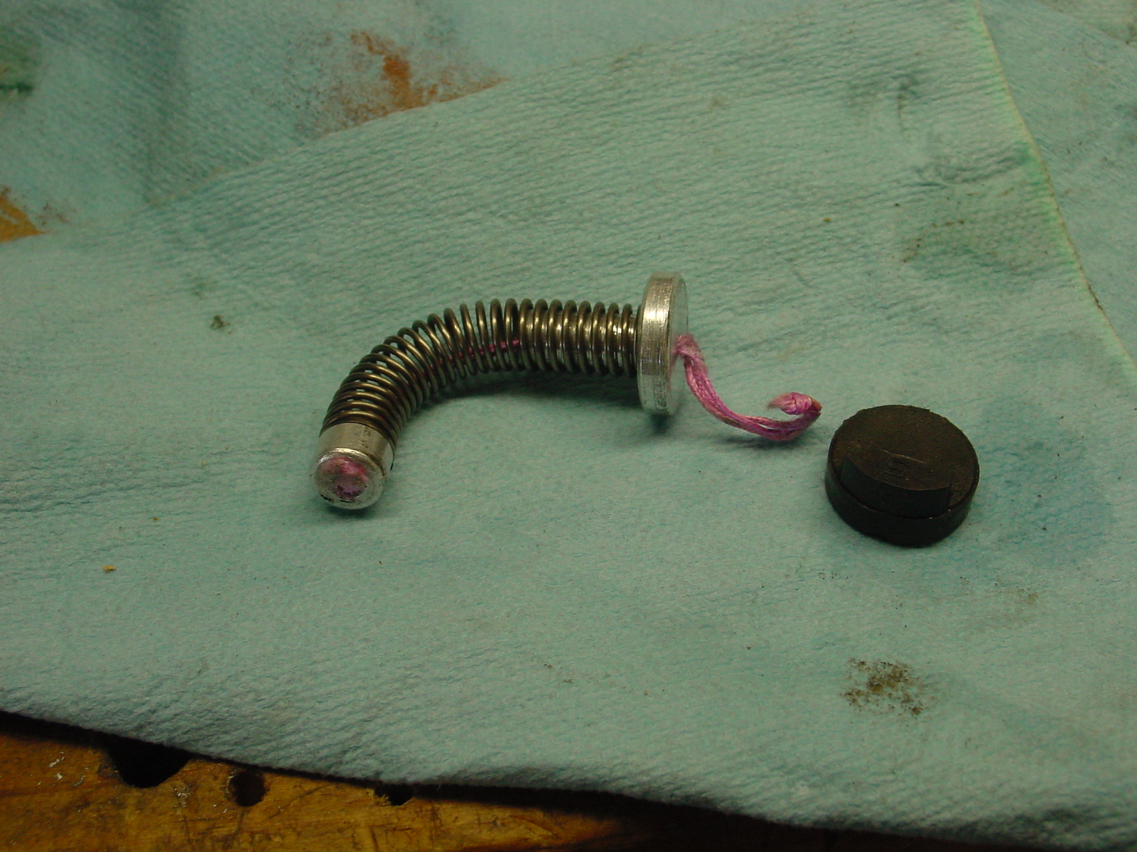

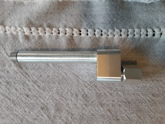

Jdsairman adapters are no longer made. The HDD is of my making the spring is out of a Chaser parts gun. Bottles are from ansgear.com and you can find just the bottles no reg at eBay got my 15 ci bottle there. Was a pretty sad day when Jdsairman went out of business just when Bandit and Chaser entered the market. The guy was from Florida if you could run him down you might be able to purchase the design.

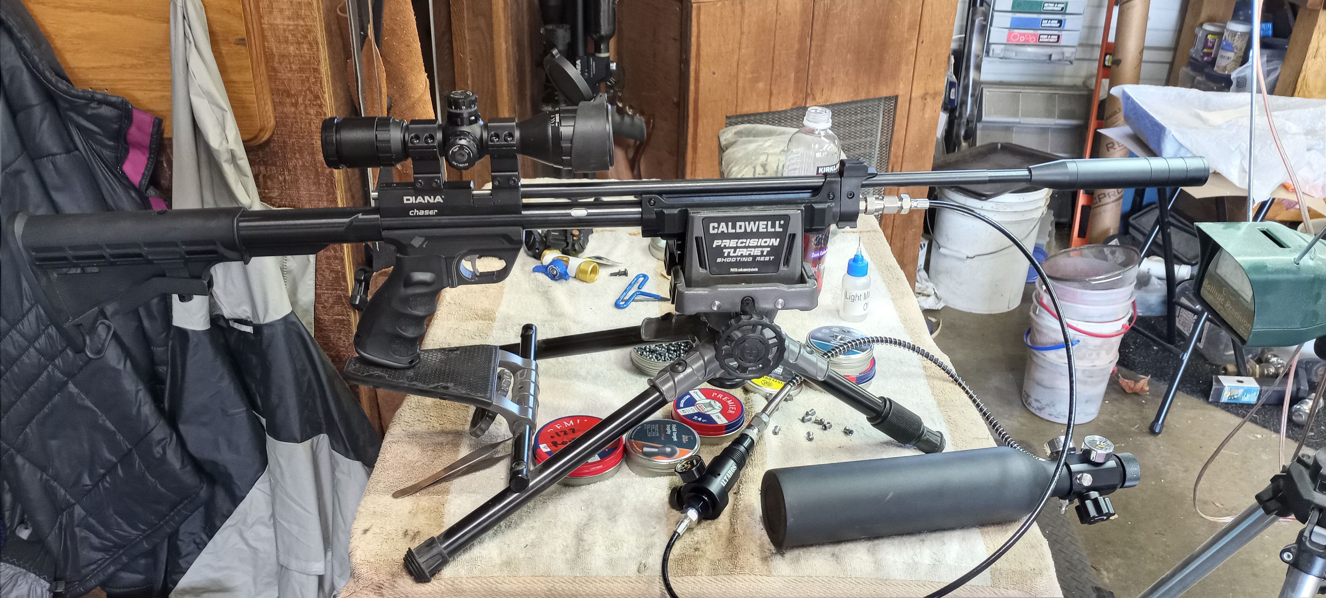

I have both the Safepack and the dropblock, I am still waiting on the regulator to arrive but there will be a .3L bottle attached to my .22 Chaser for plinking fun. Here is the dropblock from Etsy:

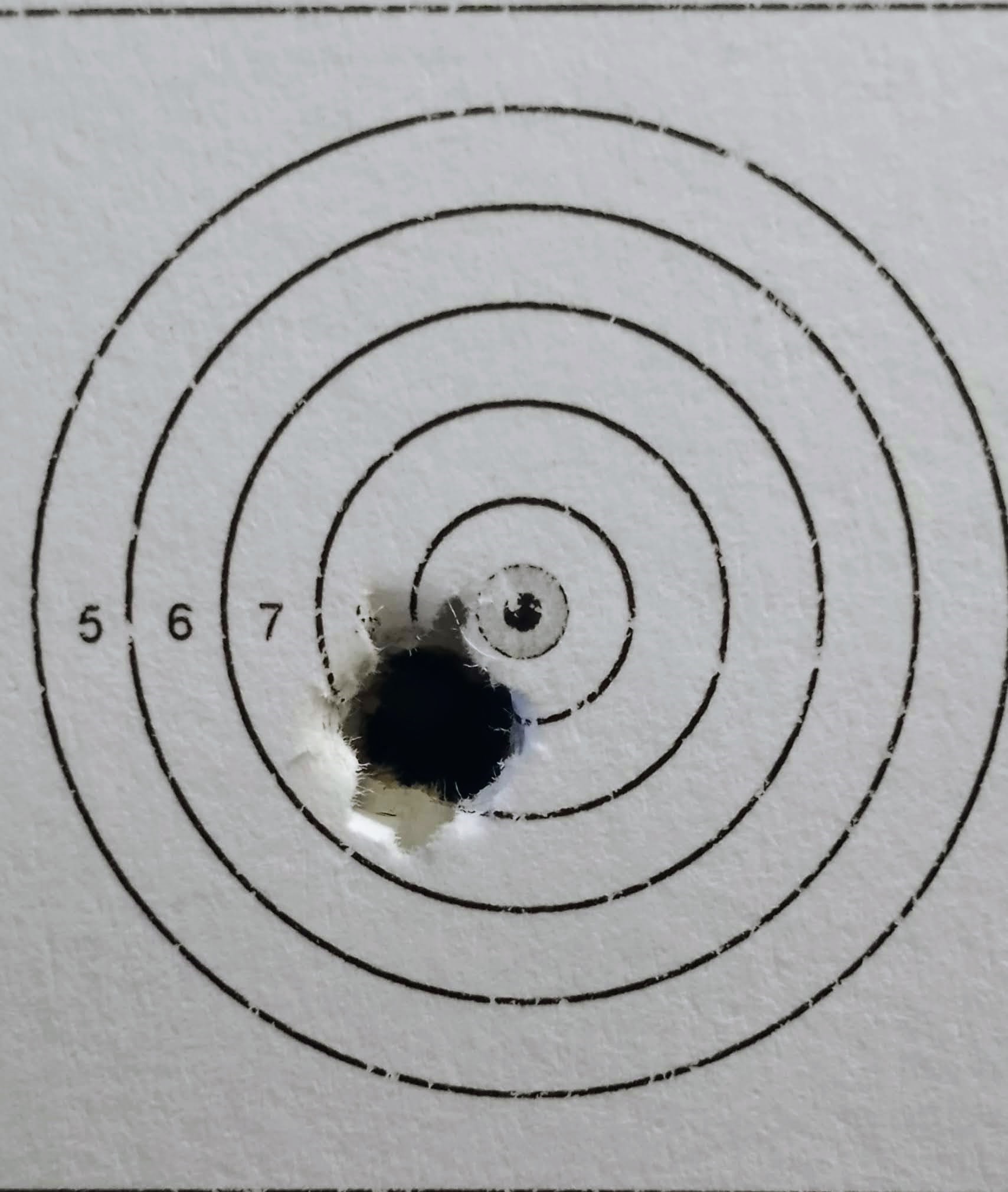

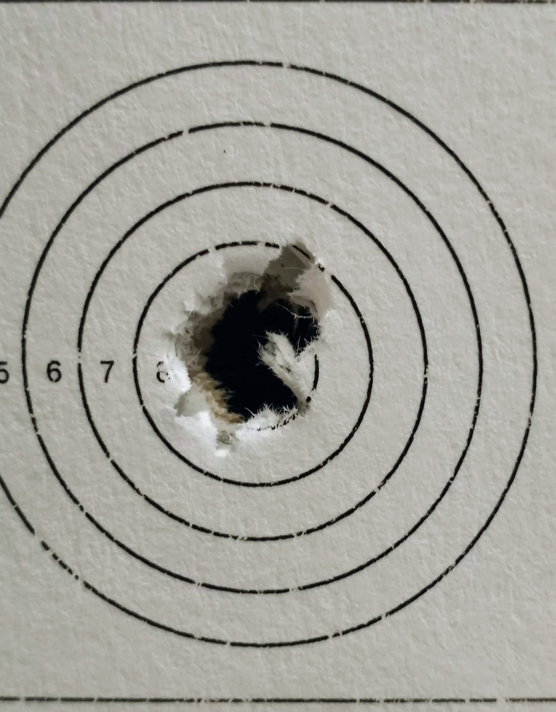

I tore the gun all the way down, polished out the breach, polished up the crown, cleaned the barrel, dropped the regulator (Altros) from 2200 psi to just 800 PSI and got the 8.63gr H&N field trophy pellets to shoot right at 870 FPS.
Groups reduced from 1.22" at 10m to .1" at 10m. If I spend the time and really aim, I am getting hole in hole groups now that the barrel is fouled properly.
The .5L bottle started at 3600 PSI and finished a 120 shot card at 2500 PSI. Lots of shots for very little air.
Parts arrived for the .22 bottle gun today but 2 of the 3 parts that should have been included in the package were not included so the build is delayed once more.

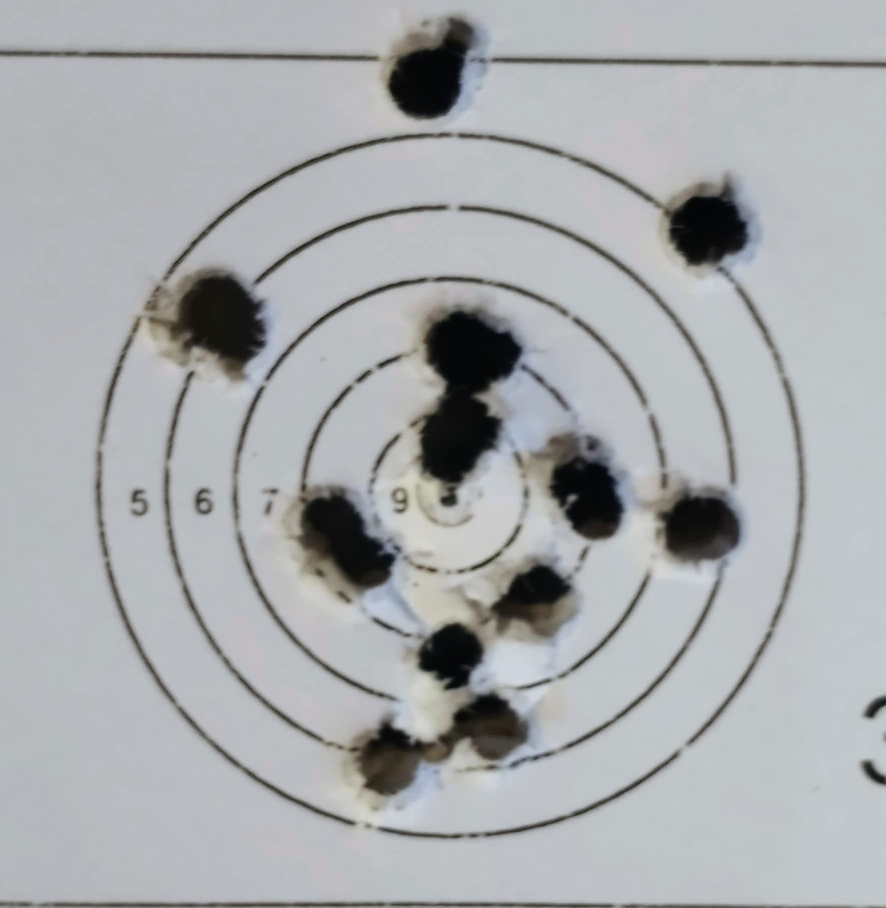

I took her out for another night of bench shooting and I think I need to pull the barrel and clean it once again. Groups opened up to .3".
The breach is still very tight when loading, the oring is right but tight so I may look for another comp to ease loading.
Also, I have 3 or 4 more pellets left to try. I am hoping I find the golden child in a cheap pellet. Still waiting to try the Crosman domes.
