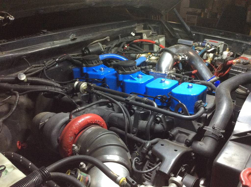

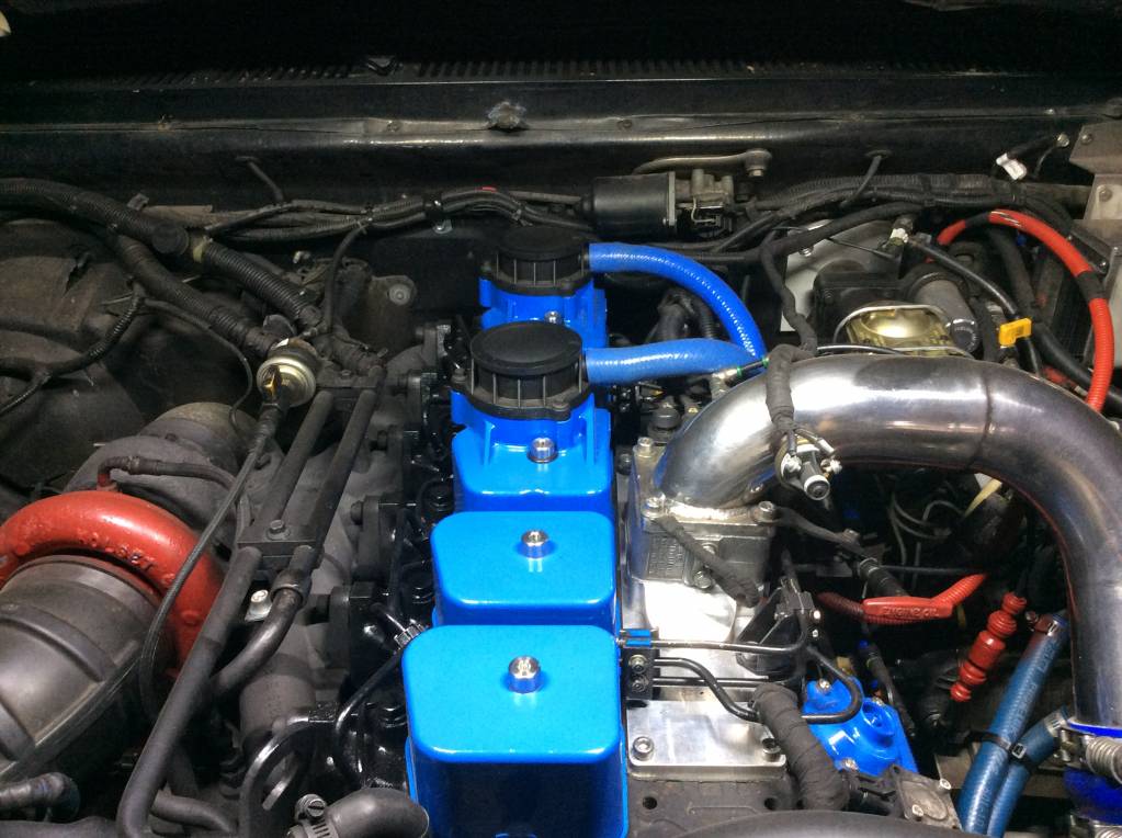

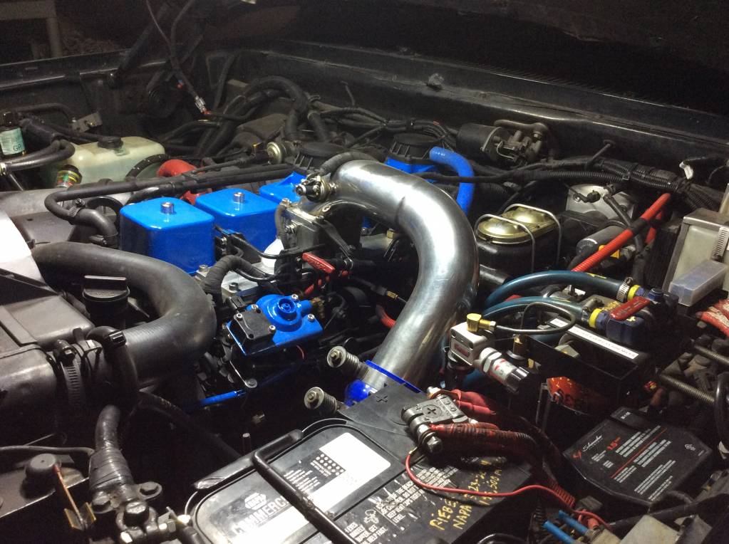

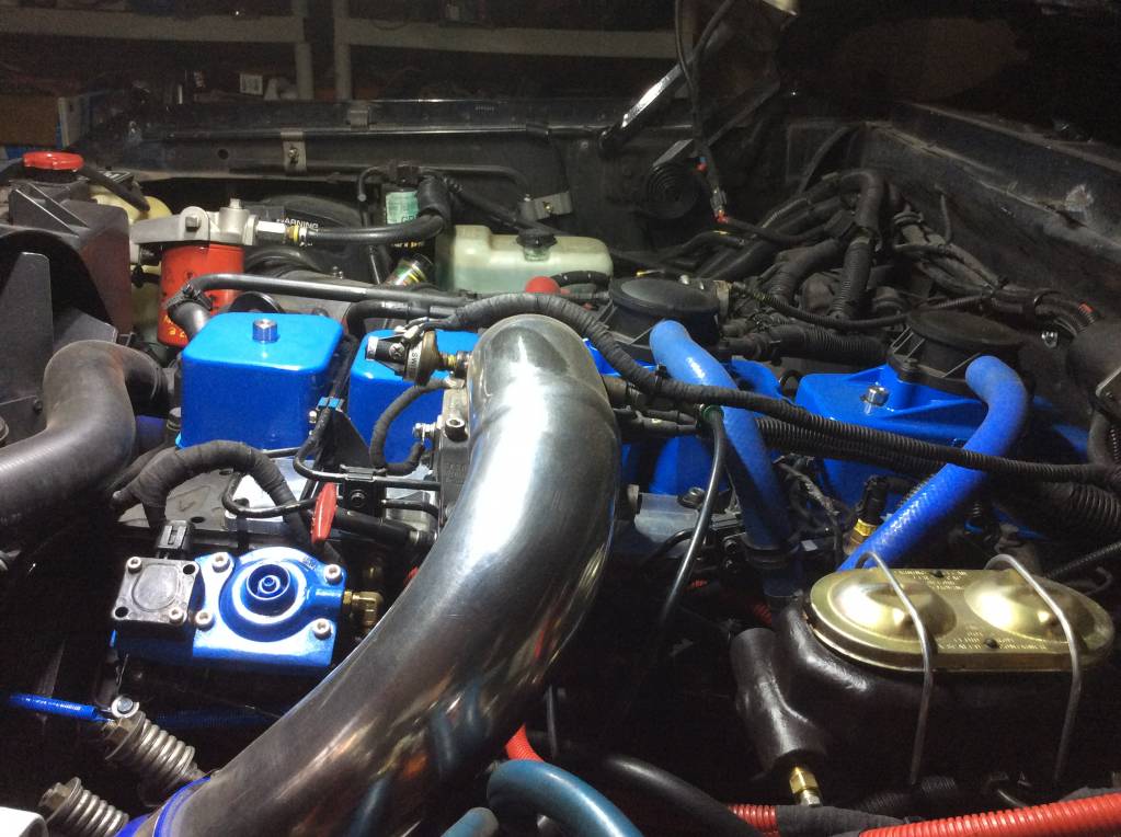

The last big task item I had to do to it was the crankshaft thrust bearing plate at the rear, it’s retaining ears snapped off. No more than .11 to .15 end play front to rear on the crankshaft, and it was at .48. That little bit caused the torque converter to balloon forward.
i had to cherry pick the front of the engine 12” above the radiator just to remove the oil pan, which allowed access to the crankshaft. I not only replaced the broken thrust bearing but figured while I was there to replace all crank bearings along with the piston rod bearings with all factory Cummins parts.
Had the torque converter rebuilt to 80% stall and since I had the tranny and transfer case off the truck I addressed some leaky seals.

I put in 60 HP variable spray injectors in there and still haven’t gotten to play with them enough.
