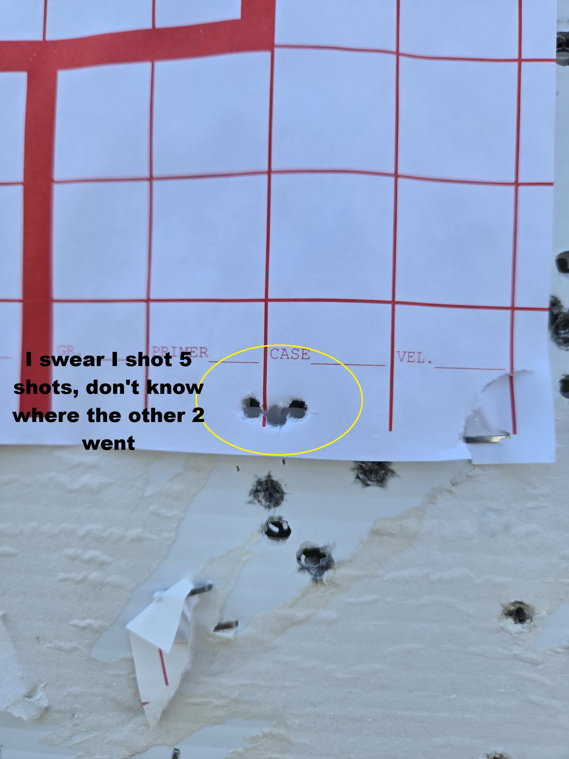

50 yard groups, 5 mph switchy wind
Also 50 yards, windier but less switchy

Here's some photos. I'll post my thoughts after the Abilene match.

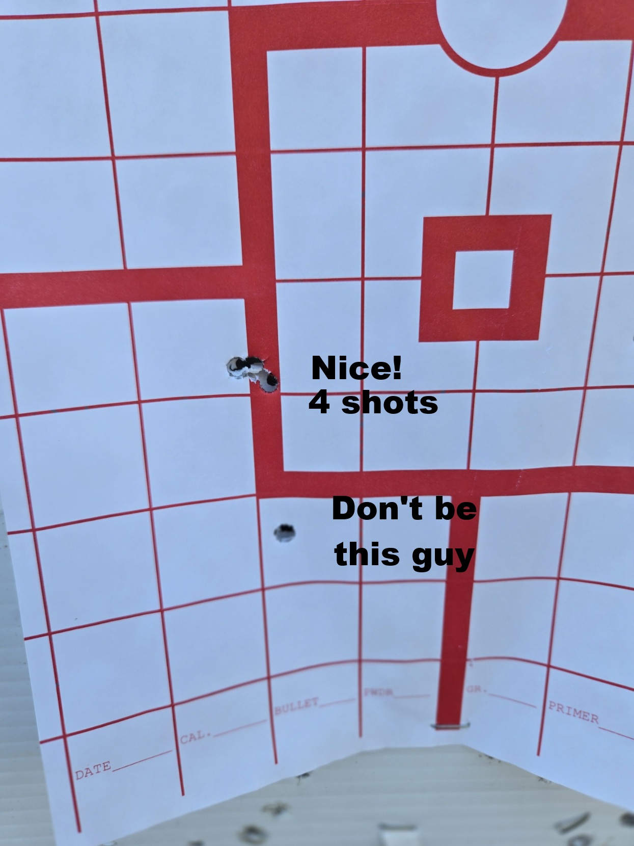

The Abilene match was a success if the goal was to see how the RAW shoots in terrible, swirly, West Texas winds. On paper, it was a failure, but the score card doesn't tell the whole story.
I've never shot well at Abilene mostly due to the wind, which is why I keep going back. I shot a 321 today, compared to a 412 last week on the same course of fire with much less wind. By comparison, the match winner (who is a very good shooter) shot a 420 today, so it wasn't hard on just me.
Positives -
I hit 4 of the KYL targets that I missed last week.
I did an OK job seeing wind shifts and lulls mid-stage.
My dope was good.
Negatives -
I had a weird double feed that cost me a hit.
I had an almost ND. I hit the trigger with my pinky when closing the bolt. Luckily I was on target and actually hit the target. I need to be more deliberate when closing the bolt, especially when in a hurry.
I struggled to see my impacts, which is something I've been working on lately. At this location, you aren't going to see a miss so you have to get your wind corrections off of hits. I might paint the base of the slugs to see if I can pick up the slugs in flight. I've tried that before with mixed results.
I was wobbly on a couple of positions where I'm usually not wobbly. I dropped 4 shots for sure due to wobble, that's not acceptable on a day where hits are hard to come by.
So I'm going to give the gun an A- today and give myself a solid C. I'm pretty sure I would have shot close to the same score with my rimfire rifle today, which says something about how the gun shot and how I shot.

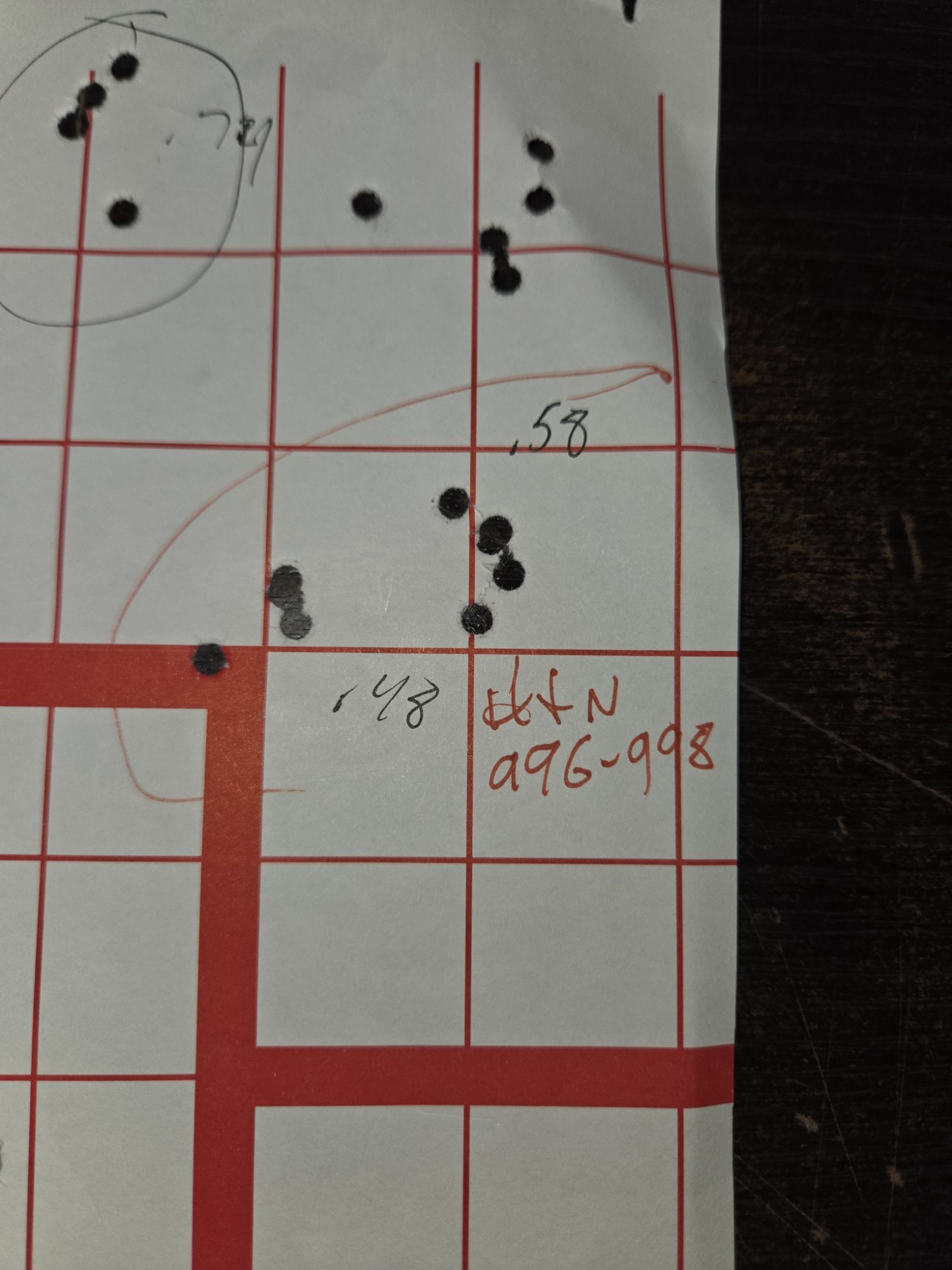

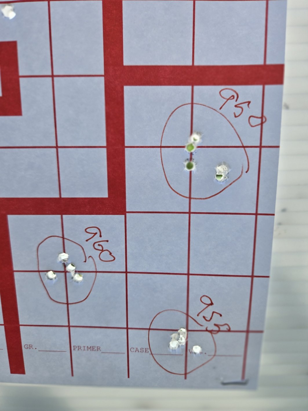

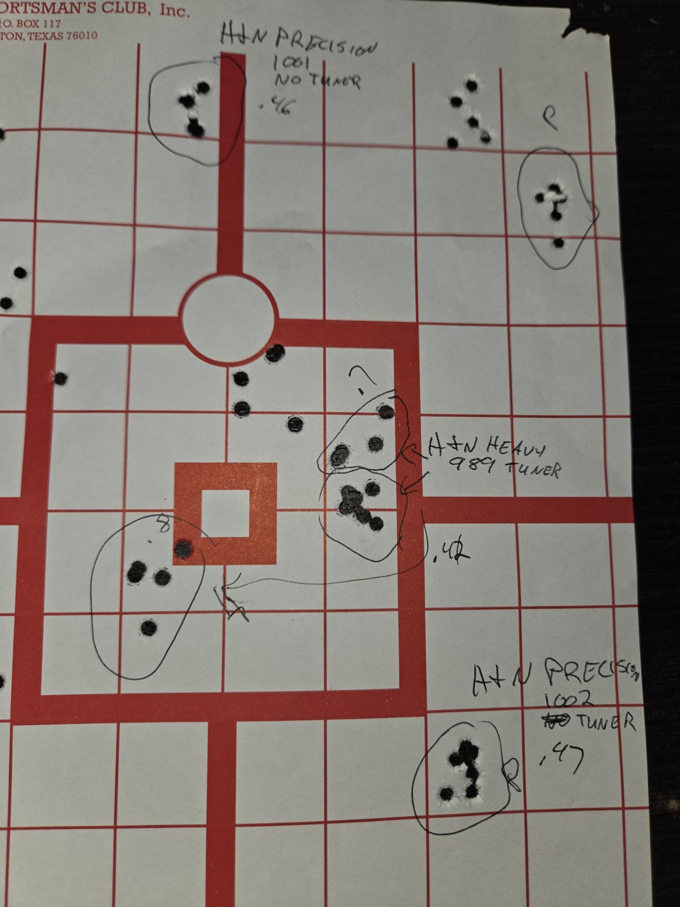

I did some more tuning yesterday to see if a lower speed node would group better at 50 yards. This months course of fire has a lot of small targets from 43 to 65 yards, so I want to focus on the closer shots even if I give up a little accuracy at 100 yards.
My method was to start at the most recent tune (180 bar, 1 1/4 hammer spring out from lock up) and shoot 5 shots, then turn the hammer spring out half a turn and shoot another group, etc. I went from 1001 fps down to 925 fps. At 925 fps, the groups really opened up and the SD and ES got pretty bad, so I clearly wasn't getting full air from the valve. So I have my floor and my ceiling. There was a promising group at 960 fps, some from 925 I went up a quarter of a turn on the hammer spring and shot groups until something interesting happened. Around 940 to 960 I started seeing some good groups, but everything over 950 produced flyers. I narrowed it down to 944 FPS, which is 2 3/8 turns out from lock up, or 1 complete turn out from the 1001 fps tune.
At 100 yards, the group was fine, .2 or .3 mils lower than the high speed tune. I think the higher speed tune was a little tighter, but it's good enough for 2.5" targets at 100 yards. If I decide to stay with this lower speed tune, I'll probably turn the reg down a little to get more shots per fill.
I messed around with painting the bases of some slugs to make them more visible in flight. I took some crappy slugs and painted the bases with pearly white nail polish. Then I painted over half of the pearly whites with hooker red (actually it's "Holiday Red", but if you see this at a Christmas party, it will probably be worn by a hooker). I loaded alternating colors in a mag and shot at a dirt berm at 100 yards. The pearly whites were very visible at 12X, the red slugs were not visible at all. So I painted the bases on some of my good slugs with pearly white, next time I go to the range I'll mix some painted slugs in and make sure they group the same.
I also did a little scope swap. My rimfire rifle has been having a weird .3-.5 POI shift after 4 or 5 stages in the last 4 matches. It's either the scope, rings, base, ammo or gun. So to try to figure it out, I put the Tract Toric on the rimfire rifle and the Athlon Midas Tac on the RAW. I also put my big Discovery on my RPR to use as a loaner at my next match. I got everything sighted in with the new glass at 25 yards, and the RAW had a much tighter group than the Bergara or RPR, even with the high speed tune and the slugs that aren't it's favorite. No real commentary on this, I just thought it was weird.
Next step will be more fine tuning at 944ish fps. And apparently I have to shoot field target in a couple of weeks so I need to figure out a gun. I'll probably put the .177 barrel in the Avenge X with the Falcon T50 and shoot Hunter. Or maybe the HW97 WFTF. Nah, it's going to be hot as balls, I don't need to be wearing a jacket or shooting a springer.

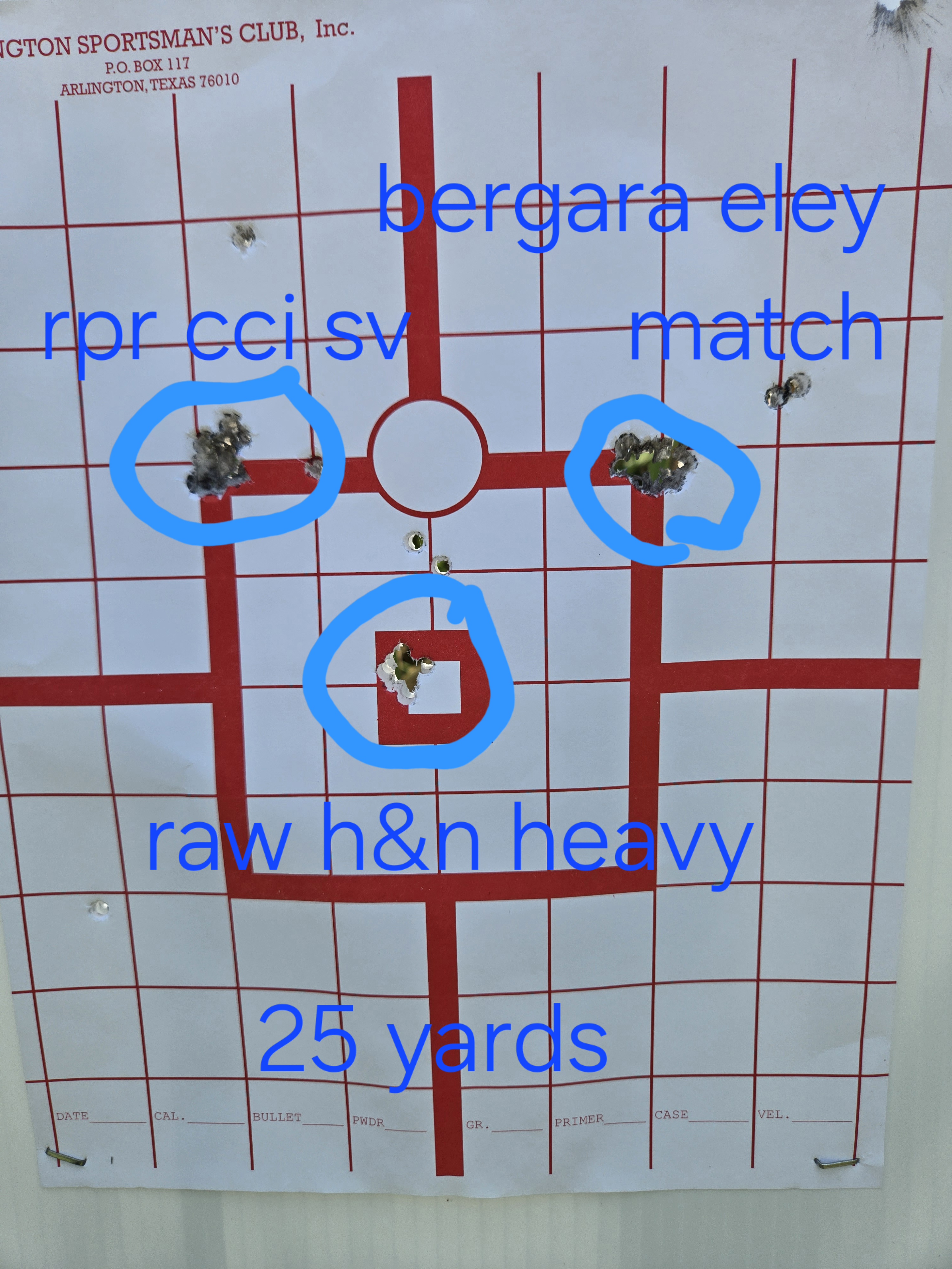

Here's a photo of the groups from tuning the H&N Precisions and a photo of the sight in mag dump at 25 yards.

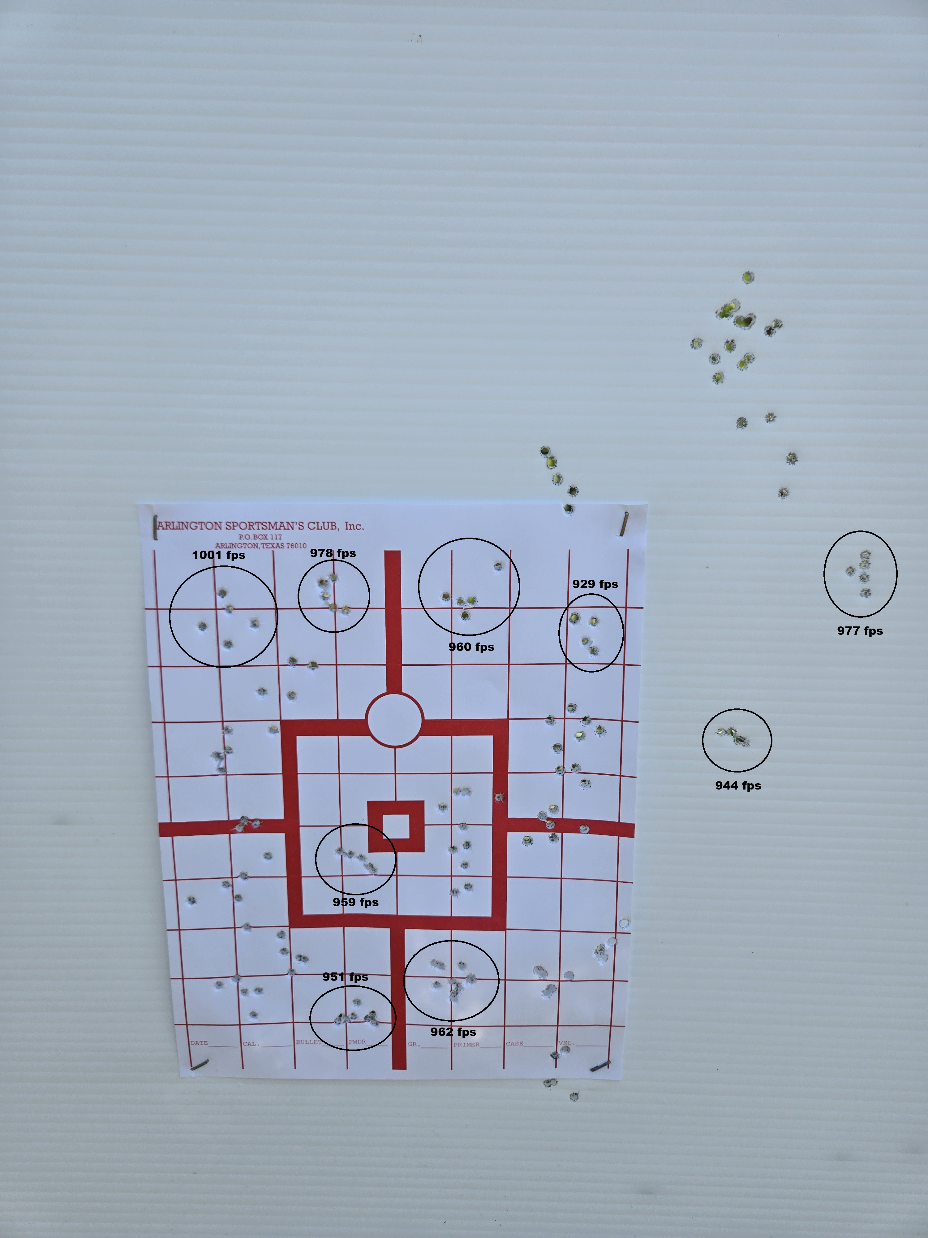

I went to the range today to further test the slow node and the fast node. As with most airguns, things can be great one day and terrible the next, so I wanted to test for repeatability.
Unfortunately the range was very busy so I didn't feel like going downrange to hang targets on multiple ranges, so I went with a quick and dirty range session. The result of this is I only took a photo of one target, we'll get to that in a bit.
So the plan was to start with the last slow setting at 50 yards, shoot a couple of groups (after foulers since I cleaned the barrel), then crank the hammer spring up about 1 1/8 turns to 1000 fps and shoot some more groups. Then repeat at 100 yards.
I made one small ammo change, I switched to a different lube. I've been using Ballistol but I wanted to try something else. I have a can of Safari Charlie that I bought at Ray's Sporting Goods in West Dallas about a million years ago, and it has a pleasant scent, so I tried it. When I took the slugs out of the tin at the range, they were bone dry and did not feel lubed at all. They shot ok, but the barrel was dirtier when I was done than it usually is, so I'm going back to Ballistol.
At the range, my initial shots were coming in hot, around 960 fps where they were 944 fps a few days ago. Maybe the heat, maybe the new lube, maybe something else. Regardless, I shot a group and it was meh, so I went ahead and cranked the hammer up to 1000 fps. The groups at 1000 fps were terrible, so I went down 8 clicks on the hammer spring and I was still getting 970-ish fps. I went down 2 more clicks and got very large ES, like 30 fps swings. I started creeping up on the hammer spring until the velocity stabilized, and around 960 fps I got some great 50 yard groups.
I moved to the 100 yard range and I got an adequate group of about 1 to 1 1/4 inch. I also shot some Zans to make sure they still suck. They do. Bummer, I like shooting Zans but if the gun doesn't like them, I'm not going to argue with it.
Then I headed to the 200 yard range and shot the group in the photo. I was pretty pleased with this group, especially since the guy next to me was showering me with brass. At least he was shooting suppressed.
It looks like I need to keep this tune in the rifle, and when I zero before a match I need to microadjust the hammer spring until I get good groups, then just plug that speed into my ballistic calculator. I wanted to shoot at 200 to see if it would be feasible to shoot this rifle in a PRS match this weekend. The match doesn't have an air rifle option, so I would be shooting in Open class. I think I'll go to another club this week where I can practice at long range in the wind and see how it goes.
Here's my 200 yard 5 shot group. Ignore the shot at the bottom left, I couldn't see the impacts so I was spraying shots all over the place to try to see something. Turns out my first 5 shots were actually where I intended, aim point was the center of the target. If you are one of those people that think that 10 shot groups are necessary to measure a gun's accuracy, I would encourage you to send me ammo. But if I'm paying for my own ammo, I'm going to shoot 5 shot groups.

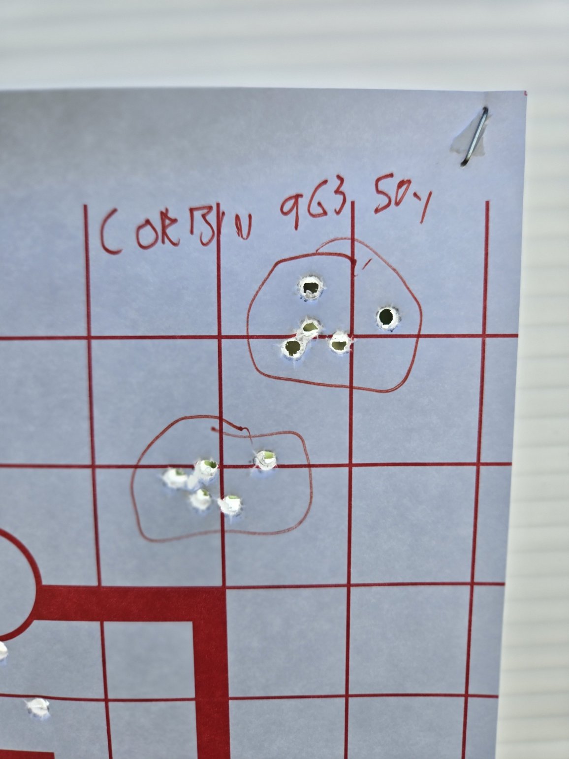

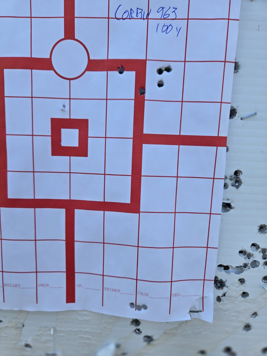

I stole a couple of tins of the magic Corbin slugs from Cloud, enough for a little testing but not enough to super fine tune if I want to have enough to shoot in a match. I went to the range today to see if I could use these for an upcoming PRS match. Short answer is: Yes.
Here's the long answer.

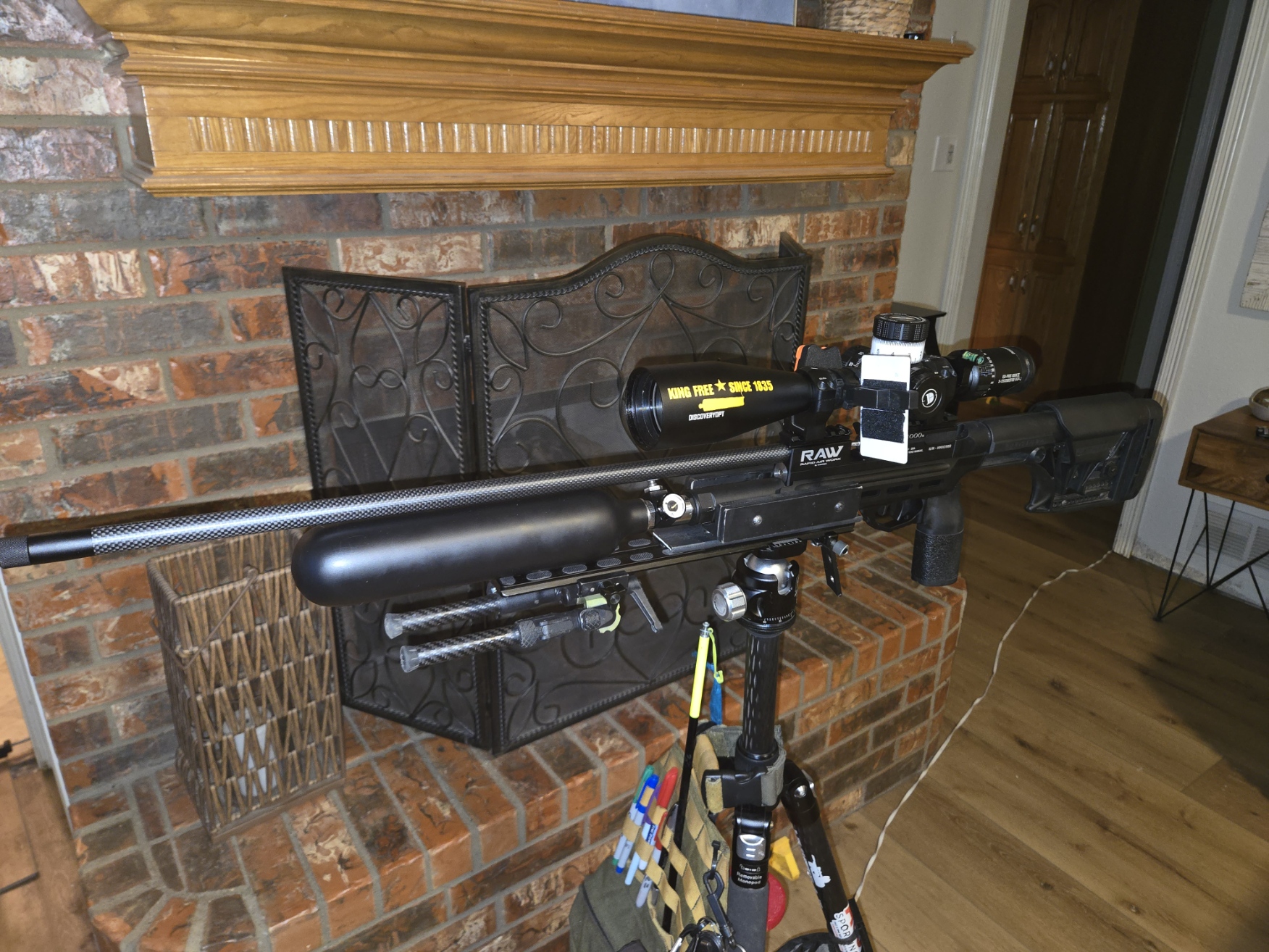

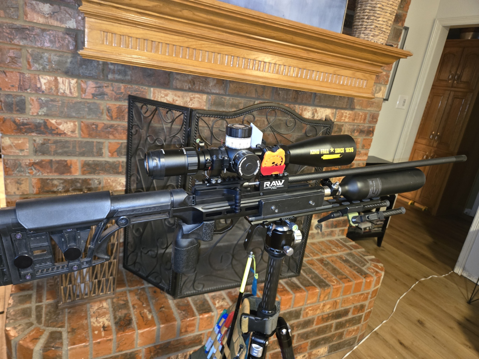

First thing I did was put the Tract Toric back on the RAW. The Athlon Midas Tac is fine, but the difference in glass quality is noticeable.
I also added a longer steel bar sandwiched between the Arca rail and the chassis. So now I have two 1/4 x 1 1/2 inch steel bars between the Arca and chassis. These are for weight and to add rigidity to the Arca rail, which sticks out halfway to the end of the bottle.

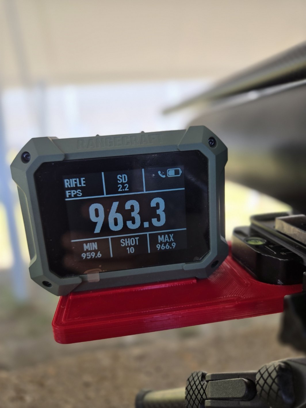

I also added a couple of shims to the hammer spring to try to get a little more speed (Spoiler: I picked up maybe 5 fps, but it shoots dirty with the spring maxed out).

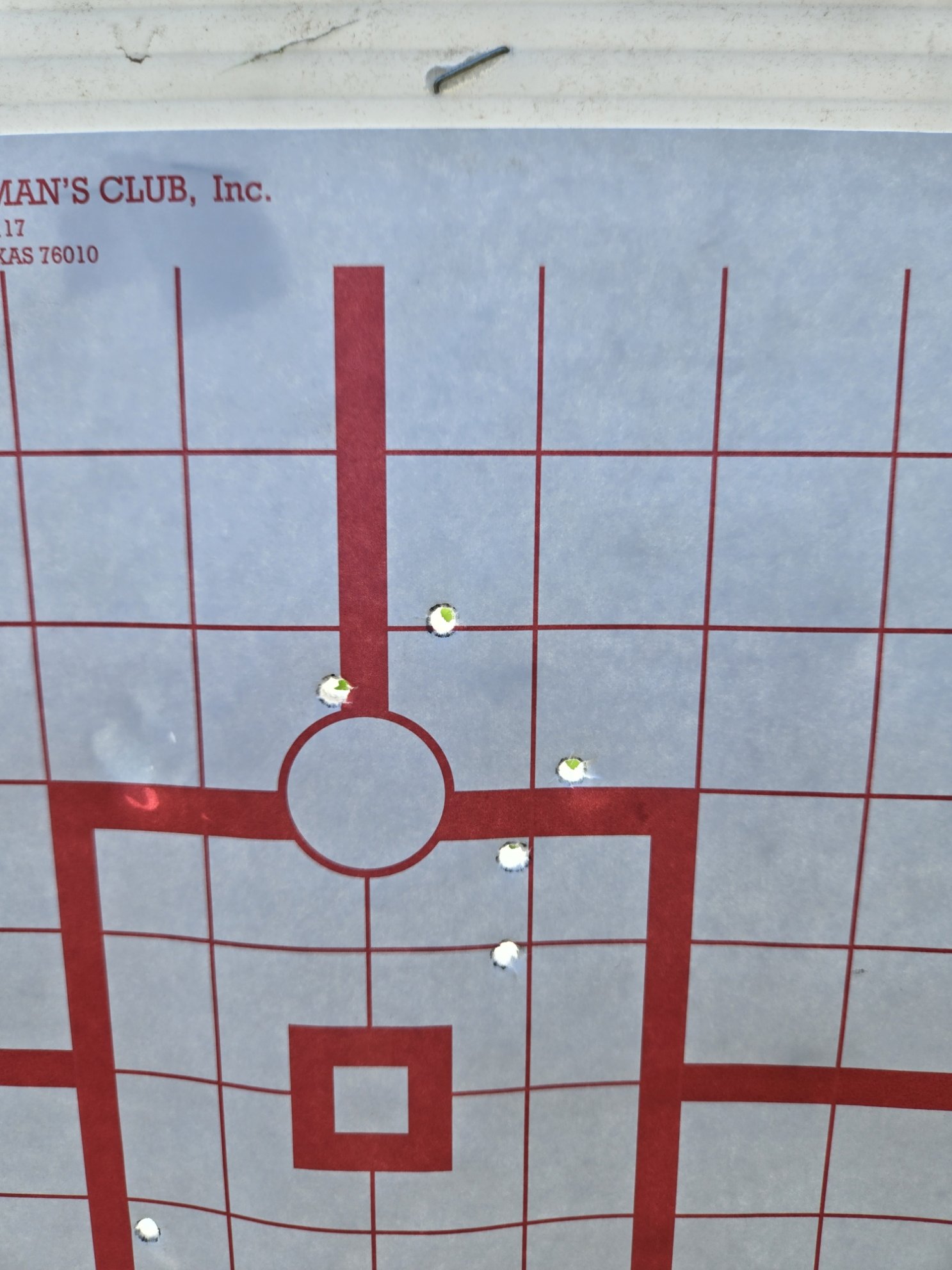

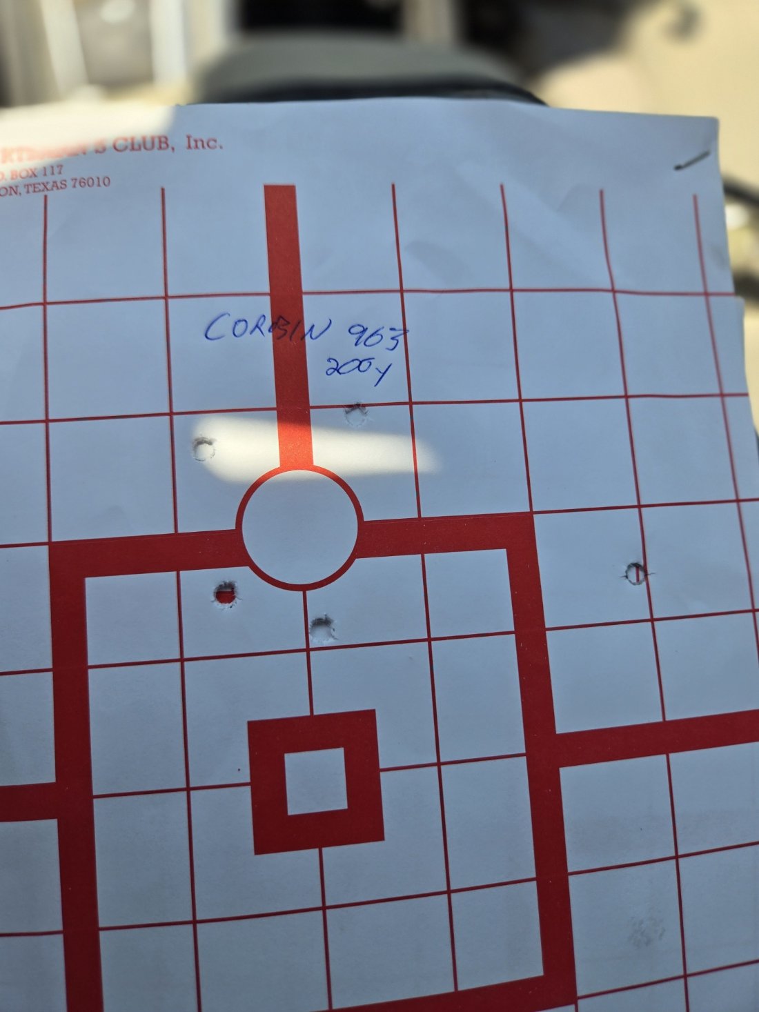

With the hammer spring maxed out I got a 963 FPS average with an SD of 5.3. I took a turn off of the hammer spring and the group tightened up a bit and the SD improved to 2.2, still shooting at 963 fps. I lowered the velocity down to about 950 and gradually increased it back up to about 960 until the 50 yard groups got tight. Then I shot some groups at 100. I had some split groups, with 3 shots touching and two shots touching an inch away. I dropped the hammer spring about a quarter of a turn and the group got more consistent. Then I shot at 200. Groups were ok given the wind.
I was shooting 5 shot groups because I was running low on air in the big tank and I wasn't sure if the 10th shot would be off the reg. On a full fill, I'm getting 14-15 shots on reg with this tune. I thought about turning the reg up a bit, but I feel like I'm already at the limit for shot count so I'll leave it at 180 bar for now.
I was getting some odd numbers in Strelok until I realized that I had set the BC at 1.5 instead of .15. Decimal places matter, who knew? I'm having a little trouble lining up my number from 100 yards and 200 yards, but when I enter the 5 MPH tail wind I was getting they line up a little better. I think my Strelok numbers are good enough to use as a starting point in my Kestrel, then I can set up DSF starting at 150 yards instead of 200 like I would for rimfire bullets.
These slugs are shooting as good or better than anything else I've been using, especially at 100 yards. The fact that they are 40 grain and shooting a little flatter at 100 and 200 yards is great. I think the rifle would benefit from a barrel with a faster twist rate and maybe a couple more inches in length.
Don't use wind in Strelok at anything but full value (90 or 270) degrees. The calculation is wrong. I've told the developer, he doesn't care.
To verify the error... enter no wind. Check the drop table, note your muzzle velocity at 1 yd from muzzle. Now enter a 10 mph head wind (0 degrees). Check the drop table again at 1 yd from muzzle. Does it make sense to you? Sure doesn't to me.
So for your dope issue it's either going to be your muzzle velocity or BC that's causing your error. But that tail wind entry in Strelok is going to throw you off when you go to your Kestrel.

Thanks, good info. I just plugged my data into the Kestrel and it looks pretty close to what was happening at the range. I'll calibrate it when I go to the match.
