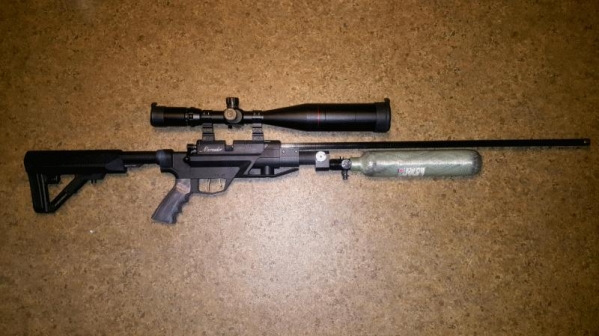

A friend of mine, Rich Dudek, made me a custom 11" Mrod tube, gauge delete, and an indexed threaded dropblock that allows use of 500cc CF tank setup with a 2600 psi regulator. On Tuesday I got the parts, Wednesday everything fell in place. 1st shot was 906 fps via handcast 60gr pellets, over 109 fpe !!! Shot count is over 30 shots before it falls off reg !!!

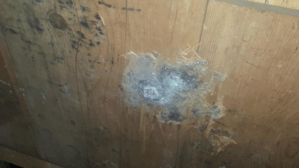

I ran a chrony string while testing indoors(foolish me) and drilled a hole thru my backstop of 6" of duct seal, 2 layers of 2x10, 3/8th" Lexan, and both sides of a concrete block :(

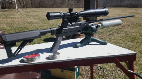

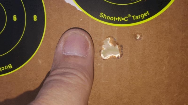

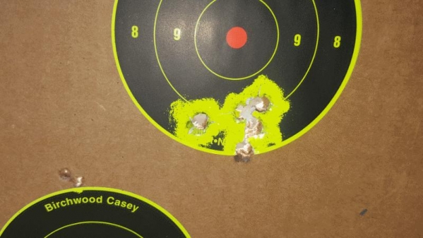

Today I tested outdoors for the 1st time. I need to bring the pellets speed to under 900 fps, groups were decent, but I think slower speeds will tighten them up. It was very windy too, 15-20 mph crosswinds.

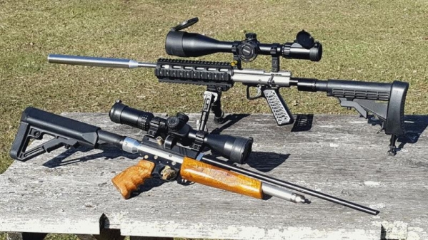

I included a pic of my Heavy .177, and Heavy .25 pcp builds. The .177 makes over 40 fpe, the .25 almost 65 fpe.
