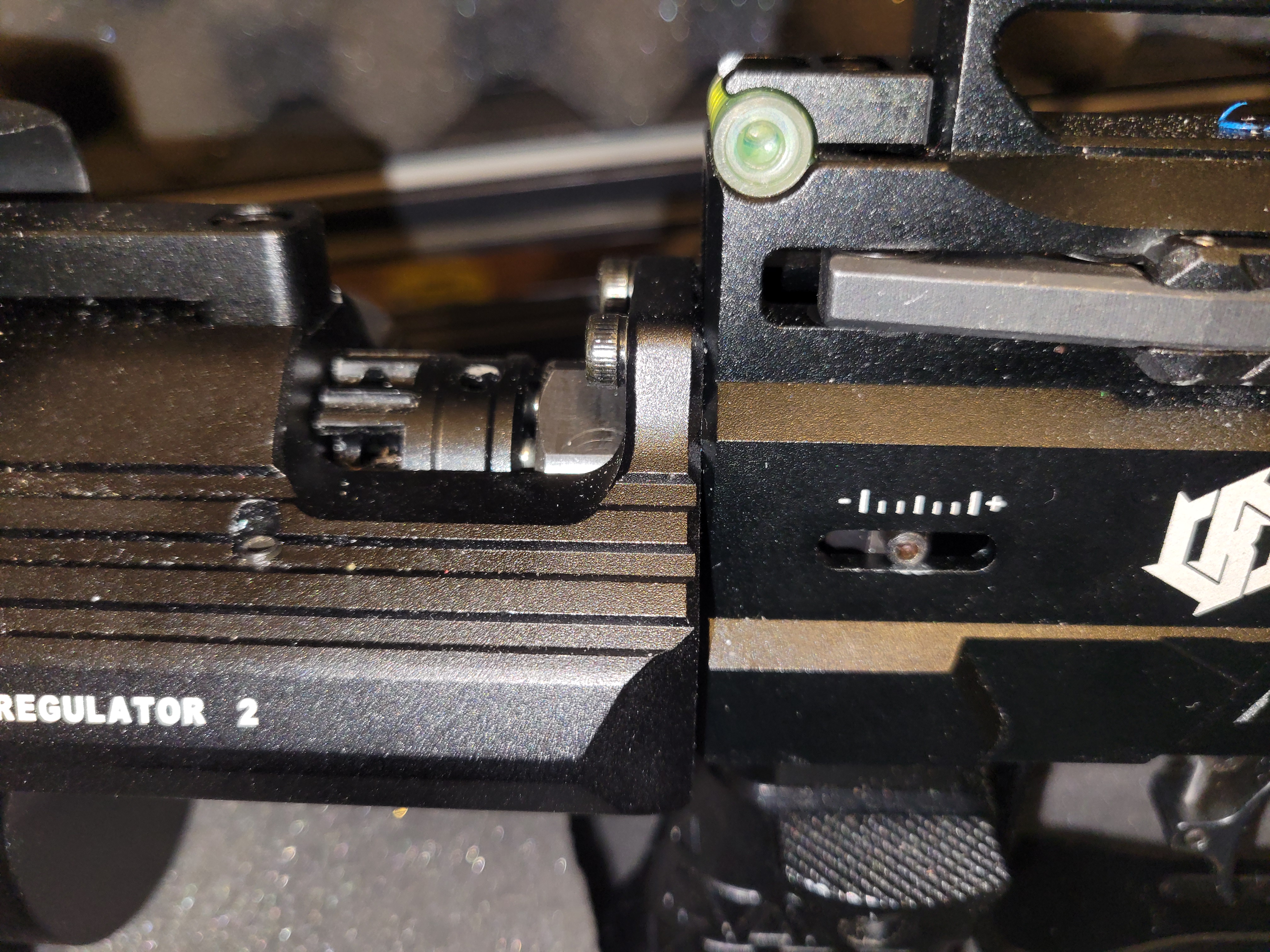

From the factory, the hammer spring tension adjustment was set too low. I noticed that after 5-7 shots the hammer spring adjustment knob would turn almost 1 full revolution in the negative. Meaning a lower hammer spring adjustment.

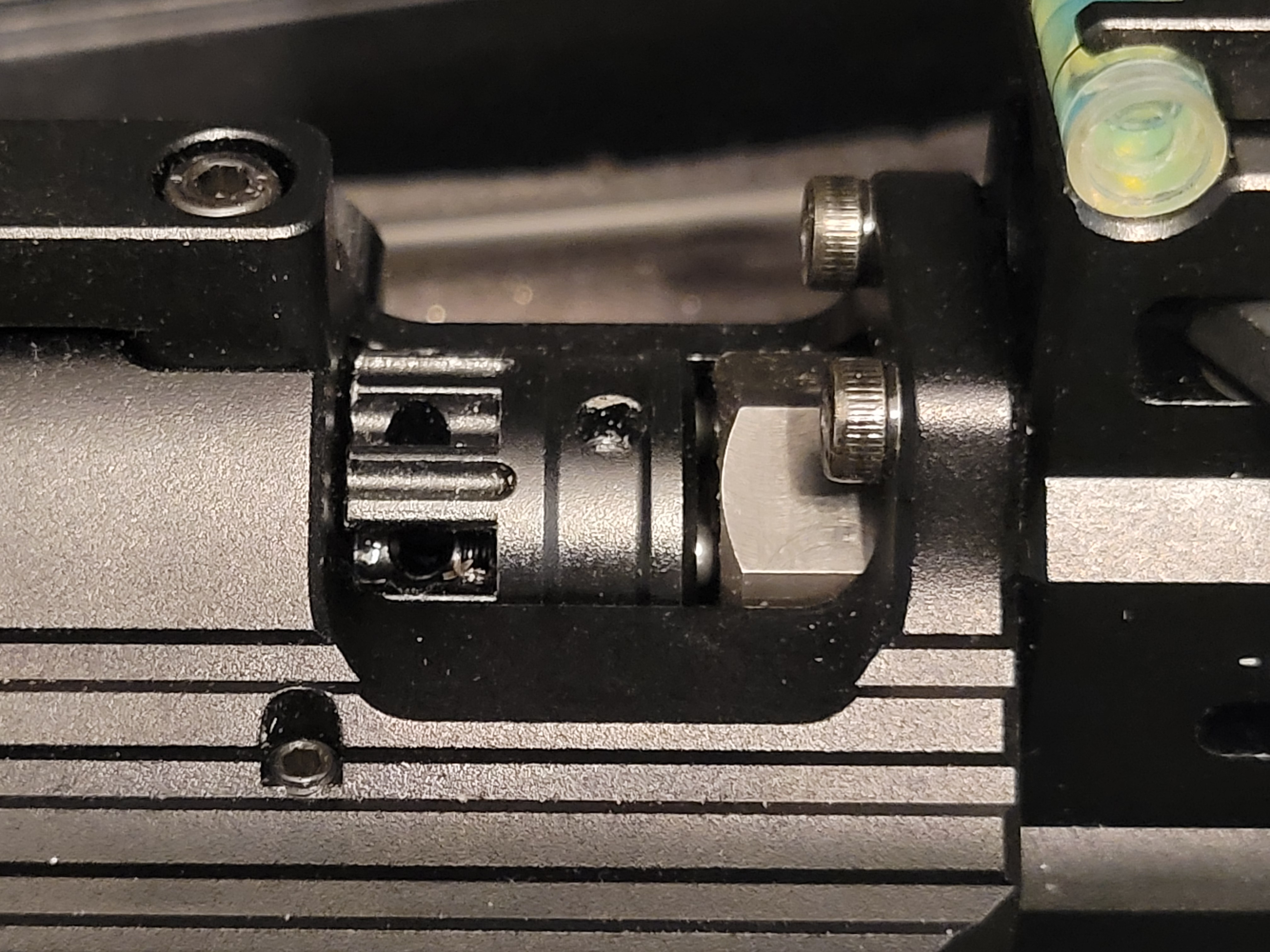

If you can "very easily" turn or spin the hammer spring adjustment knob to make +/- adjustments, it's set too low. You should feel a firm and positive indexing "click" for each +- movement. Thanks to PJ at Karma, the hammer spring tension adjustment is very easy to do. See at 10:00
There are 4 screws that put pressure on the 4 ball bearings that aid in indexing the hammer spring and to adjust the hammer spring rotation tension.
Hope this helps. Now, I can only blame the "shooter" Your RP hammer spring tension may be adjusted perfectly from the factory, Mine was not.

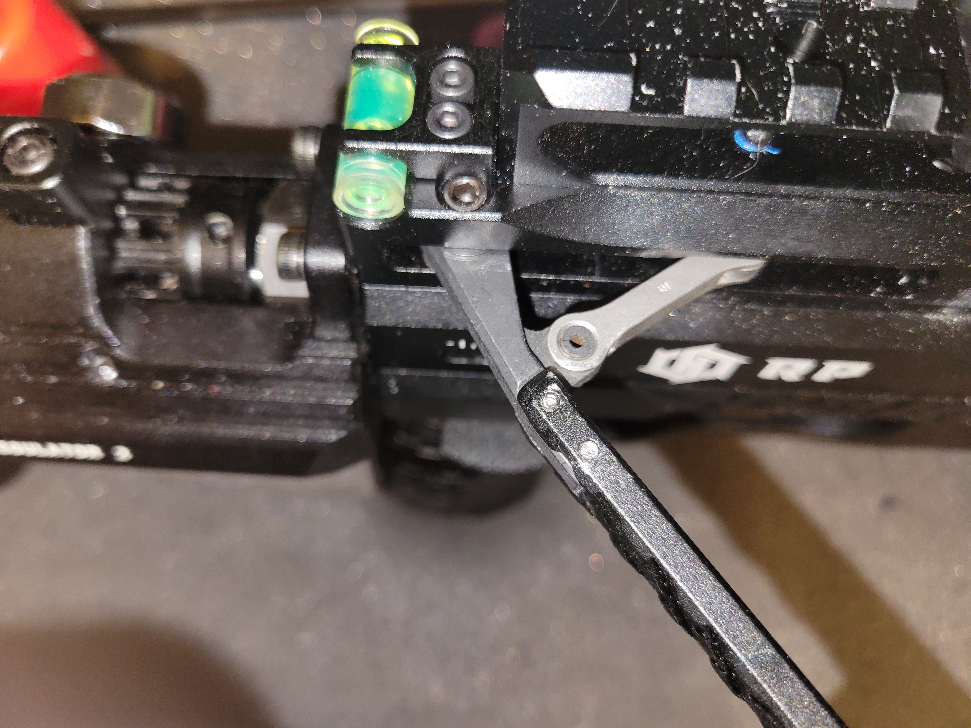

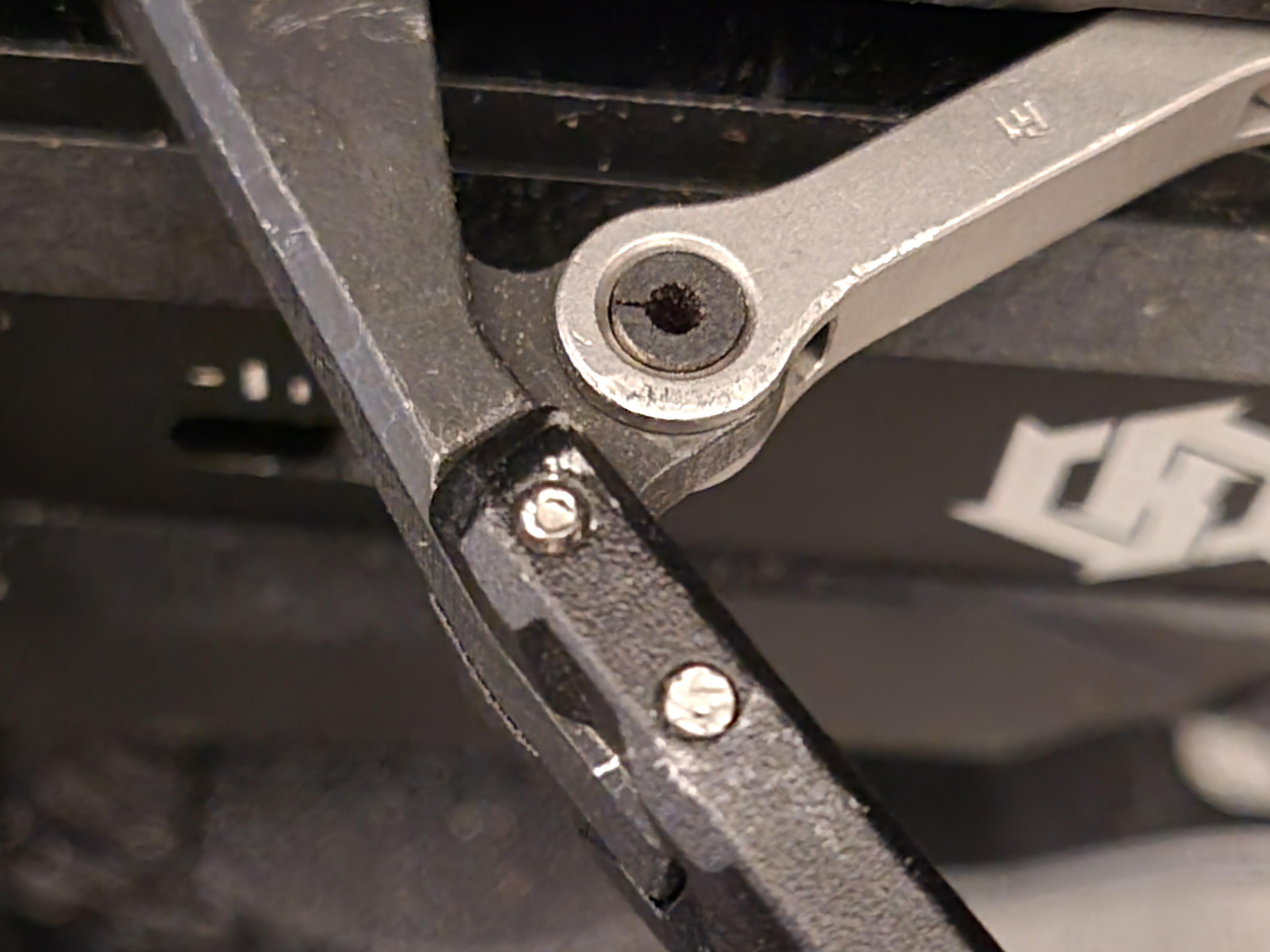

There are 2 "pins that connect the cocking lever to what if refer to as the "bolt". One or both of these pins may work themselves loose and fall out. This happen to me twice. See attached pics.
I hope this helps other RP shooters.
