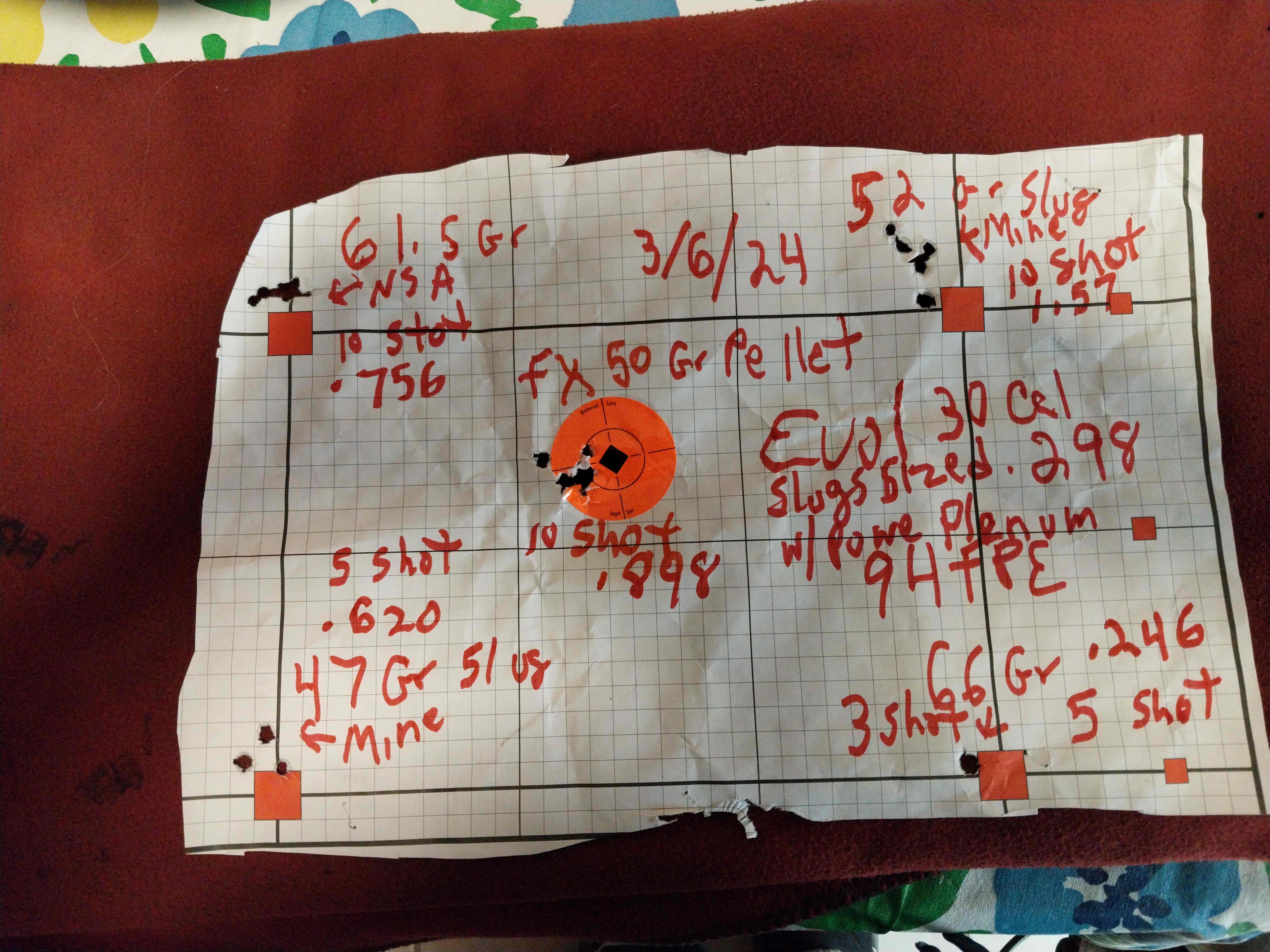

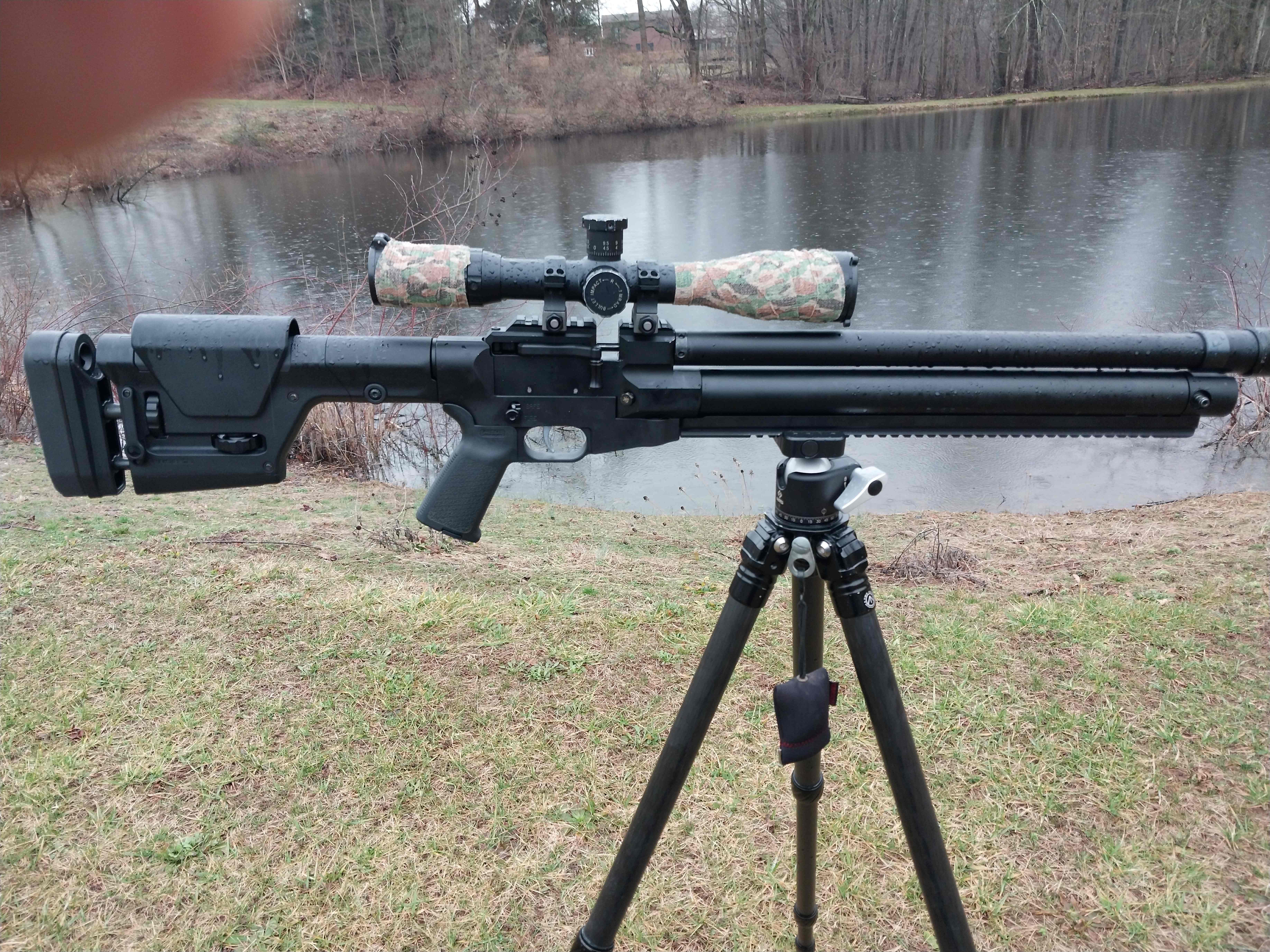

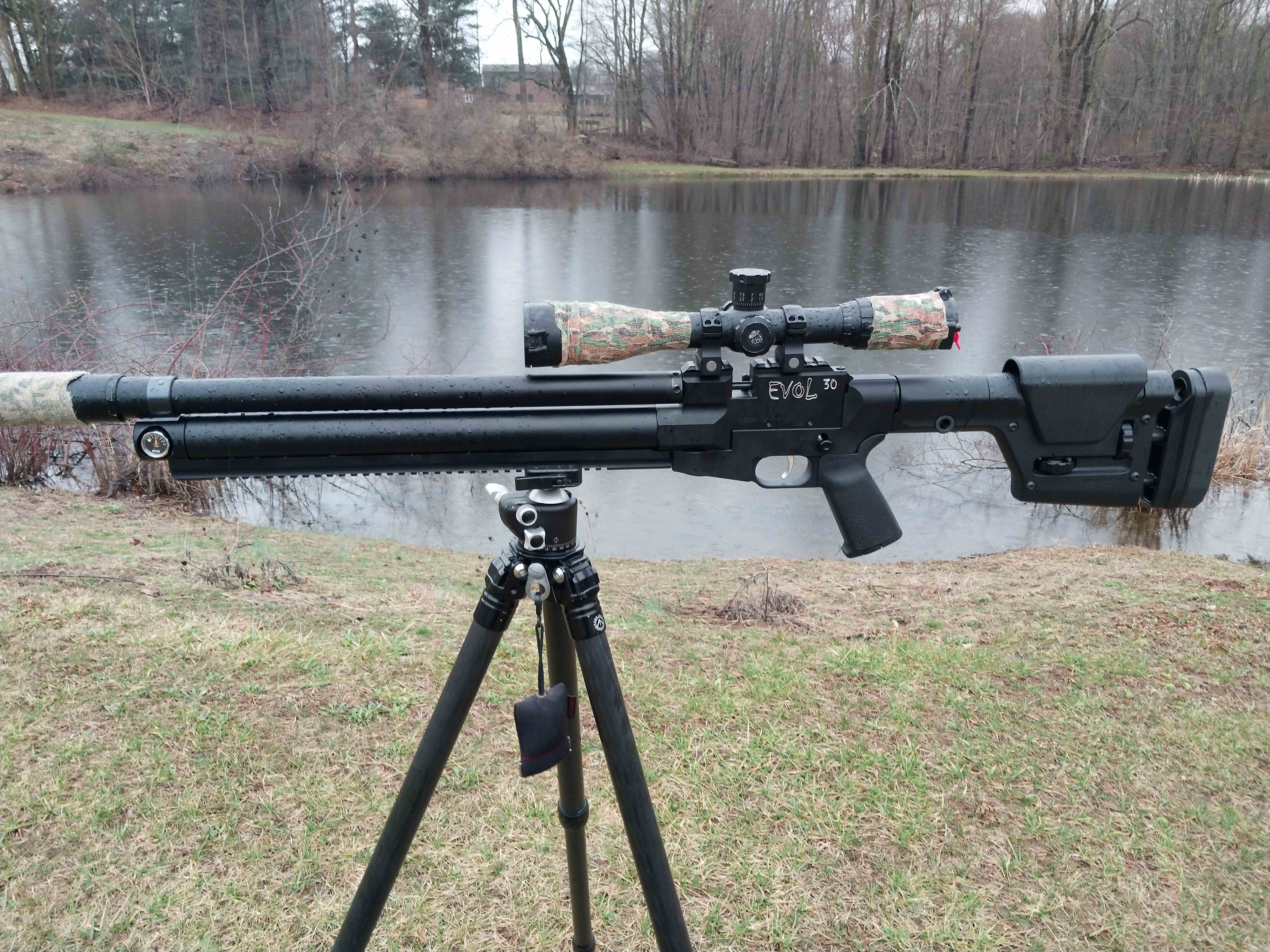

OK SO GOT OUT TODAY RAINY BUT LITTLE WIND , I PUT OUT TARGET AT 100 YARDS AND TRIED 47.5 GRAIN SLUGS , 50 GR PELLETS , 6.15 GRAIN SLUGS 66 GR S;UGS . I THREW ON A 3X15 SWFA SCOPE MIL WITH A SET OF NITEFORCE LIGHTWEIGHT RINGS , AND SHOT SOME GROUPS ALL SHOWN ARE 5 AND 10 SHOT GROUPS , TO MY AMAZEMENT EVERY GROUP BUT 1 WAS SUB MOA AND TIGHTEST GROUP WAS 1 HOLE TO BE HONEST IT WAS NOT MUCH LARGER THEN THE SLUG THIS IS FANTASTIC FOR THIS GUN ONLY OTHER THING I DID WAS WHEN BARREL WAS REMOVED I DID DELEAD IT AND GAVE IT A GOOD CLEANING .I CAN ALSO SAY OTHER THEN SIGHTING IN WICH WAS ON MEDAL TARGETS THE FIRST GROUP WAS THE LARGEST I BET IF I RESHOT IT SINCE NOW IT IS LIKE SEASONED AFTER CLEANING IT WOULD ALSO BE SUB MOA , NOW I CAN SAY PRIOR TO INSTALLING PLENUM AND CLEANING BARREL THE 50 GRAINERS WERE SPIRALING , NOW THEY SHOOTING STRAIGHT AS AN ARROW
HERE IS GROUPS AND HOW GUN WAS SET UP
