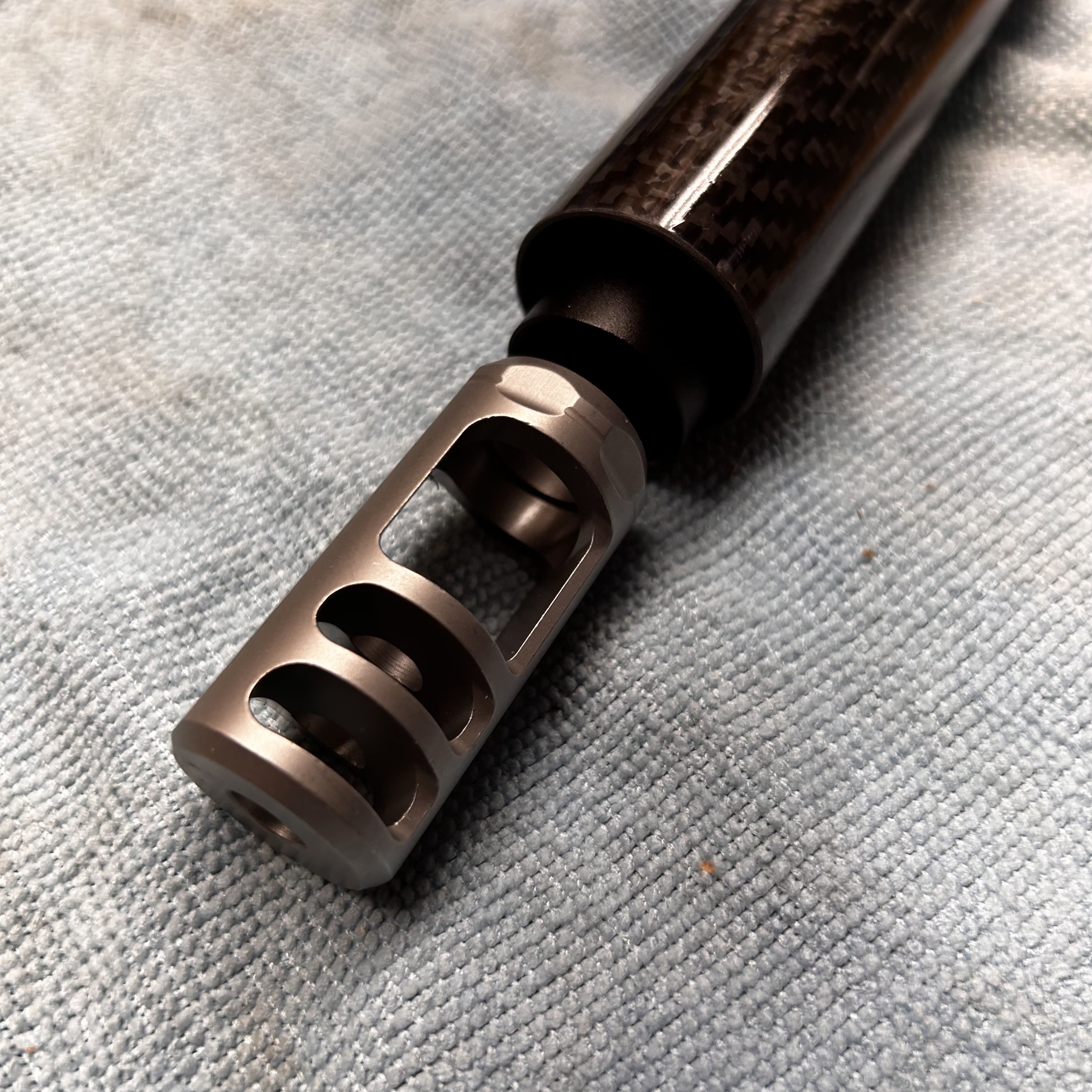

If looking for sound reduction, YES an "air stripper" will do it. The picture shown , meh. If you have say 6" empty space between the airstripper and shroud end NO need to add anything on the end , it is just something people like to do.

edit: second picture down show a decent air stripper used inside shroud

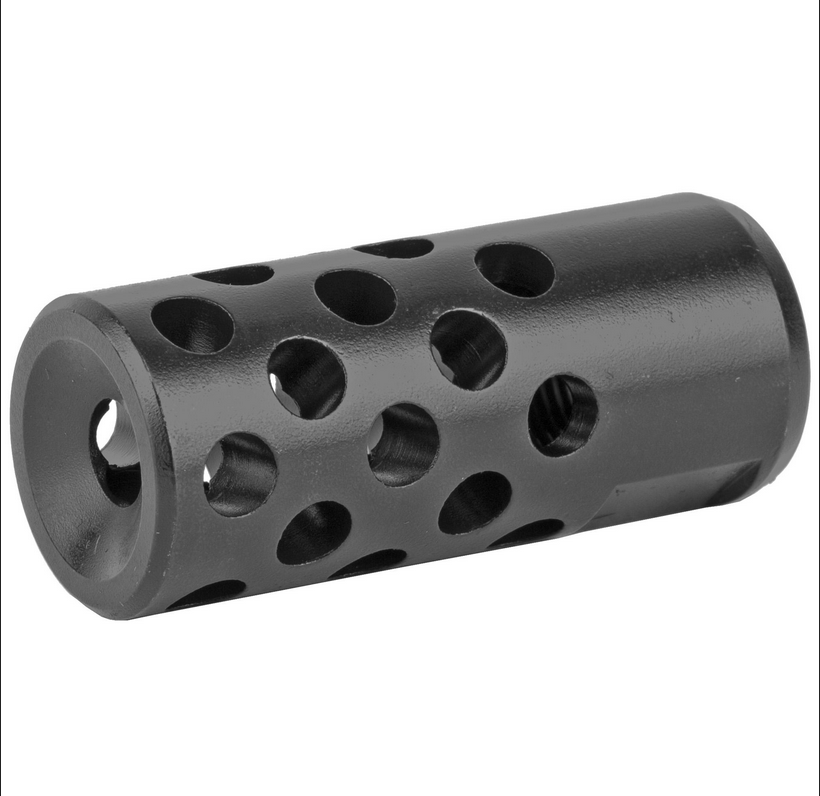

The "stripper" shown above is a Ruger 10/22 brake. The idea was to attach something similar (as shown here) to the RTI barrel..need to machine something similar or buy and re-thread. A larger CF shroud would encapsulate the original RTI shroud and stripper. The RTI P! has a 1" aluminum shroud for barrel centering. So the CF shroud (34mm OD x 32mm ID would be added and create a fairly large space for the stripped air to be re-directed. At least that's the hope..
