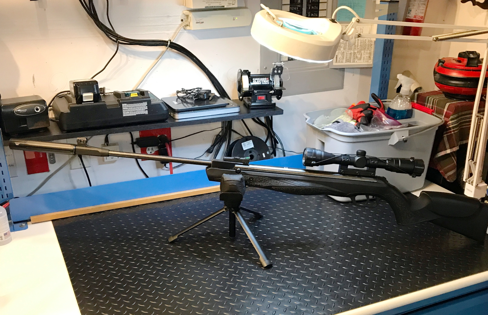

I have a couple of springers with moderators. I compared an older HW97 with long barrel and a new model with removable muzzle cap. On the new model I installed two rubber grommets to see if there was any change in sound when firing, but I couldn't tell and later removed them.
Recently I tried a screw on HW moderator with my HW98 and there isn't a noticeable difference even after a tune kit was installed.
I also have a couple of old Diana 45s. One has shortened barrel and Mac1 Gen 2 brake and the other has a stock barrel. Not much difference in report, but they're not shooting above 12 ft lbs. I plan to do some testing soon with noise measuring app and chrony.

anecdotal, but i got a -10dB and more consistent shot noise-level with a DonnyFL KOI on a Walther Parrus .177 magnum break-barrel.
