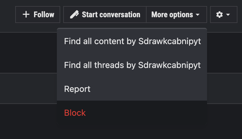

@Sdrawkcabnipyt & @Motorhead its ok that you two can't see eye on something, that's the brilliance of opinions. What isn't ok is publicly (or privately) breaking the sites rules by insults and inappropriate behavior. I suggest both of you go to each others profile, click on the more options button, then BLOCK each other.
Publicly (or privately) harassing each other is unacceptable and breaking this sites rules will result in warnings and/or termination of the account.

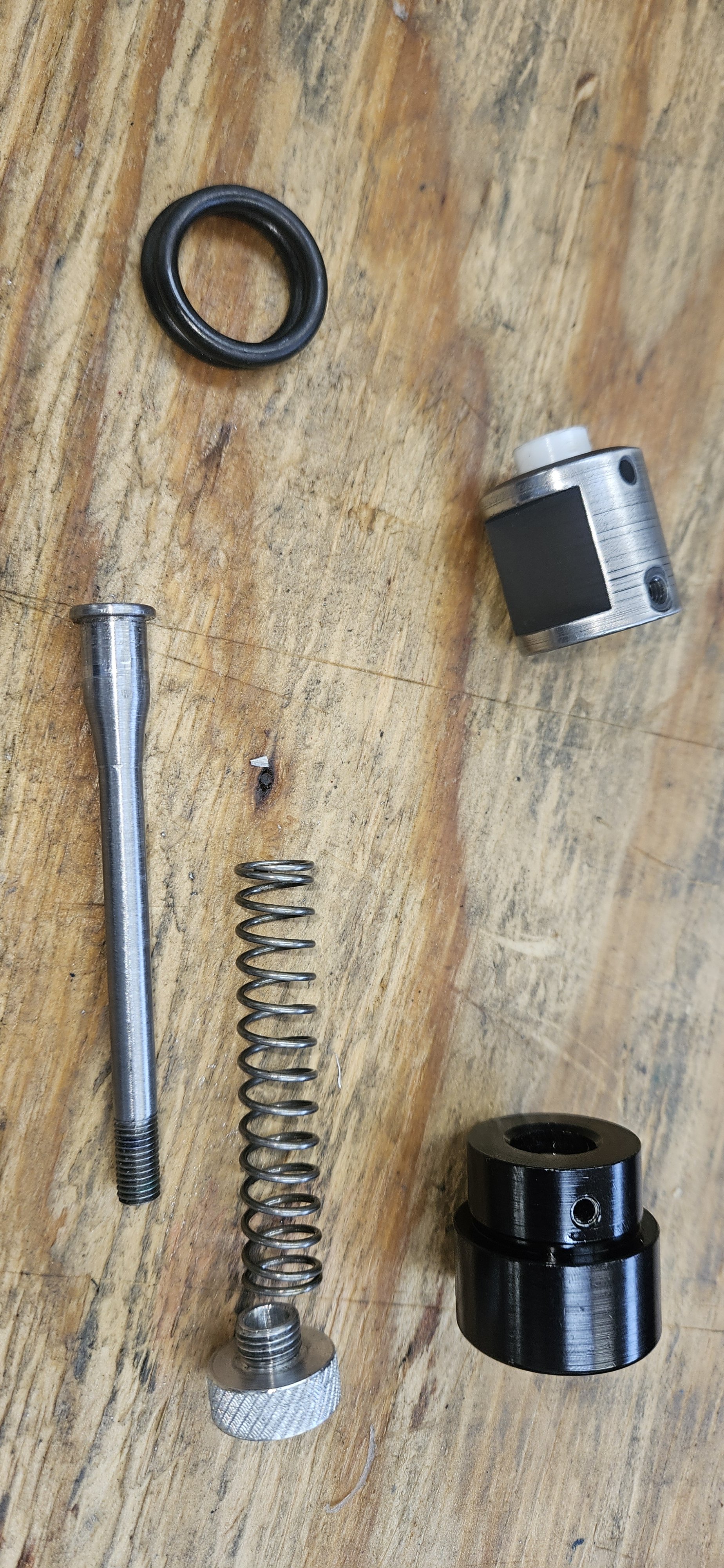

Here's what i'm trying.
I made a delrin cap to go over the hammer to maybe stop some metal on metal pinging.
Machined a 1/2" bar down to make a spring stop and will add some o-rings in front of the hammer as a stop to help with the bounce. My gun always make fart noises so I hope that helps.
I also polished the hammer because it is makes scratchy sounds when cocking.
