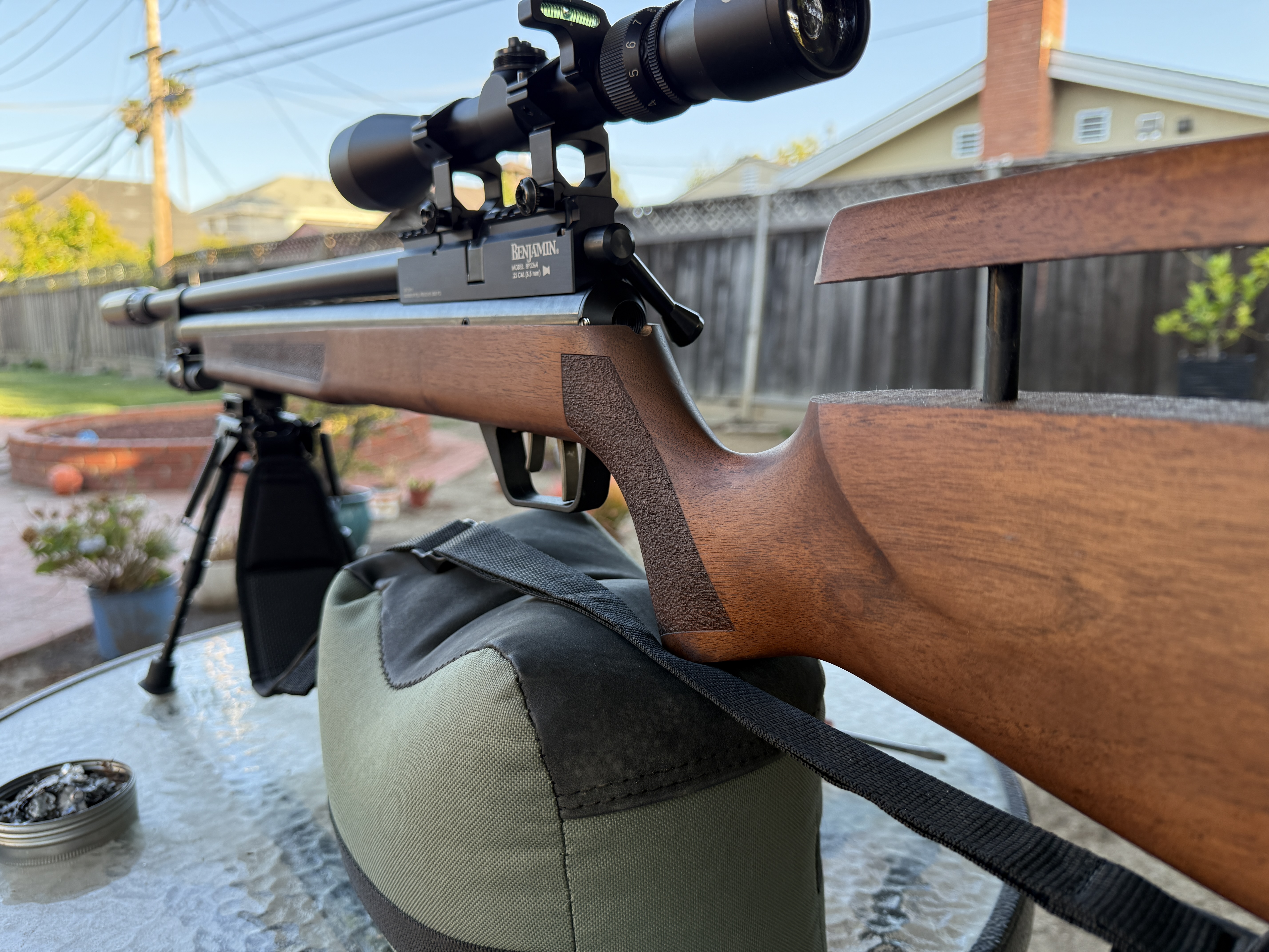

My goal was simple: create the quietest possible .22 Marauder that still produces over 12 FPE for ethical gopher kills out to 40 yards. In other words, it had to be “backyard friendly” without sacrificing performance.
I chose the Benjamin Marauder as an upgrade to the Daisy 880, mostly because of its reputation for being one of the quietest affordable PCPs on the market. So when I pulled the trigger for the first time, I was shocked. The shot was loud, mechanical, and absolutely not backyard friendly. My stomach dropped.
Now, after a series of upgrades and experiments, this rifle is whisper quiet—quieter than a stock Marauder, yet still delivering the same energy. Here’s how I got there.
Original Setup
  • Gun: Benjamin Marauder .22 cal with Lothar Walther Barrel (unregulated)
  • Pellets: JTS Dead Center 25.39 gr
Current Mods
  • Hill Regulated Parts Kit
  • Hill PEEK Striker
  • Hill Barrel Band
  • JSAR Twin Spring System (TSS) + Stopping Spring Guide (SSG)
  • Huma XXL Regulator
  • DonnyFL Sumo Moderator
  • Eagle Vision Harmonic Barrel Tuner with Air Stripper

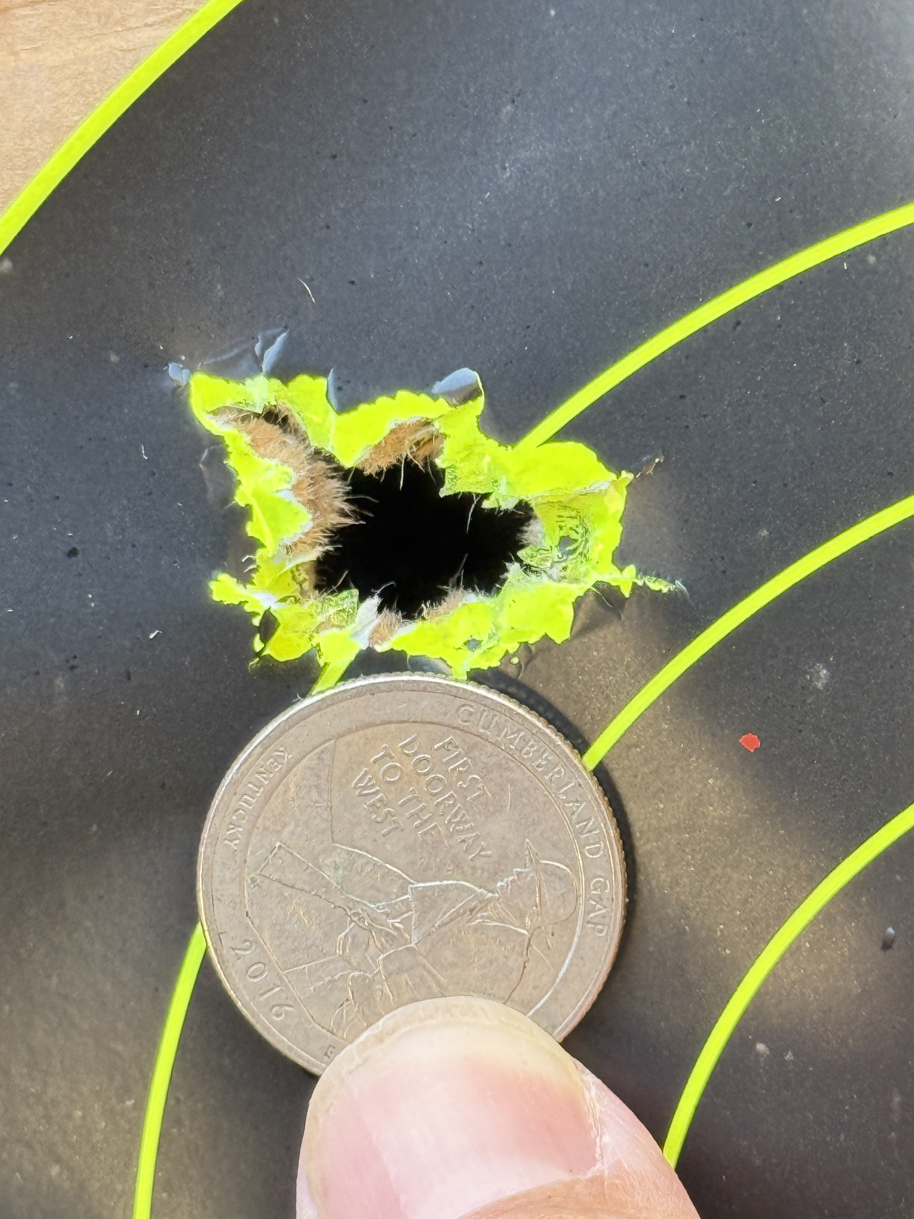

  • Accuracy: Sub-10 ES, reliable grouping at 40 yards

Accuracy is excellent. My 10-shot group at 40 yards honestly could’ve been tighter despite how good it was, but I’m still using a $25 CVLife scope from Amazon. Parallax is a mess, so that’s next on the list.
