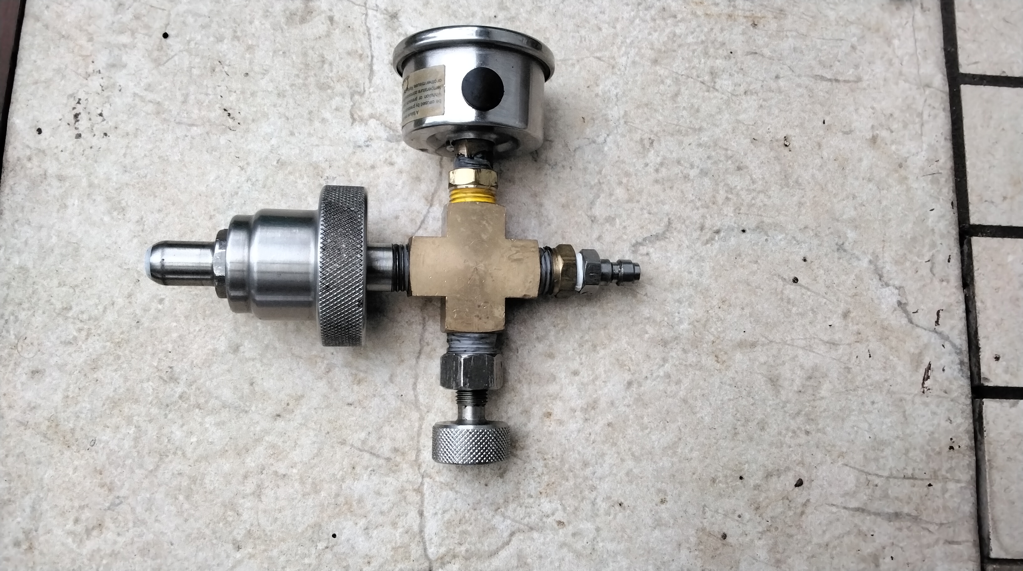

They make 4-way fittings, 3 incoming from your compressors, one for the outgoing fill line. Like this one for my tank fill adapter. Maybe one in stainless steel.

Just put fill nipples with check valves on all 3 inputs of the fill block. Temperature at tank should not be an issue as there are compressors that fill faster. Each compressor is filling a tank 1/3 the size it would normally be filling. So long as that's a reasonable size for the compressor you should be good. Biggest issue with the little compressors is moisture collection, they use very small cyclonic collectors. When I fill a large tank with the Omega version of the CS4 it collects more moisture than it can handle and it starts going to the tank. Installing a large cyclonic moisture collector. You can put one after your fill block and before the tank. It's an extra 1/2 L of volume to fill but worth the peace of mind.
