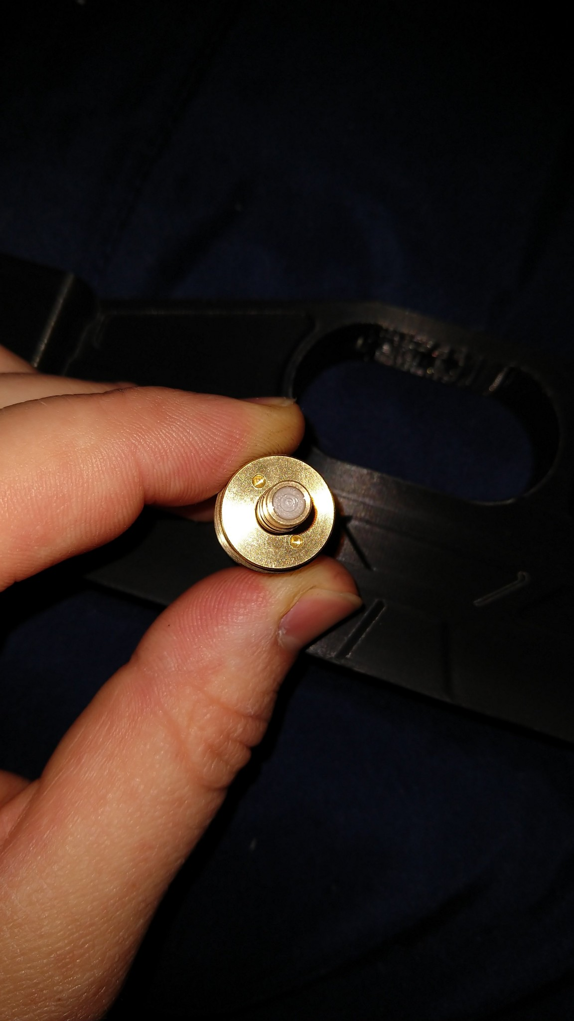

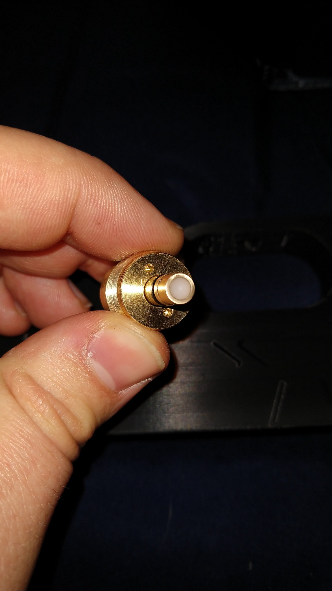

There are things you can do to it to help settle it like degas, punch out the pin that is in the block over the reg screw and unthread the screw out and you'll see the delrin? material on the end. You can lay some 2,000 grit or more sandpaper on glass and flatten that seat flush to make it more consistent in pressure. However since yours is new and you're also new to airguns and PCP idk if I'd recommend that yet.
Before
After sanding

but again I don't think you should be taking it apart since it is under warranty.
