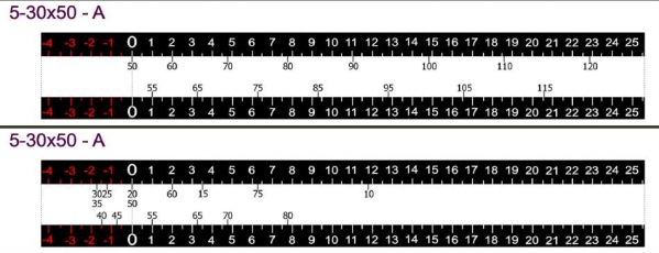

I just got the 5-30x50 and put it on my Impact, & made a video of how I finished the tape with Photoshop.

In that video I made one tape, starting at 40 yards.
But another idea I had was to generate 2 tapes- one starting at 10 yards and one at 50, and superimposed them over each other to make one. (starting at 50 yards it reads up to 120, and @ 10 yards it only reads up to 80)
I set the font at 25 so they don't bleed over each other.
So I generated 2 separate tapes:
The ones below were actually on top of each other. I took turns at 50% opacity so I could see through them and kinda chopped them up, selecting parts and hitting delete:
And finished with this:

Yeah I'm geeking out here for sure but it's fun. It came with 2 turret inserts. So I made 2 tapes, one for each barrel on my Impact. But yeah I've written on them too. I'm surprised how accurate it is though!

Take a look at the first picture in the thread. As you can see, he printed a tape that has distance markers on top, and on the bottom. The reason many do that is, so they can increase the font in order to see the numbers better. But of course you do not have to do that.
You could print one caliber/power setting on the bottom, and the other caliber/power setting on the top. Of course it all depends on if you can fit the numbers next to each other.

You've gotta play around with it man.
With their software no, you can't print two settings on one tape. But with something like Photoshop you can, print and lay them over each other & tweak and edit.
This aluminum MOA collar came glued on one of the inserts, the one in the scope, and I pulled it off.
I have separate tapes for my .25 and .30 barrels, but it's tricky lining them up correctly when I insert them. Not only is it challenging to lock the turret and hope I glued it right to slip in line with the gears, I also thought if they were both zeroed at 50 I'll just swap them out at that yardage. Ha ha but they are different power settings!
I'm still playing around with the whole process. So far, swapping @ 15 yards, the .25 caliber's windage is 10+ clicks to the right compared to the .30's. The elevation is off as well... I have this illusion that I'm gonna get it down to the point where when I look out my screen door, whether I see a pig or a pheasant, I'll be able to load and dial within 60 seconds. I'll let you know how that works out.
As far as putting 2 settings on one tape- interestingly the lower yardages are very close, and might not be too difficult to add in there or memorize. Maybe I'll color code them- The .25's 20yd mark is grey, with a grey hashmark next to it for the .30?
The higher yardages might have plenty of room between them to add in multiple points.
.30 on the top (860fps) / .25 on the bottom (830fps)
