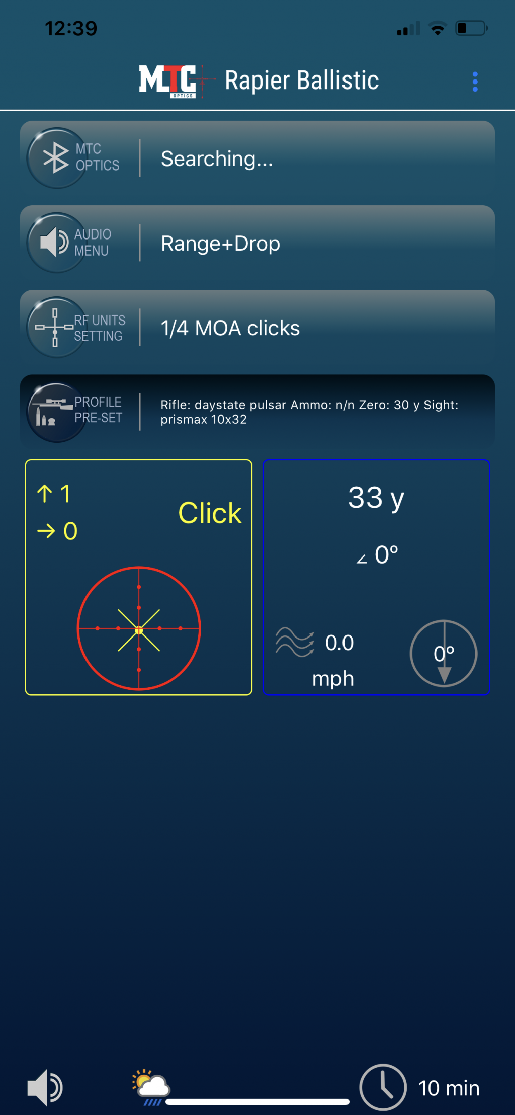

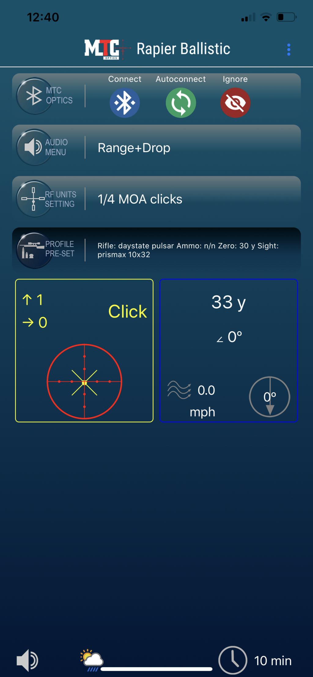

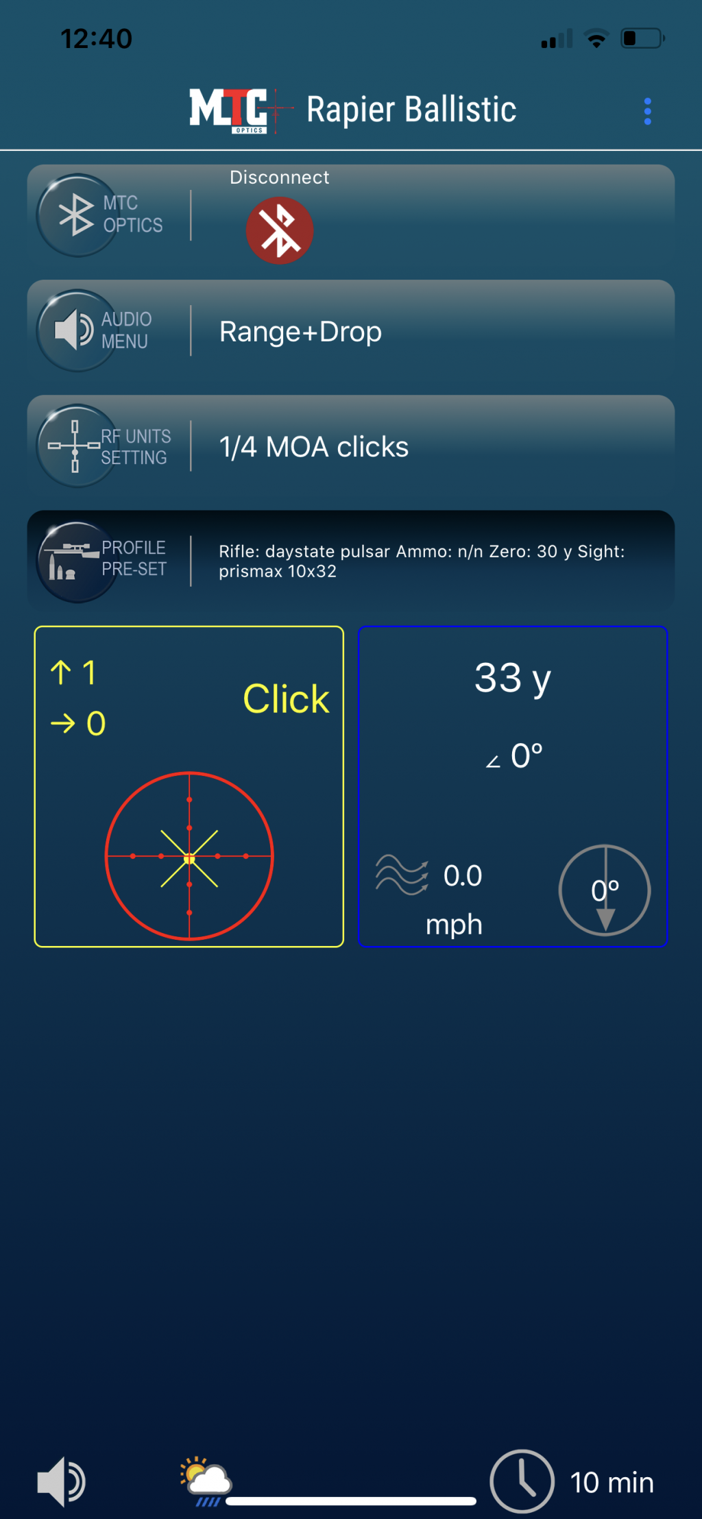

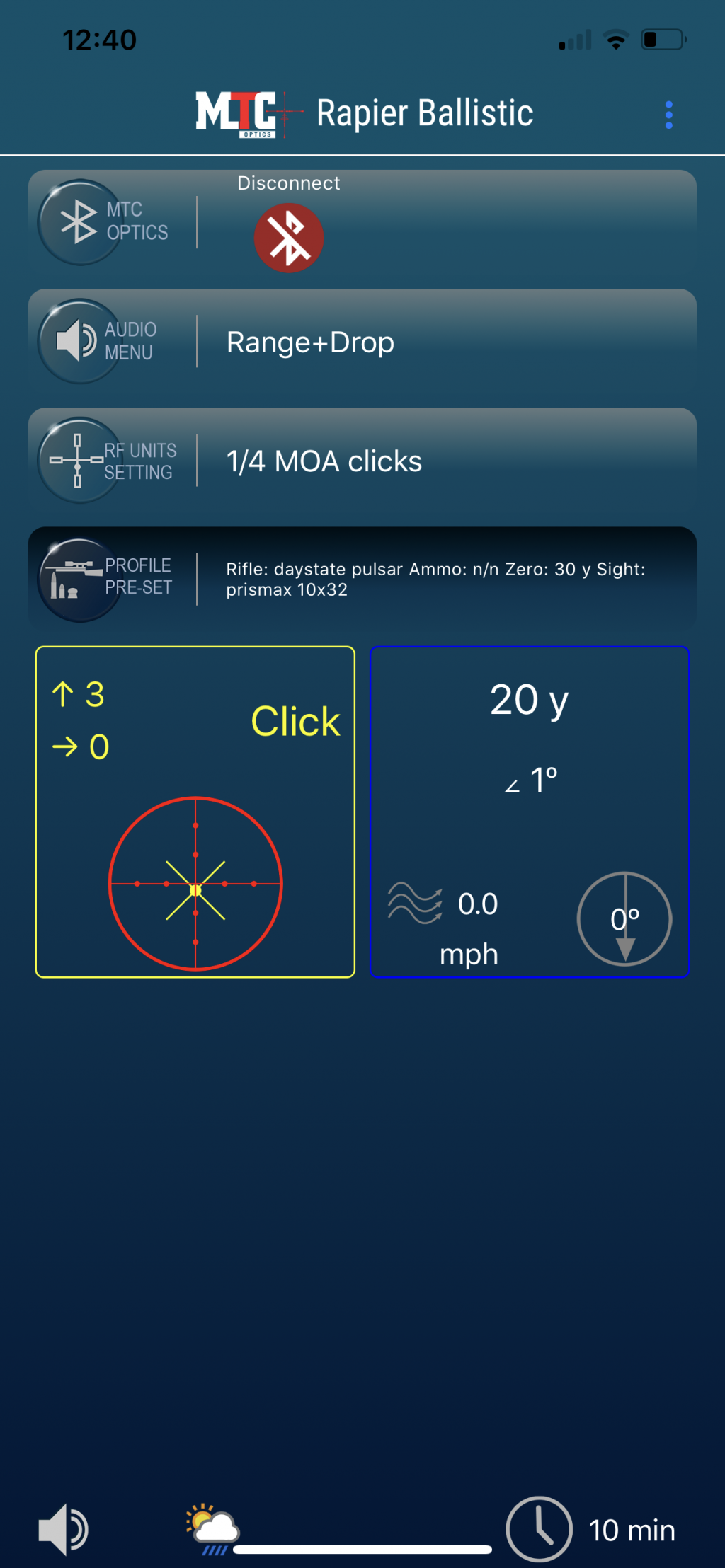

These are pictures I've just taken to illustrates how it works on mine (pictures are in reversed order)
1) start the application
2) switch on RF monocular, making sure that the BLE is ON (mode button on the rangefinder)
3) on the app you will see 3 buttons appearing - press "connect" and the icon becomes red (you are connected)
4) measure distance and it all automatically displayed on the screen and vocalized via eyepiece (RF monocular measured 20 y)
