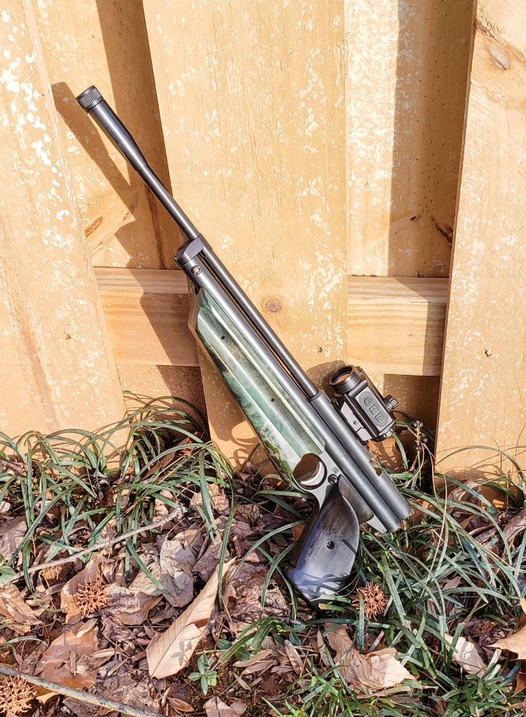

Steer clear of anything MTC. That's the general consensus. I have the MTC scope you speak of, and it's ok. But I do have some complaints. Max zoom is useless. The picture gets really washed out at high mag and dim. And having such a wide FOV, I acutally pick up glare off of my barrel, even on a very short gun. on much over 7x IIRC. Otherwise it's a unique piece. Eye relief does not exist. Your face goes literally on the scope. This can be an advantage, and can add an additional point of contact/stability when shooting off-hand. Good for very light/compact guns. See I mounted a torch on the pp800 as it's useless in low light, lol.

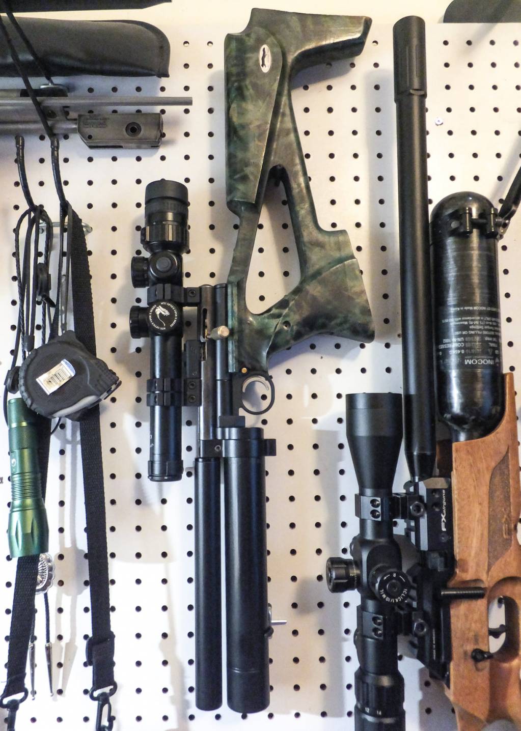

@Long_Gun_Dallas Well then that settles it. The MTC is not for me. I don’t want to put my eye directly on a scope. I get enough of that with night hunting gear. Thank you for your input. And the max magnification is no good? By the way, which Artemis model is the black gun hanging up? I can’t read the writing on the breech clearly.
@Long_Gun_Dallas That 1332 is a looker and looks like it can hit pretty hard. Nice looking amount of volume on that air tube.
It turned out pretty good, and I was lucky to get the parts.
27fpe out of a LW 7.6" barrel in .22 cal !!
airtube is 165cc, also have a 210cc tube for it

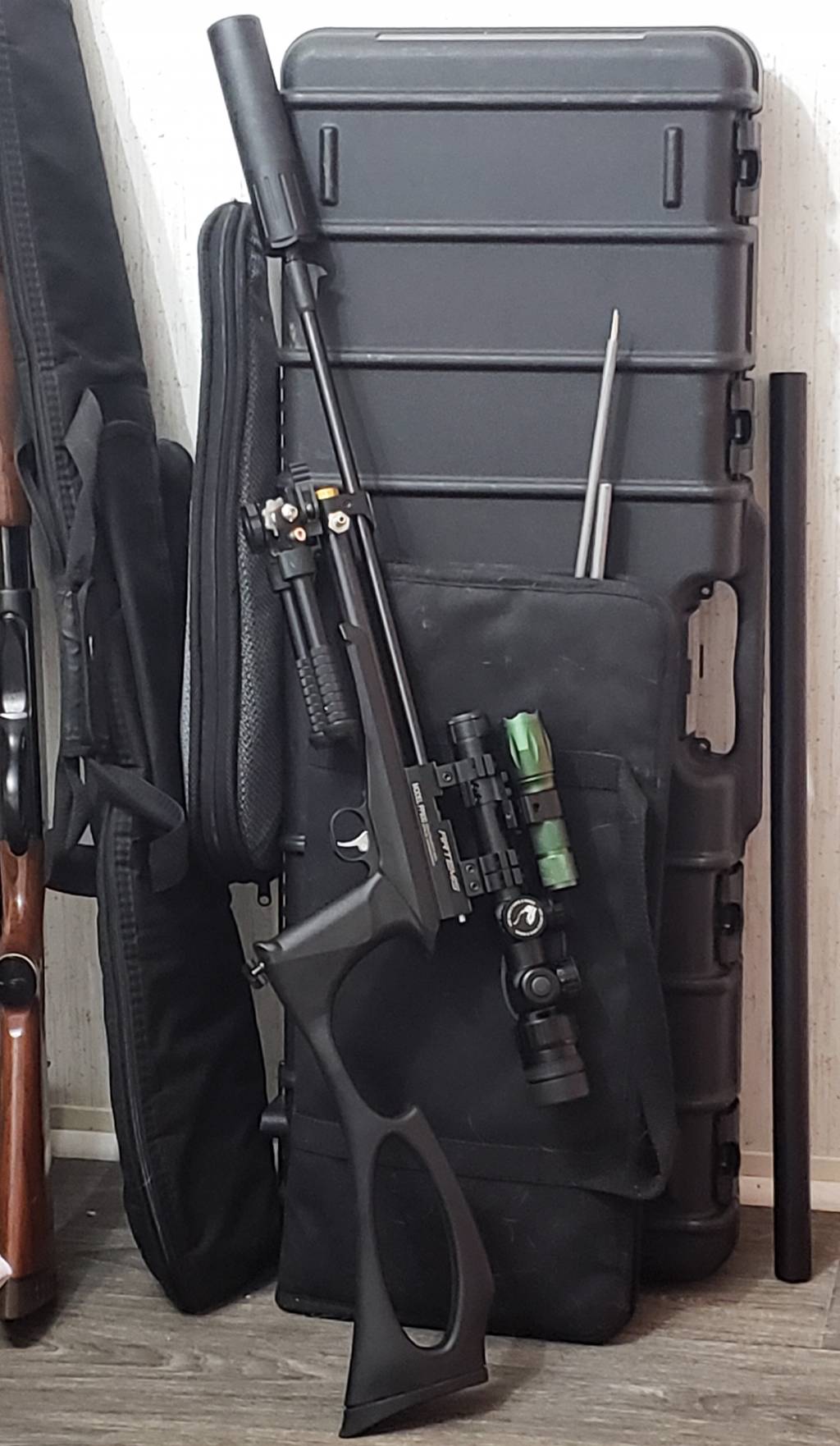

Green stock actually belongs on my pumper, lol. Recently got another full stock for this gun. Was intended to be a pistol, but I go back and forth with most of my guns. As you can see, lol.
@Long_Gun_Dallas I like how you convert the pistols to carbine. Seeing you do that changed my perspective on air pistols. 27 fpe from a .22 pistol will put down many types of animals. Which pellet do you use to deliver that sort of power? What sort of range do you get on it before accuracy is compromised? Were you satisfied with running an MTC rifle scope on your carbine pistol? Or did it not remain on there long?
All of my pistols are like this, lol. Always good to have options. 3/5 are pistol format right now, but all can be converted. I was using JSB 18.13gr @820fps. I havn't pushed the range on it, so I honestly don't know. But I do have a regulator for it as well. The barrel on it has been cut and re-choked specifically for AA 16gr pellets, and it likes those best, but will shoot most everything quite well. I changed back to a 1.75-10x scope as I can get more useable zoom, and the stock on it already offers a ton of support by means of cheek weld. But the gun does spend most of it's time as a pistol. I can nail the top edges of soda cans out at 35 yards with the pistol like clockwork. (short airtube is regulated to 11fpe, super quiet, over 100 shots)

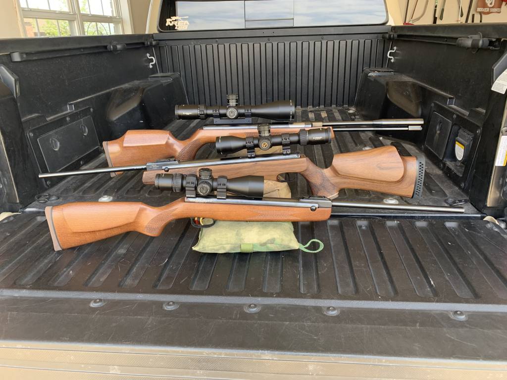

I have a Vector Veyron 3-12 and a USO 3-12. They’re basically the same scope other than a few different specs. I know you’re looking at the 4-16 but as far as eye relief they’re all the same. They all have a really short eye relief and if you’re running a full size stock you’ll have to have your mount back quite a bit.
Here’s a pic of my R7/HW30 which the stock is pretty compact and you can see how far back I have to have the mount.
