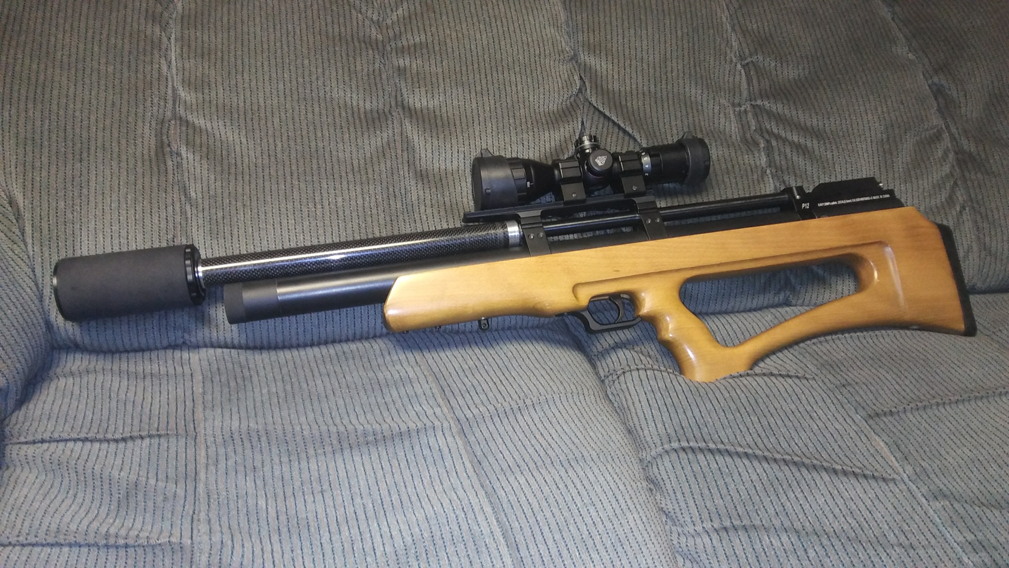

Mrodair P12 .22 cal beast

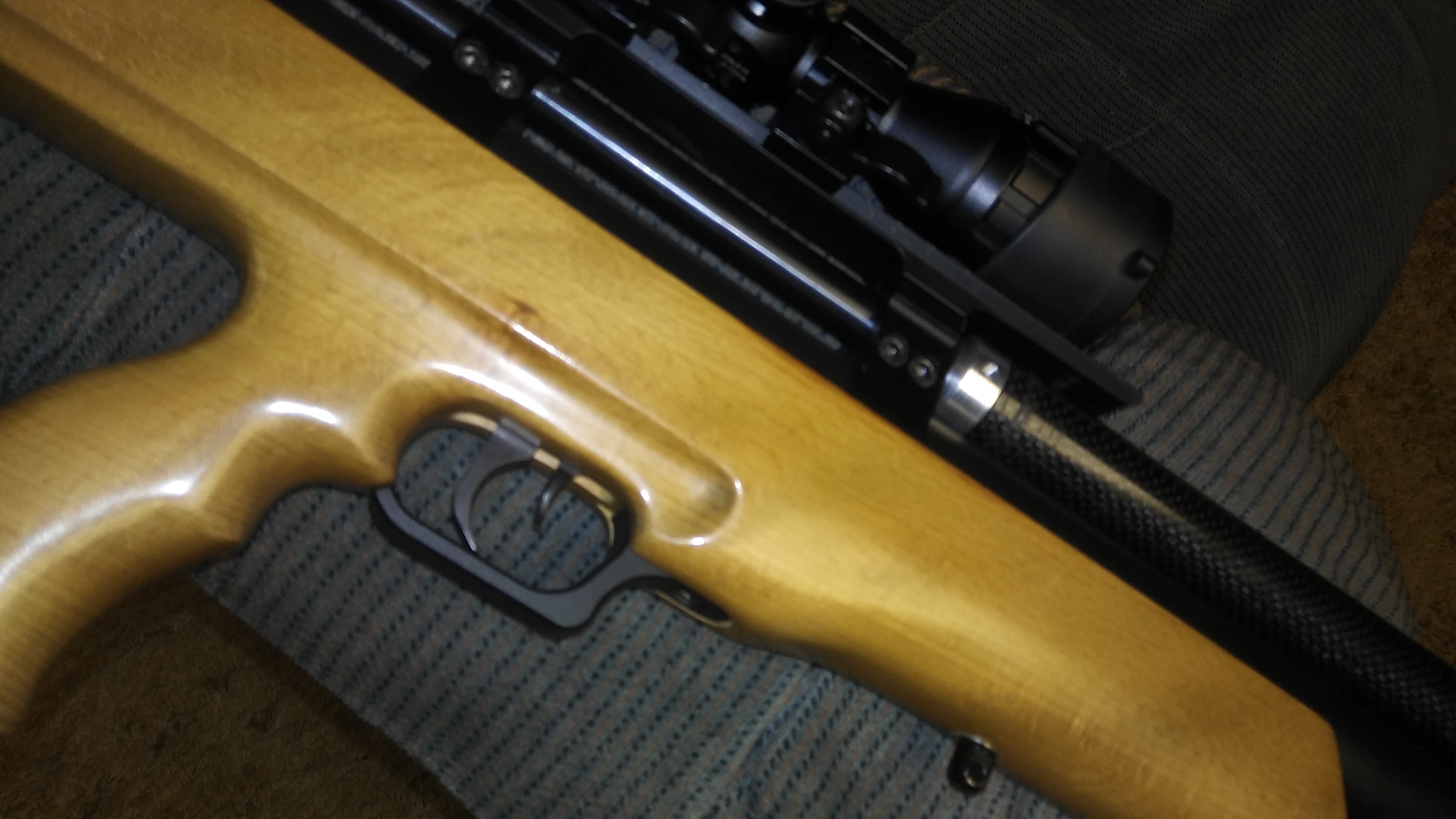

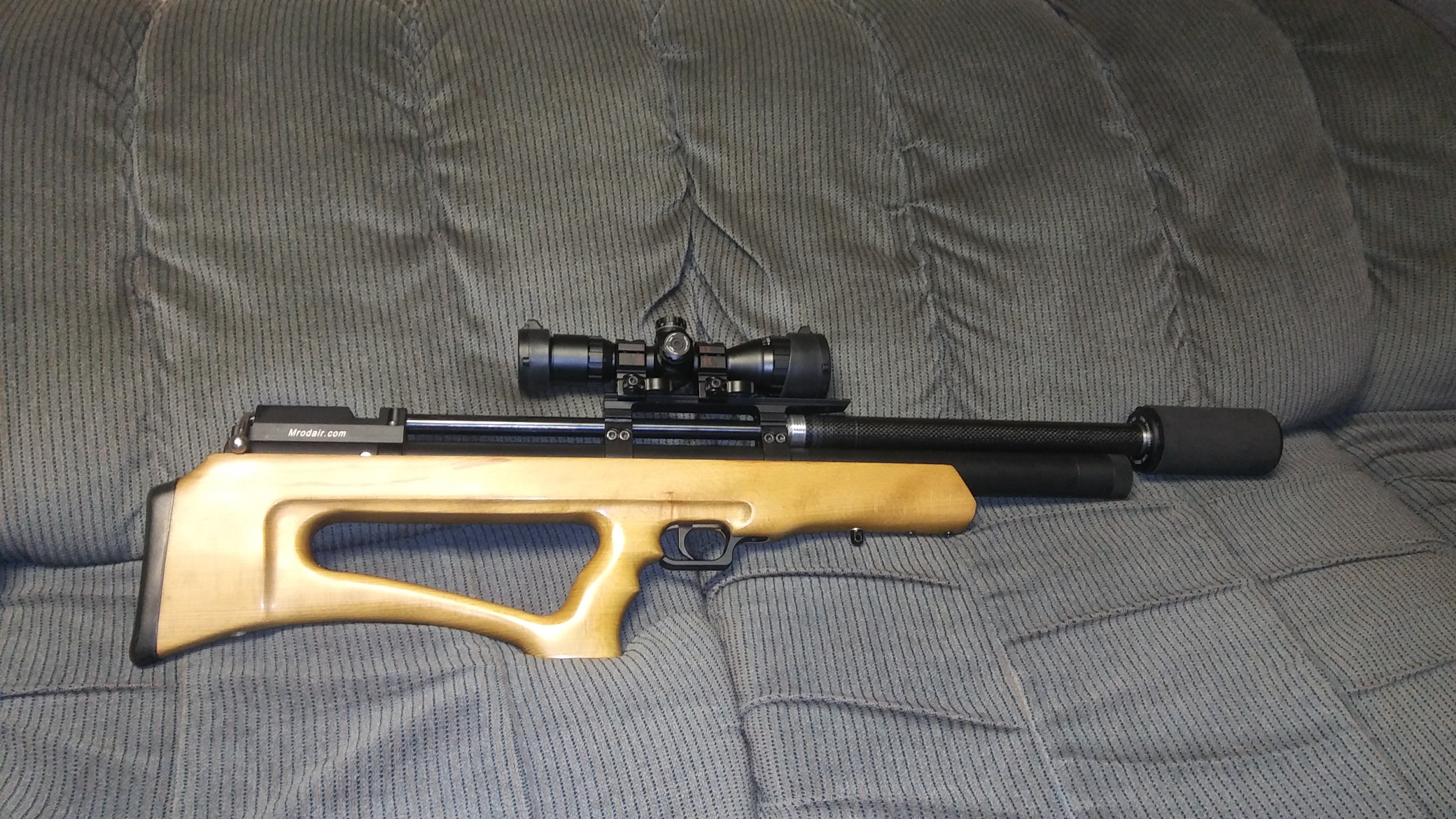

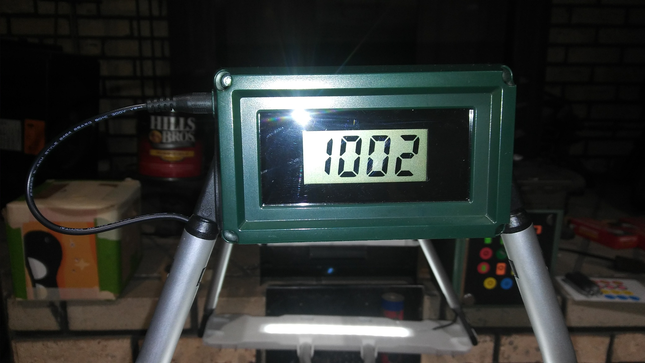

Picked this up recently, it needed a little love. Shroud was made with internal threads 1/2x20, barrel was 12mm. I turned the threads off the barrel and made up a short section of the correct thread and bonded it to the barrel. The rear bushing on the shroud had to be sleeved so wasn't flopping around on the barrel. Got the trigger adjusted to work really well. Sure wish it came with the parts for the safety. Stripped it down, clean and lubed. Who knows where the hammer spring came from. Tried what I had on hand, found one that worked quite well. Still a little hammer bounce so I made up a SSG. Installed a middle of the road spring, adjusted everything for about .100 free flight. Just about pooped my pants when I shot some 18.1s over the crony, 990 to 1002 Grabbed some 25.4s and they were 890 to 900 I was pretty much being conservative with my set up. This thing has the potential to make some serious power.
If you guys have any info on this gun to share send it my way. Suggestions for tuning, parts availability (i really want a safety) and the such. Any idea of the thread size on the gauge?
Still don't know if I like the blond stock. Hydro dip maybe, sand and stain. I dont know, what are your thoughts.

H&N Baracuda @ 1002fps into 3 & 1/2" modeling clay at room temp. Pellet hit the steel backstop.
