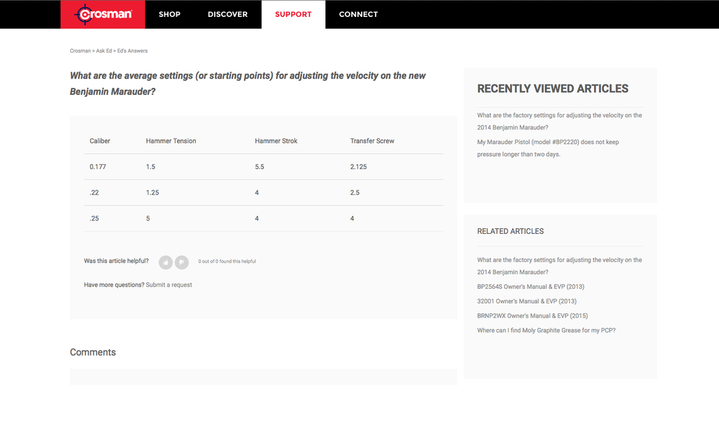

I ordered some parts from Crosman today. While I had them on the phone, I asked if there were general or starting settings for the hammer spring and hammer stroke for the marauder pistol - incase the settings had been moved. The rep told me the recommended settings and also sent me an email. Here is a partial screen shot of the email that shows the settings:
I agree that the hammer spring and hammer throw settings should be recorded prior to making any adjustments, incase one would need to go back to them.
Anyway, incase someone needs a new starting point, this is what the manufacture recommends.

Any chance you still have that data from this 8 year old post lol? I've had my P-rod since 2016 and have shot it completely factory stock since then. I've been doing some research on a simple tune that I could follow. I haven't even checked mine yet but would like to write down what Benjamin claims should be the factory setting.
