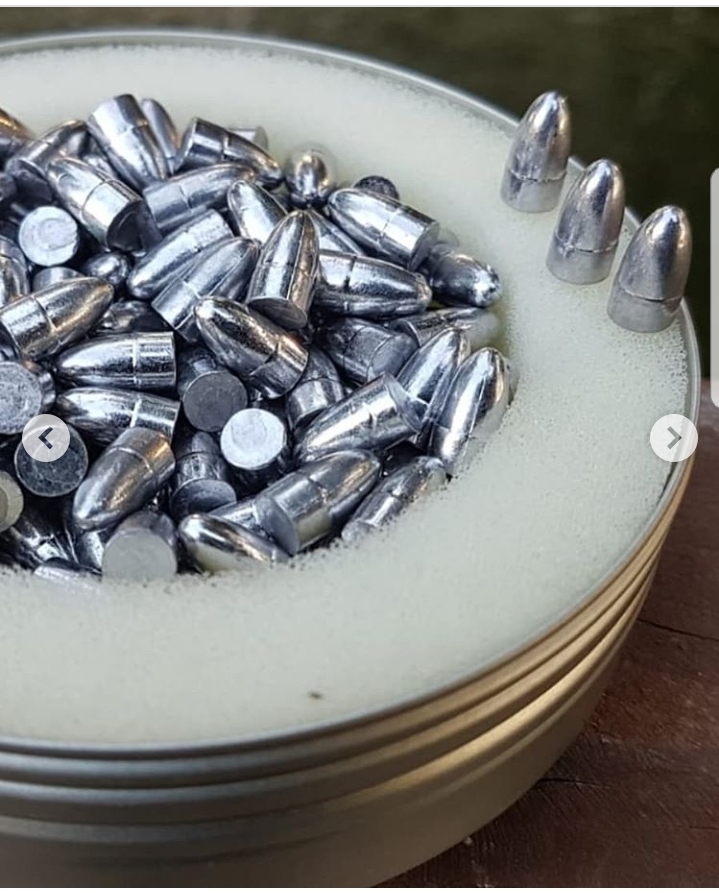

Hi guys just wondered if anyone on the forum has tested the .22 MP 5.52 molds and what the accuracy is like. So if anyone has indeed purchased these could you let me know what the ballistic characteristics is like along with how accurate are they. Here is an image of the mold

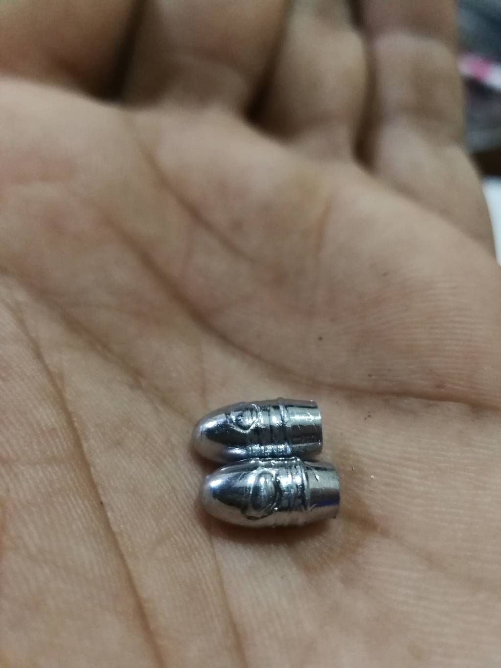

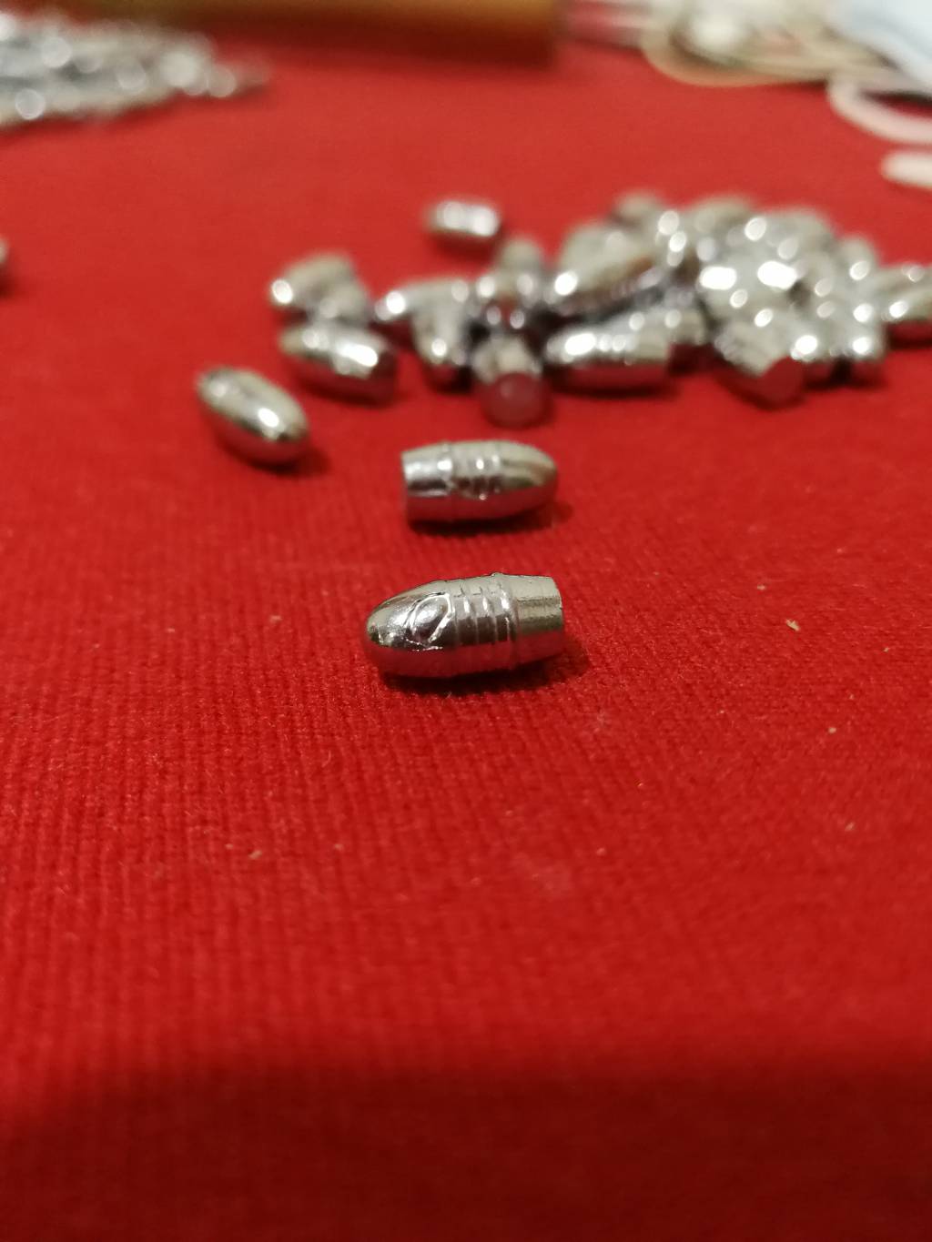

I'm a caster. Both pellets and slugs for .25 cal. My lead temp is 800°F and I run my brass NOE molds about 340+ °F. How are you filling your mold when you pour? Are you using a bottom pour casting pot or by ladel? You must make sure that the lead goes into the sprue hole as close to center as possible. Or you will get uneven pours and the unfilled circles you are seeing. I haven't used an mp mold. But I know it is aluminum. They loose heat quickly so your casting tempo needs to be quick and steady to keep the heat in the mold. Temperature is the major factor. Try tuning up the temps by 20-25°F until you get good fill out and the circle defects to away. Oh and I also only use pure.lead with no tin.
Reactions: Bandito
Ladle pouring is ok. You need to have a thermometer in the lead son that you know what temp it is at. I started off this was myself. now when you say ladle do you mean an open style or the one with the little spout on the side of it? The one with a spout on the side will work better as it gives the mold a small amount of head pressure to get the cavity to fill out.
just keep trying. You'll get it then it will be an ahhha moment. Keeping good rhythm and don't check for defects in between each mold drop. Just do a bunch then weed out the rough ones at the end of the session.
I am very thankful for you suggestions really appreciate it. It gave me a hope that I could get the goal. I mean the open style pouring with a mug I have with a little bit bigger spout on the side to pour, I will try to get a small pouring ladle which you are suggesting till I get a bottom pouring pot. Can you please give me some more informations about the mixture or the lead, I mean tin how much to add with the lead. And also please tell me the soldering lead which have 60% tin is good to mix with lead because in my country I don't know how to find tin. Looking forward to get some more information about molding because I am new in this field it's my first time to mold.
