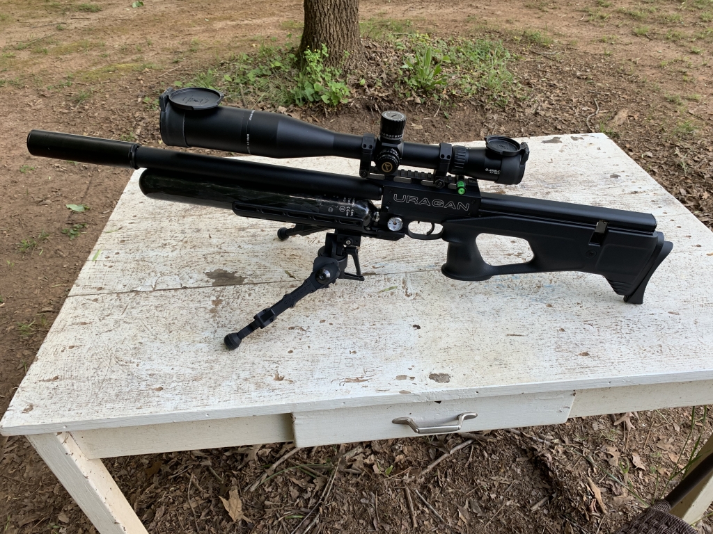

The package came in and I ran outside (didn't really care that it was a windy day) and had to get some shots in before the rain came. Got the scope mounted and sighted in, wind was howling and it was immediate how much the wind moves a 22 more than a 30 at even 50 yards, so I put it aside and grabbed my other new rifle (another story for another day) and sighted it in. The wind started to die down, so I went back to the Uragan. All 5 of the 5-shot groups I quickly took were inside of 0.5" with one being 0.175 and two more under 0.25. That was the first day sitting down with the rifle trying to hurry before the rain came! I think I am going to be extremely happy with this rifle. I was starting to shoot a lot at 100 yards with my Impact before the trade, and while I think the 18gr pellets are at a disadvantage, I can't wait to see what it can do out to 100yds. Affordable office movers near me

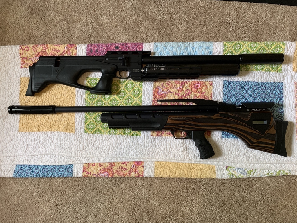

The second rifle obviously isn’t the Impact and I’ll review it later when I get a real scope.
