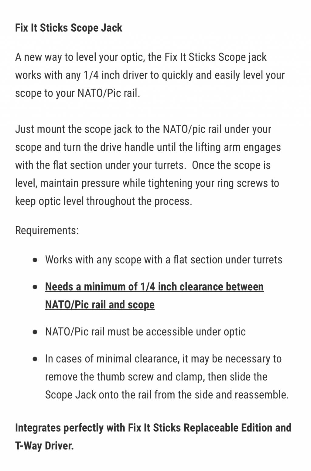

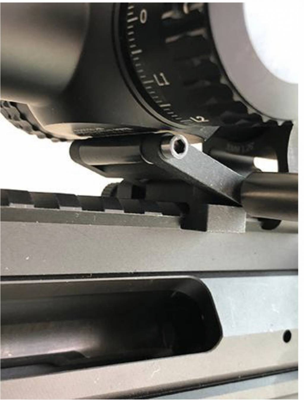

I like the wheeler scope set it is what I use but lately I just like this scope jack by fix-it-sticks it's so easy and fast check this out on the website. It goes on your picatinny rail and lifts up to the base of the scope and levels it perfect

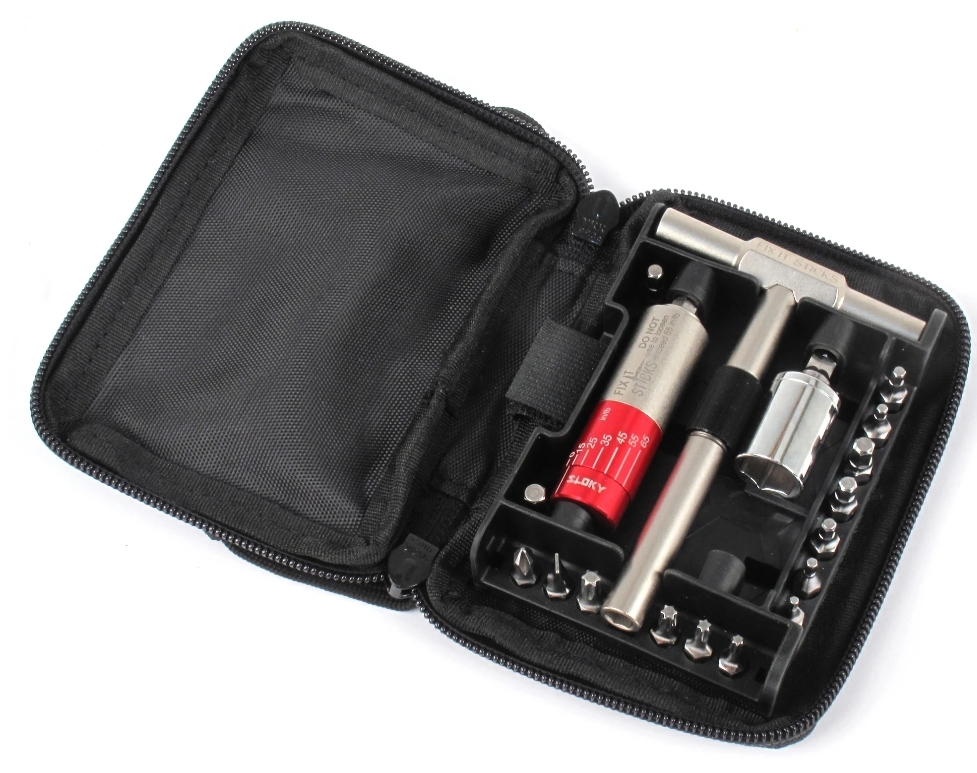

I like the Wheeler system, but I also like the 'wedge' system - for the latter I use a machinist's adjustable parallel, which is substantially more accurate (not that it's really necessary). The adjustable parallel will not work if the scope erector tube is too close to the mount or rail (whatever is directly below it). I had not seen the Fix-It sticks scope jack - that's intriguing, but I have had some quality issues with Fix-It sticks (I might have just been unlucky) I do keep their torque limiters in my shooting kit. The mirror trick works great for scopes that focus super close. If yours doesn't, you can "trick" the parallax adjustment by cutting a hole (start small) in the center of a lens cap and putting it on the scopes objective, temporarily reducing the scopes parallax distance (and light gathering).
