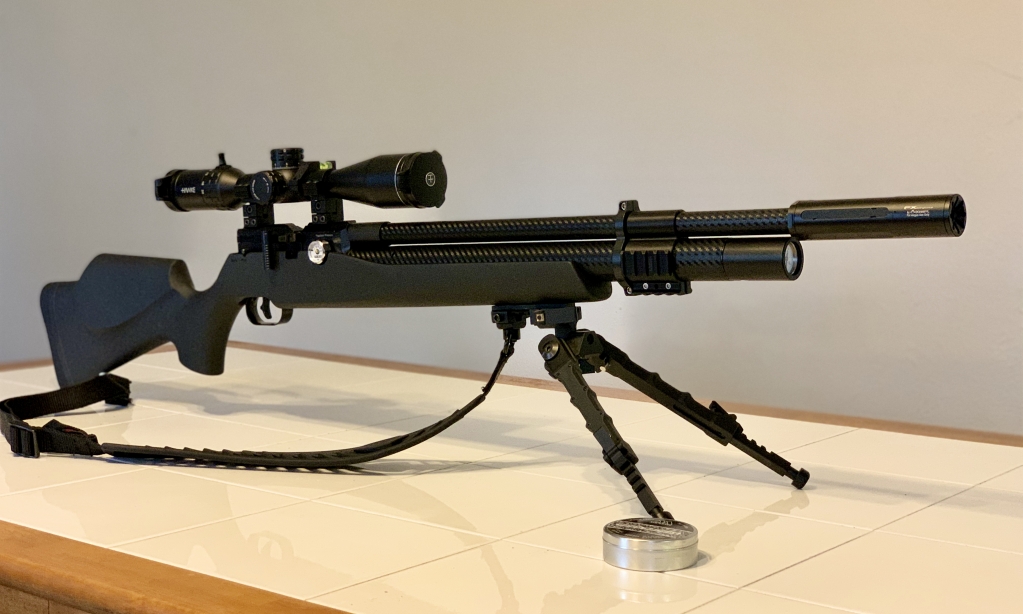

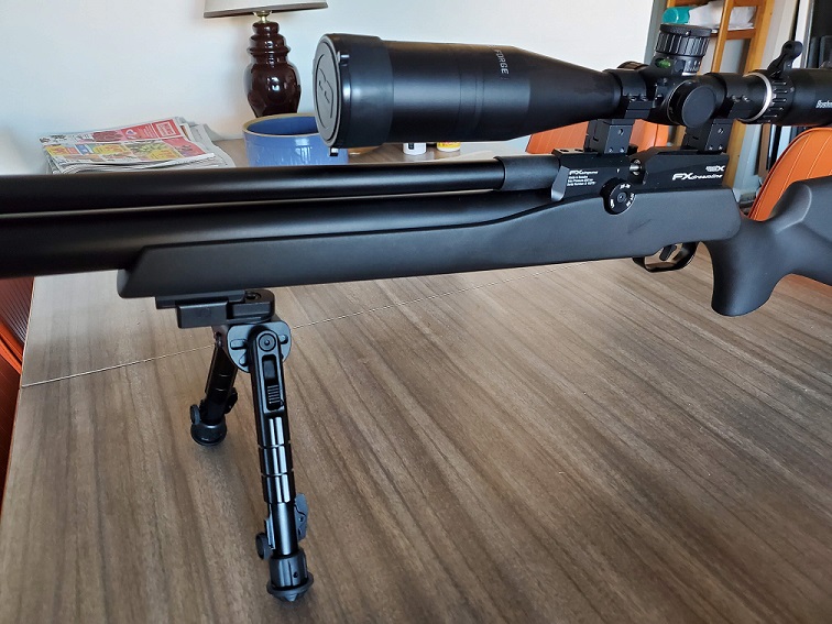

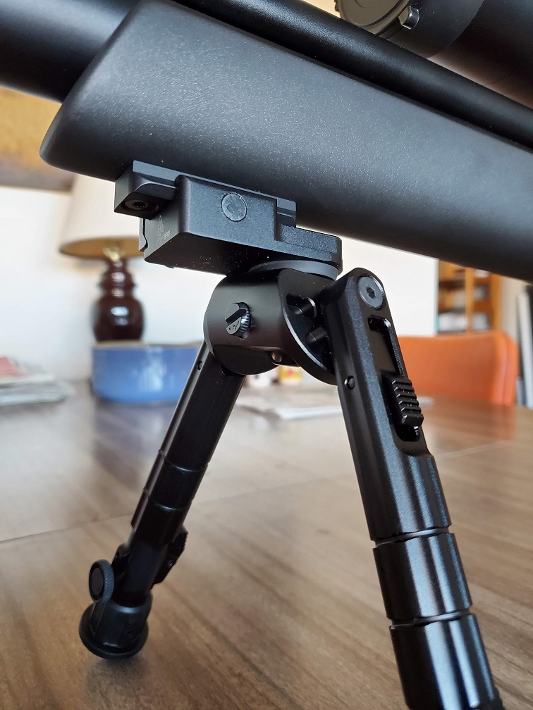

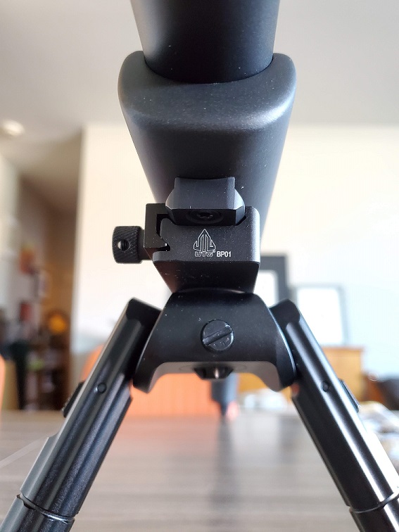

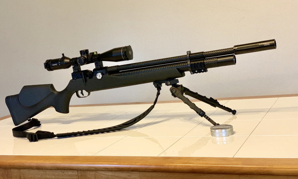

Aparks454, take a look at my setup. I researched small bipod mounts and could not find the right curve to match my stock, until I saw the "FX Wildcat Accessory Picatinny Short Rail" and it is exactly what I was looking for.
https://www.airgundepot.com/fx-airguns-picatinny-accessory-rail.html
I mounted it using a dot of Blue Loctite on each screw. Works like a champ.

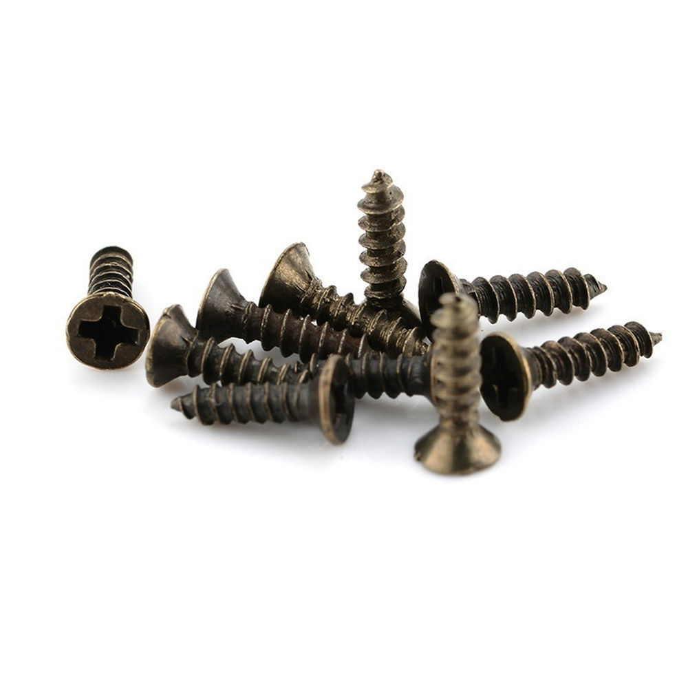

Thanks everyone for all the great info and tips! This is the exact set up I am going for joekool. Did you use self-tapping hex screws to secure the rail or did you drill completely through and counter sink to use hex screws nuts and washers? I am mounting this to a walnut stock.
1580931114_14590401085e3b182ac5c484.71185212_FEDB41A7-88B9-42D1-A1A1-2F598DF9BF07.jpeg
Self tapping screws similar to these, did not drill all the way through. Only the depths of the screws or sling stud.
