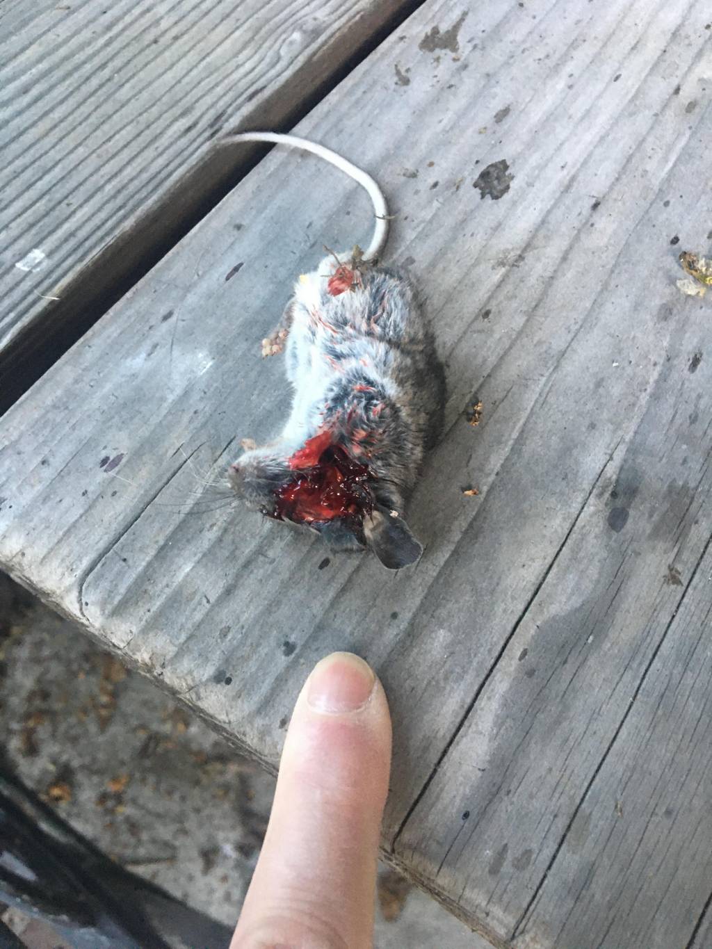

Some guys try to shoot pellets holes on top 0f pellet holes. Some guys shoot soda cans. Some guys shoot mice. Use the right tool for the job.
😂 I shoot mice.
So far 22 yards is the furthest confirmed kills. And even then I sometimes feel 12 power is not enough 😰
