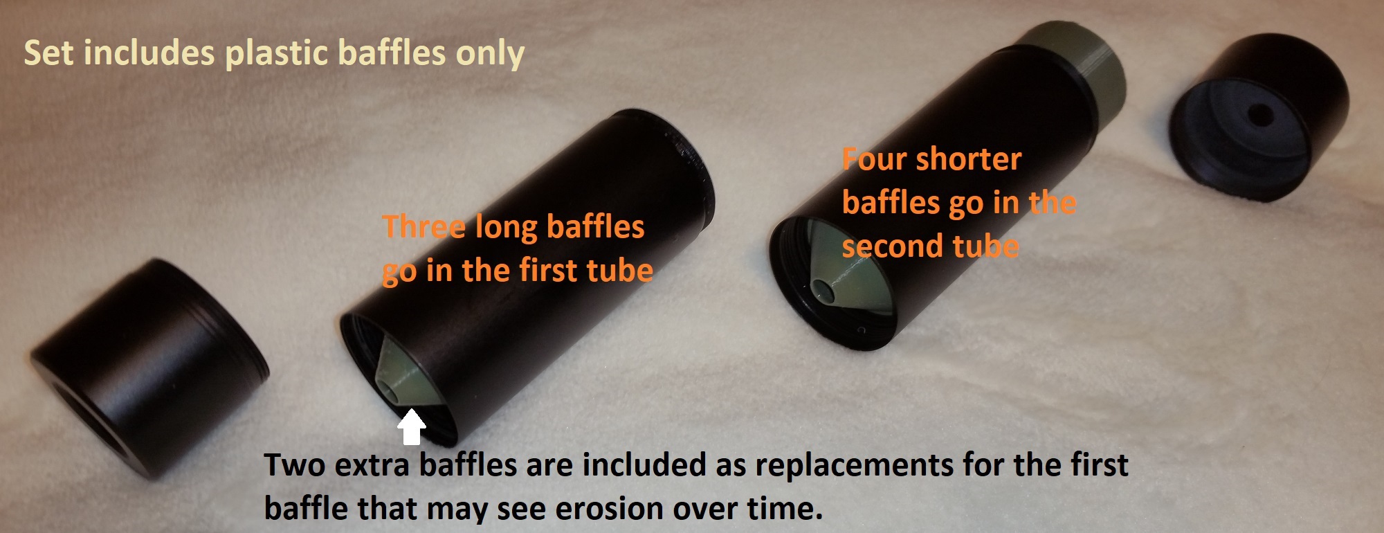

I don't think anything can compare to the basic aluminum can that came on FX guns and add 3d printed baffles with a very tight bore.
With 2 75mm center sections and 7 baffles it made my 132fpe .30 impact sound like one of those silencers you see on TV except quieter. You'd still hear air coming out for a second after the shot. I sold my DFL Ronin within 30 minutes of the first try because the difference was night and day.
I don't sell these anymore but I'll show the pic as an example.

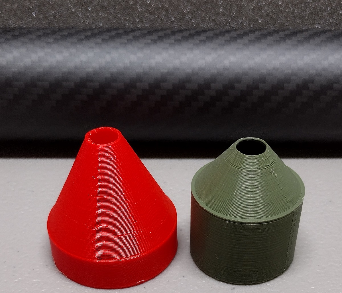

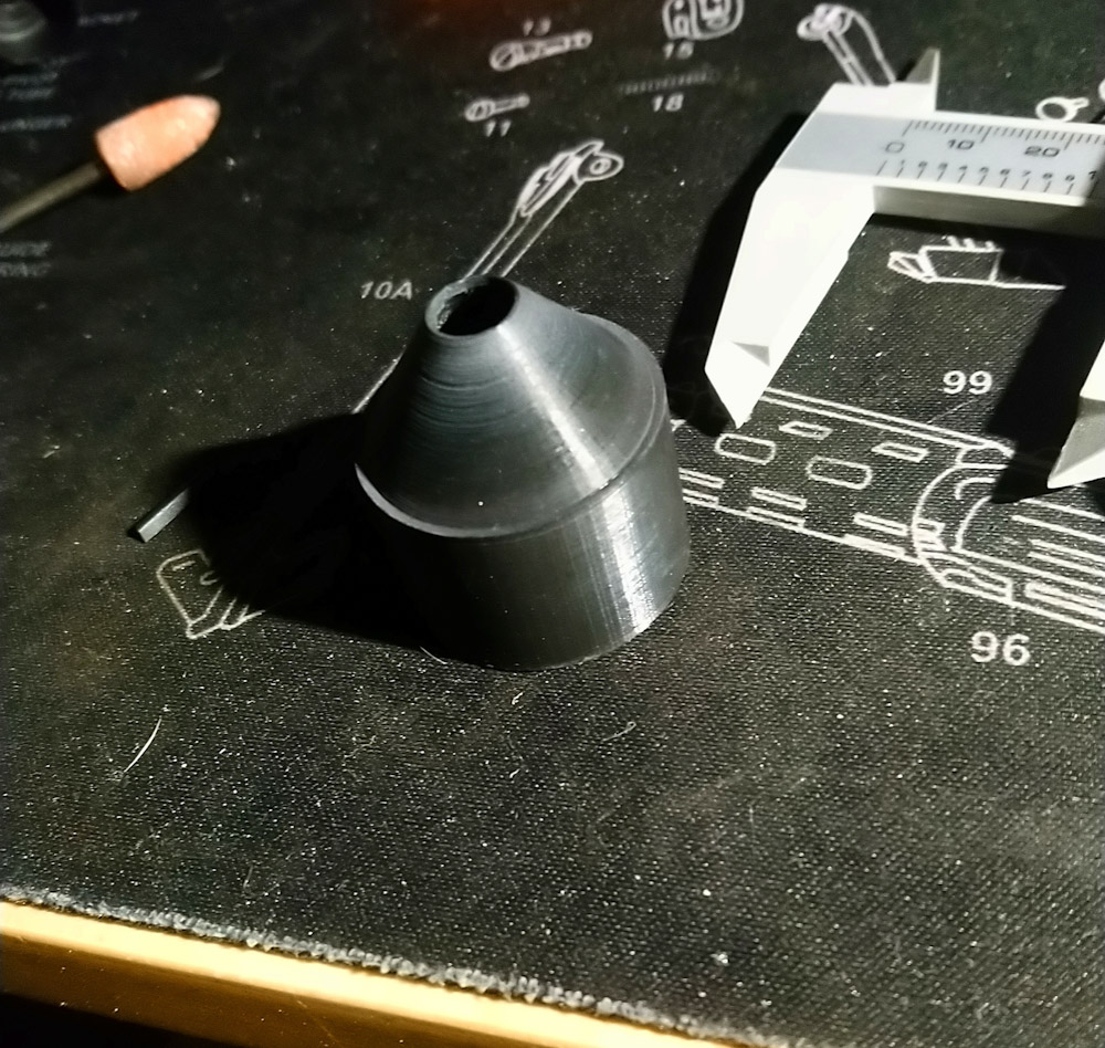

I redesigned the baffles with a steeper cone so that more baffles can be used, reduced turbulence and to delay the air longer.
It's better, faster and stronger to print these in PETG with a 1mm nozzle in vase mode for a single wall.

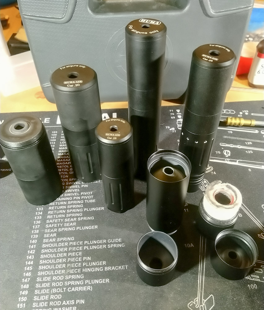

^ I use basically the same setup that I originally got baffles from heavy-impact a long time ago for. Or what seems like a long time... time is sort of relative, I suppose. I've since broken some baffles and printed some myself, but it is the quietest design I have used, and I have some of the old huma mods that were the quietest off the shelf mods at the time. I believe they still are. But new ones are a different spec now, and not as quiet.

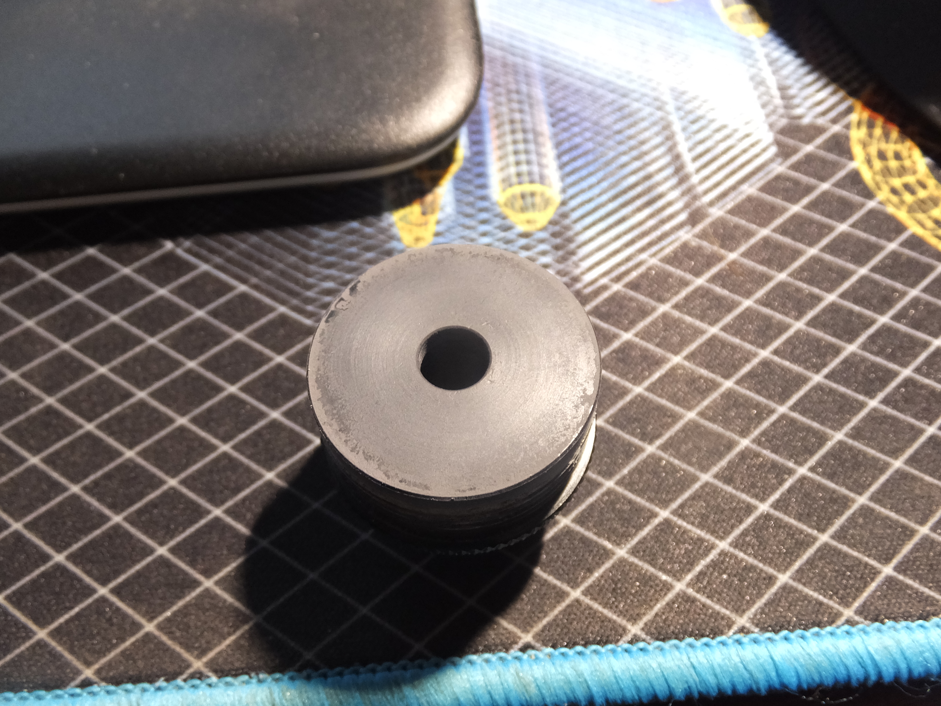

Here's what I did with my FX Crown. On the rear of the end cap for the shroud, I epoxied a flat baffle and have the shroud ported with a small hole at the rear. Can't recall exact specs, but the baffle is milled to the exact ID of my shroud, and it has a 6.3mm hole in it. This traps more pressure inside the shroud, and delays it's exit. Making a moderators job easier. (dispersing, delaying pressure and volume exiting the bore) The moderator is a factory FX continuum mod with 25mm extension and 5 cone baffles that are 3d printed. Cone shaped baffles create more turbulence in my experience, further delaying pressure and volume exiting. At the end of the mod I have a wire mesh cage that holds a roll of felt. The felt takes the edge off of the report right before all of the air exits the device. But most importaintly of all, a tune that utilizes high pressure, and low volume will be the quietest. I have my gun tuned to about 135 bar. 150 would be quieter for the same power level. The less power output you have, the quieter you can tune it as well. I shoot a lot around 650fps or so for this reason. At full tilt, you can only quiet the gun so much, at which point, the moderator doesnt matter so much anymore.
View attachment 293147View attachment 293148
