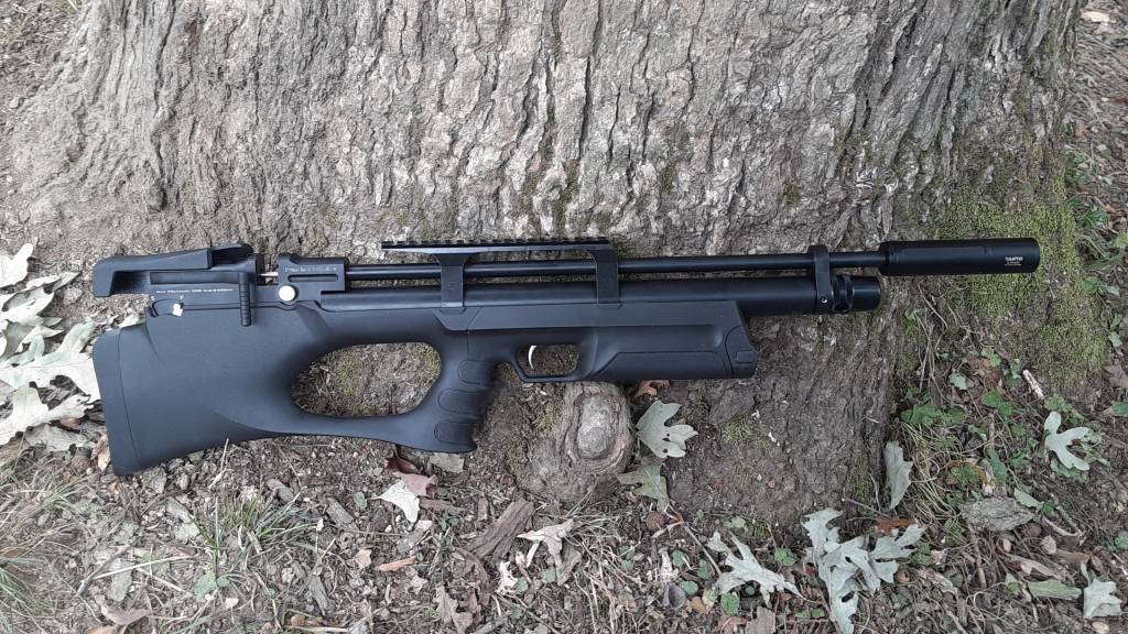

Another great low cost and well built gun is the Kral Puncher Breaker. Side lever cocking. Synthetic version is lighter and shorter than the wood. Contrary to the Hatsan there is no need for a reg. The S version does not have the Hatsan POI issues because it has a better build concept. It only needs work if you want to crank up the power beyond 50 Joule.

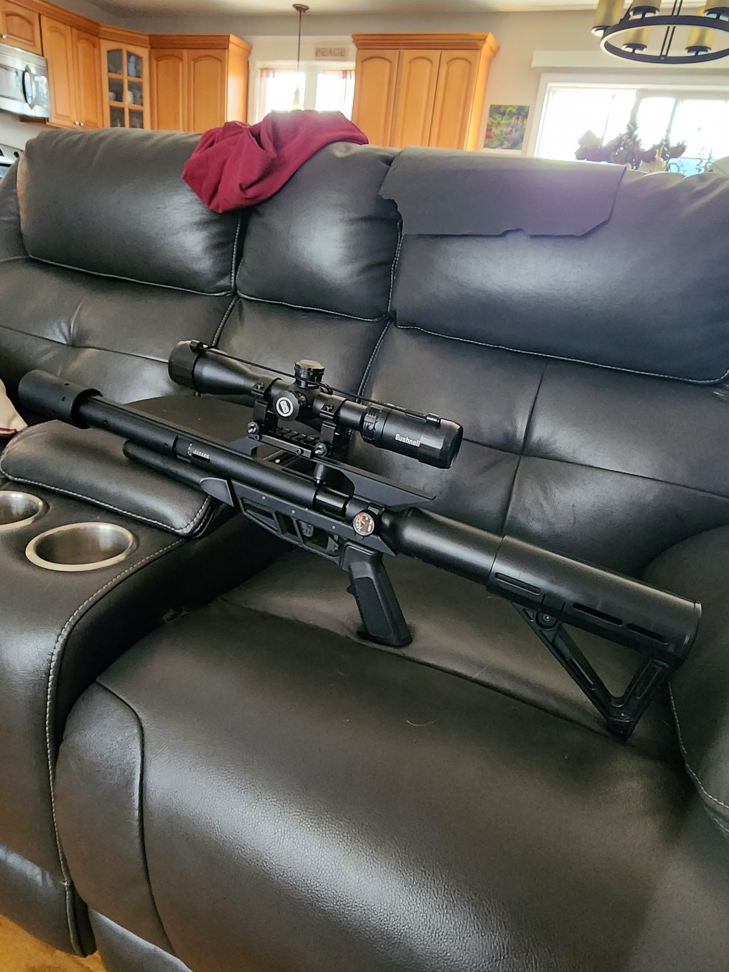

50 yards and under, .25 cal compact hunter, nothing can touch a Airforce TalonP. Out of the box 50fpe, very easy to make more, and is the easiest gun I have ever worked on.
DonnyFL adapter + Emperor and silently terminate any coyote you see.
Yes TalonP. And later on if you saved a couple hundred bucks you can add an 18 inch barrel with no special skills and shoot up at around 75-80 FPE
