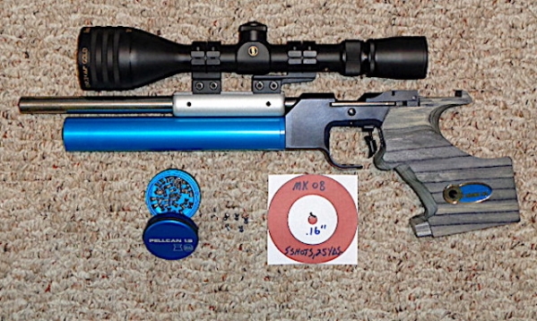

Yesterday's experience prompted me to compose this post, and is one of the more poignant examples of my (ongoing) regulated-ten-meter aggravation-odyssey. After several years owning and shooting this ten-meter pistol whose brand you would recognize but not relating to airguns, yesterday it was obviously shooting slower and lower than its last session; the chronograph confirming by 130 FPS. Mind you, this gun has made TWO trips to the only U.S. agent for servicing, having come home from the first trip (for a complete reseal) exhibiting extreme spreads in excess of 200 FPS! Thankfully increasing the hammer-spring tension (adjustment) yesterday got her back "up to snuff"; that being 8.4 grain JSBs at 510 FPS and 3/4" groups at 25 yards (in gusty conditions).
I've also had to send two examples of an eastern European regulated ten-meter pistol brand to the only individual in the U.S. that can/will service that brand; one of the guns now in his hands a second time for fabrication of a custom exhaust valve. MoF, a few years back a different brand top-level European ten-meter pistol had to make two trips to a different top-level (custom) airgunsmith. That experience not only nearly cost me my sanity (and a national champion title), but the sanity of said custom airgunsmith!

Five shots into .16" c-t-c at 25 yards equals less than 2/3 minute-of-angle.
