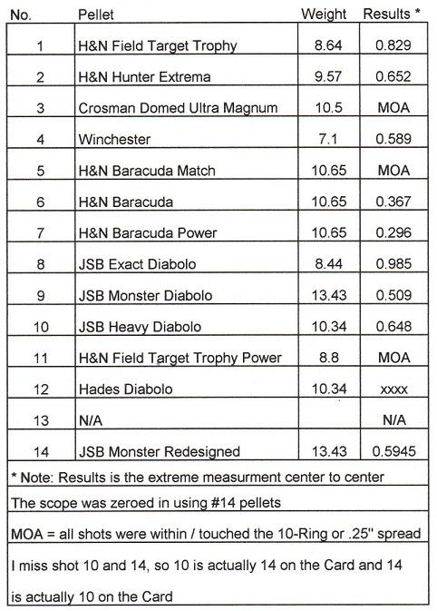

Hello everyone,
Received my RAW back yesterday after having it converted from a .22 cal to a .177 cal with a Poly barrel and threaded end. I wanted to get some pellets down the barrel and see what pellets it might like. I shot 13 different pellets with a mixture of various brands and weights. I first zeroed my new scope using the JSB Monster Redesigned 13.43 pellets ( pellet #14 ) and then shot #10 pellet, which I actually shot out of order as shown on the photo. This is not an all conclusive test because I only shot 5 pellets at each target, but it did revel enough information to narrow down to just 5 pellets for a good starting point. Next I will shoot a full magazine of each of the top 5 pellets for a better result. I also found out that this barrel does not like the Hades Diabolo, those shots went all over the target
. It has started raining so I am shut down for the rest of this day.
