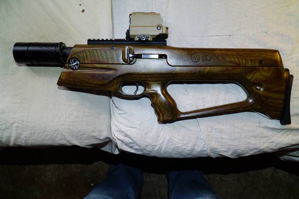

Here yeah go...shortest of the bunch -
Airmaks - Caiman at 22.6" lg. CZ barrel and all ! Although it's now a little longer with the "Fat Boy" on it, but still shorter than its bigger brother the "X" version . Smooth cocking action, easy to load.

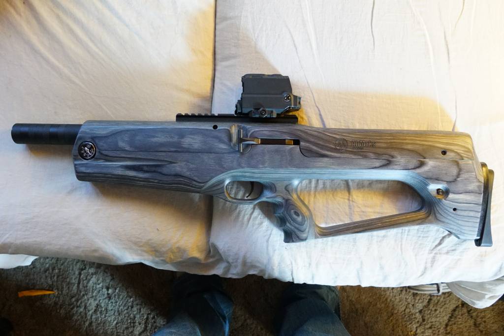

Caiman X at 27.5" lg.
I like shooting my Caiman (.22) (and the X). Comfortable at the shoulder, accurate. Nice looking (to me).
Mike
Wow those are crazy looking and super short! I like it.
