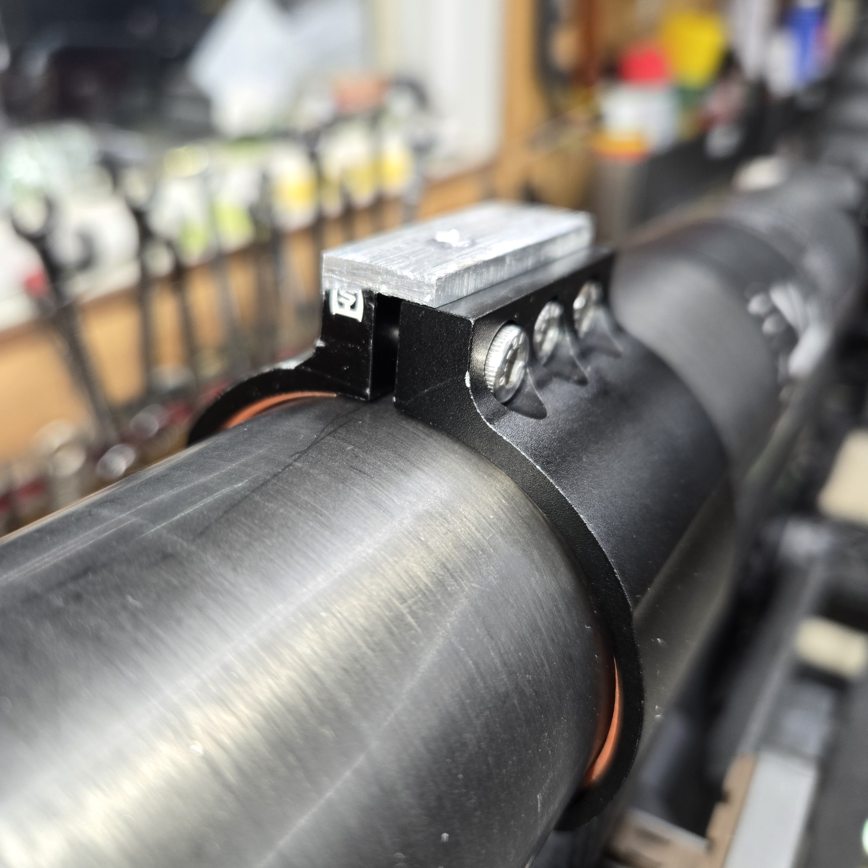

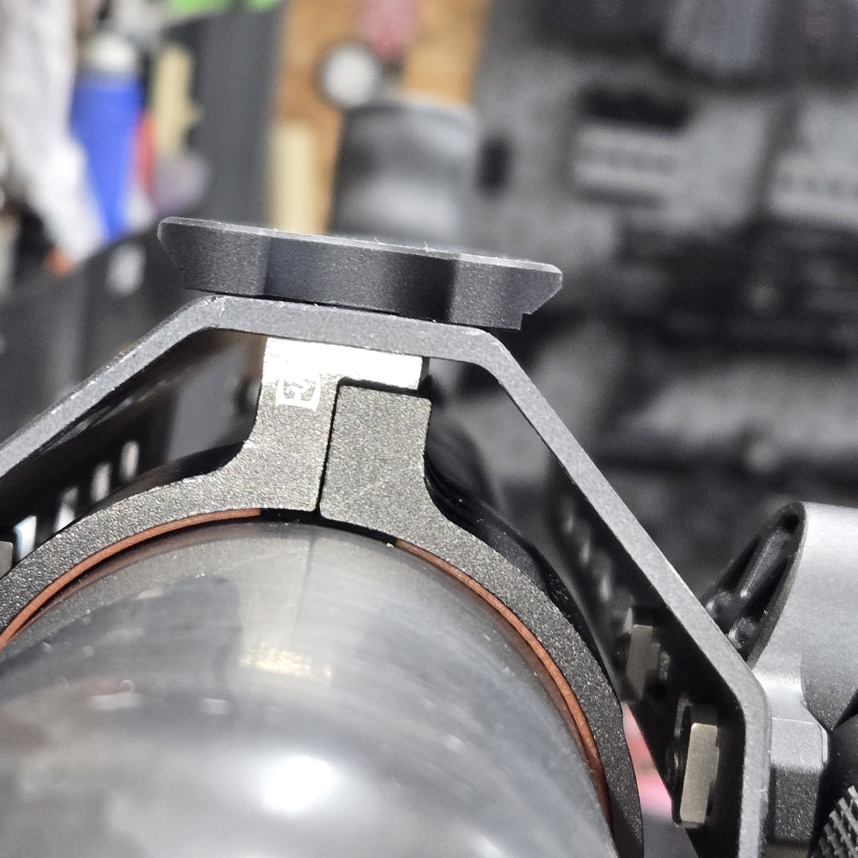

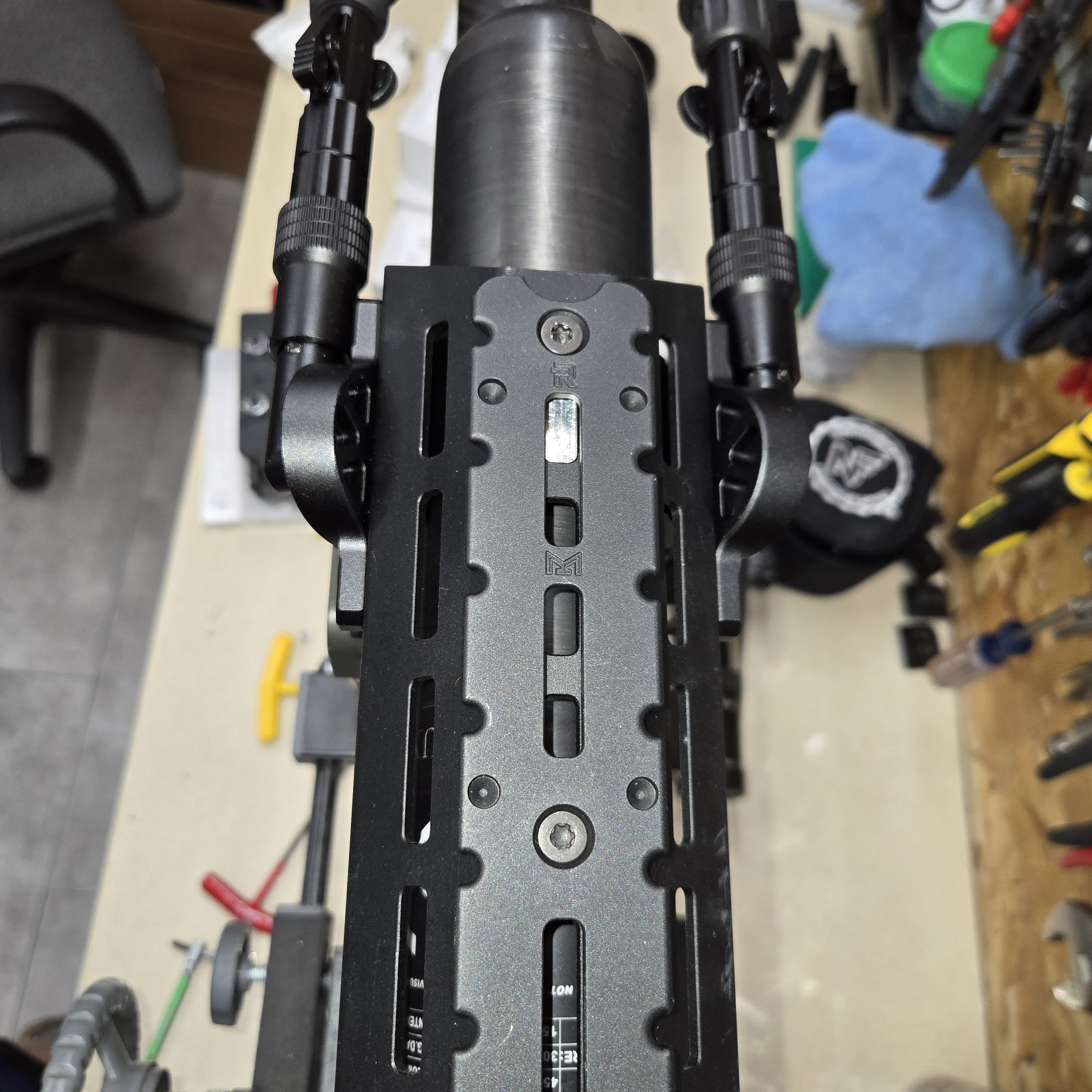

As some may know the one downfall to the RTI Mora is the bottle rail. It isn't very sturdy, it has some wiggle to it. I came up with a fix for it. Here is the list of what I used.
Saber Tactical 60mm bottle clamp. I used the arca one.
Seekins 10 inch Arca rail.
You will need a 10x24 tap, hack saw, belt sander.
I cut off the arca rail on the clamp with the hack saw. Then sanded it down so it would fit under the rail. Then I lined it up with the hole in the Seekins rail, after I mounted it to the Mora rail. I marked where to drill and tap the clamp. Taped it with the 10/24 tap. Put the clamp on loose so you can get it all lined up, then tighten it all down. The screw that comes with the rail fits perfectly. Once it is all tighten down it is now very solid.

Nice work!
I didn't like the wiggle either so I just put some 3m backed rubber strips, cut to 1" and stacked on top of each other inside the rail until they touched the bottle.
They are 1"x1/8"
It's solid now but I see that could be an option as well.. Good job !

I cut off the arca rail on the clamp with the hack saw. Then sanded it down so it would fit under the rail. Then I lined it up with the hole in the Seekins rail, after I mounted it to the Mora rail. I marked where to drill and tap the clamp. Taped it with the 10/24 tap. Put the clamp on loose so you can get it all lined up, then tighten it all down. The screw that comes with the rail fits perfectly. Once it is all tighten down it is now very solid. View attachment 582714View attachment 582718
Nice, that works perfectly!
