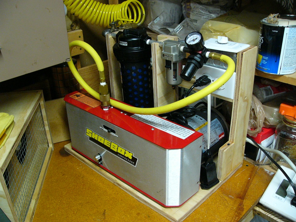

Here is my set up. I do remove the cover and have the fans to the left blowing over it while running. I use an electrical timer to control the runtime.

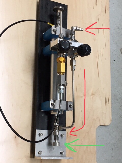

I had the same drier that Brancato showed in the video. In the photo below I show how it is vertically mounted on my bench. The airflow is shown with the red arrows show the airflow direction. The air actually enters into a tee fitting at the bottom. One side of the tee threads into the drier. One side is the air entry. And the very bottom of the tee has a purge valve that I used to crack open every couple minutes to drain any collected water. The green arrow is the purge valve.
Ok, you didn't get that rig at Home Depot, so where did you get it? Or at least a source for the parts.
I fabricated that from items salvaged from a machine at work. The filter itself came from Joe Brancato. The two valves used for isolating the drier are regular 5000psi scuba valves made by Thermo, 1/4 NPT male x 1/4NPT female. Tubing and fittings are swage type fittings, they can be sourced from McMaster Carr. The gold anodized piece is a Aqua Environment Back Pressure Valve (priority valve). It does not allow air to flow until 1900 psi, it is what causes dwell time in the drier for moisture to be absorbed by the beads. The bleed valve on the bottom is from a scuba supply vendor or as a last resort Amazon.

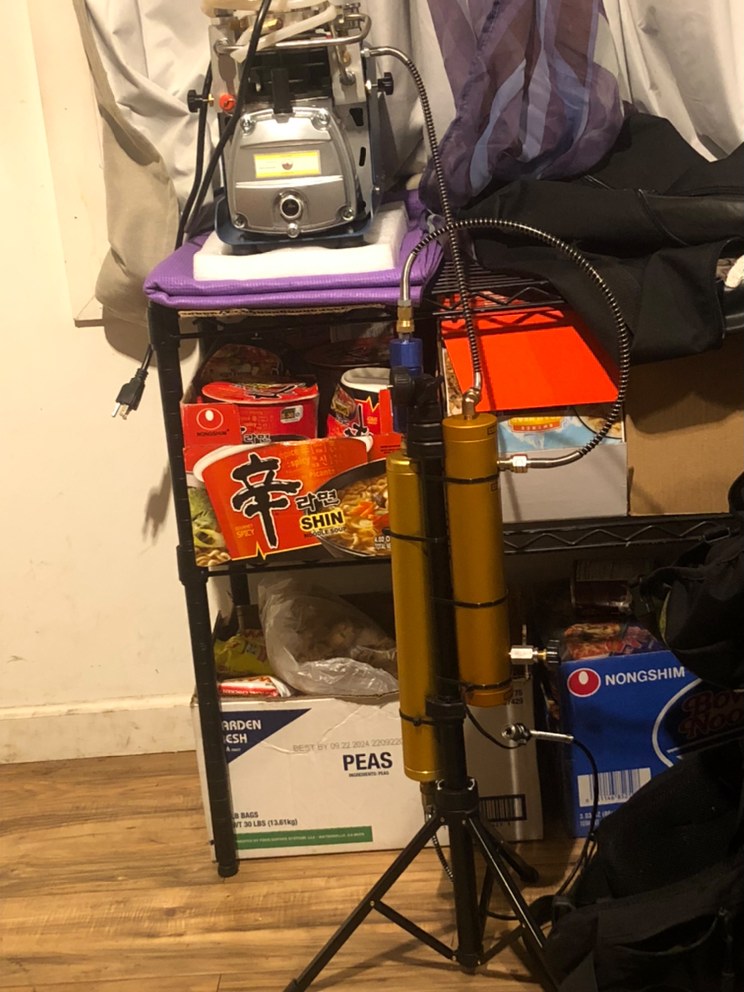

This is my setup Im running the copper ones outlet airhose over the top rather than over the bottem so the air would go up, with my setup the air outlet goes into the sieve an goes down and ends with the air venturi microbore fill whip. I was wondering Joe said that its not doing anything if its not pressurising in the copper type filters like the one I got with a bleed its pressurising the whole thing the air fills the blue an the gold one, I bleed it ever 5 mins or so a few spurts of moisture fly out and I also bleed the compressor moisture every few minutes just a split second loosen it an bit of mositure flies out. Should I change my setup to run the air outlet hose on my orange/copper colored one from the bottom up, I dont know is this makes a difference, But I see everyone running thairs from botton up so Imma ask.
Do you know which is the top? I assume that the charcoal is the last media that the air should pass. And with air entering the bottom the water would tend to stay at the bottom. With your setup I wouldn't expect much moisture to get into the last filter.
Im only running molecular sieve in both the blue one an the gold one.
I packed my tuxing tight full of sieve in between 2 cotton pads,
