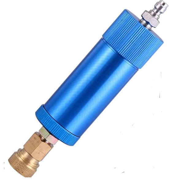

I would be curious if anyone has ever used one of those mini filters (photo) and cut the cigarette filters they come with into maybe 1/4” slices on the ends of the chsmber and molecular sieve beads in between. And maybe a spring to keep the beads compressed to assure channeling doesn’t occur.

You really don’t want to put beads into such a filter. In my opinion even putting them in the cotton could allow the moisture collected by them (which ends up being acidic) to directly contact the metal filter itself. Eventually you have a small bomb just waiting to go off

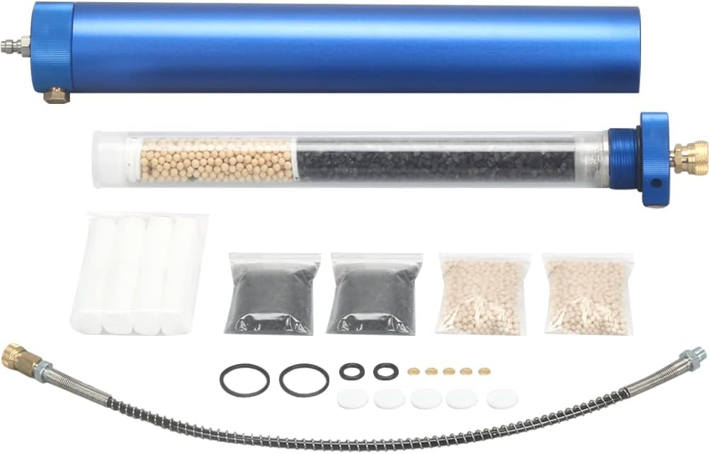

I agree. I bought one, and once I had it in my hands, I realized my plan of using any sieve or silica was fruitless. Way too small. Ordered one of the bigger ones with a plastic sleeve to contain the 3A sieve/charcoal, and I know I can easily source the 3A sieve material as well as charcoal, but still looking for the fiber discs (though this kit seems to come with quite a few).

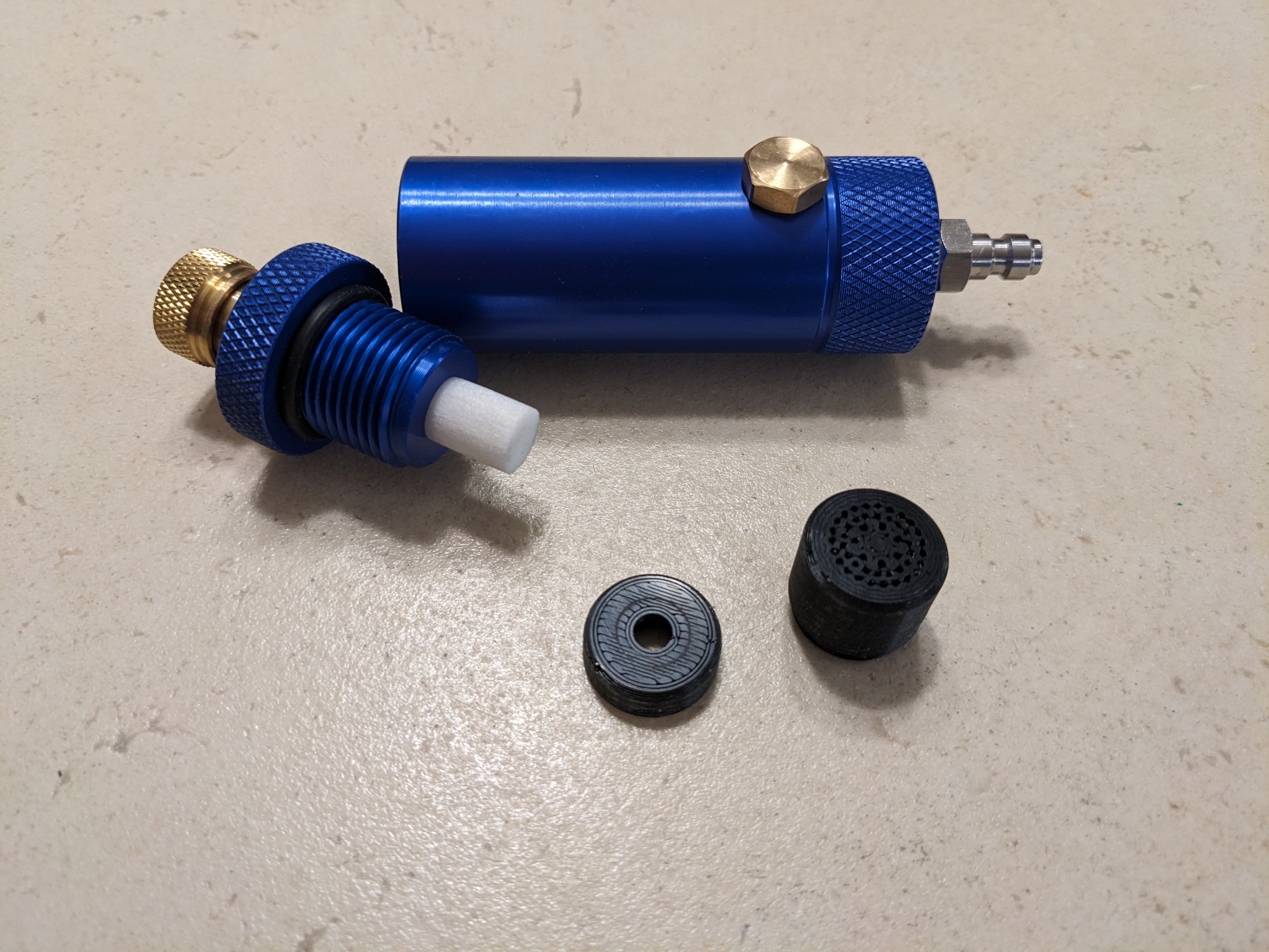

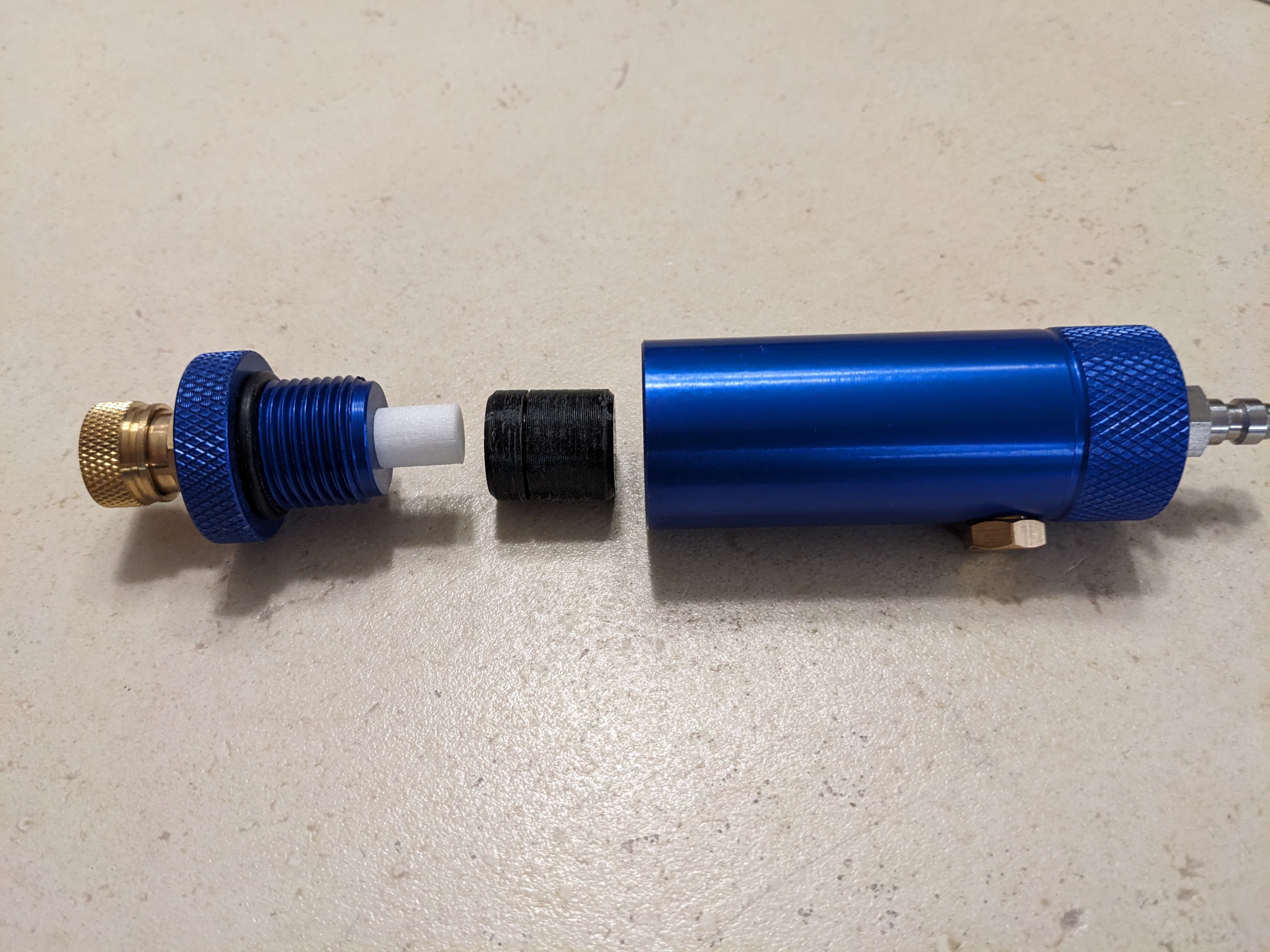

I 3d printed small container with a screw on lid to hold about 4cc of desiccant that fit's inside of the small filter after cutting the tampon in half. It won't absorb much water, but will be a good indicator if more needs to be done. My guess is that the compressor will pass more water than 4cc can handle. I going to connect this to the CS4 I just got. One side benefit is that this will take up a lot of the internal volume so the pressure should build up faster.
