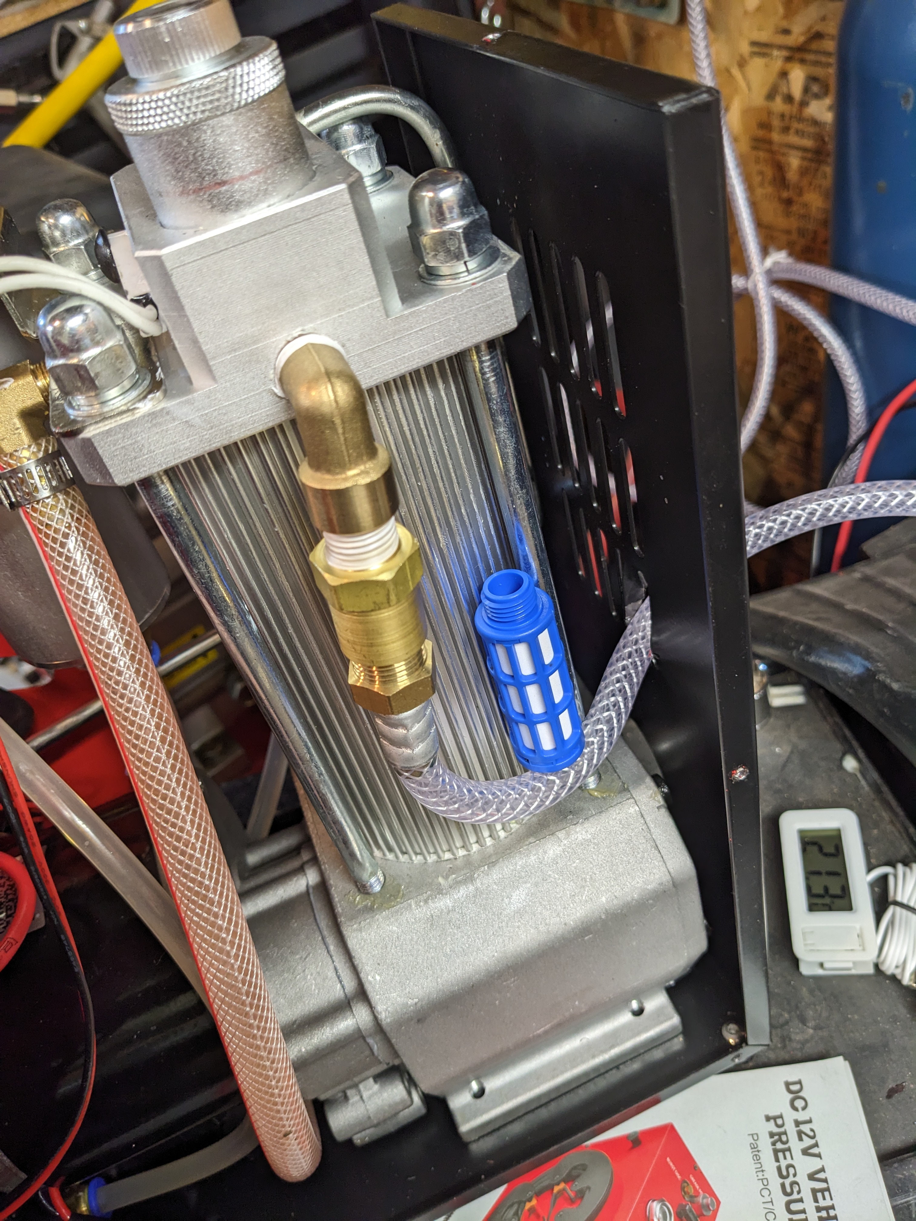

I made a post on this a while back. There are a few video clips in there where I used two hygrometers to measure the ambient air moisture vs the air moisture level coming out of the compressor when pre-filtering the air with desiccant and no output filter. You can pull most of the moisture out of the air before it even gets into the compressor. There was quite a few guys that said it wouldn't/shouldn't/cannot work, however, I've been filling this way now since them and have yet to change the desiccant in my tiny 4" output filter. If I didn't have that prefilter on that little 4" filter's desiccant would have turned color after 1/2 dozen fills. It's still 99% pure orange and I'm going on 60 fills.

Yes sir. I see no reason that your idea wouldn’t work. My thought (the bucket) was to increase the contact time as much as possible, and give the beads lots of time to grab ahold of the water. The vessel they’re in really could be lightweight, as it’s not like we’re pulling a vacuum of any consequence. I’m gonna try a 4 foot long PVC tube, maybe 2”, depending on what I’ve got laying around. As our pumps pull a very small volume of air at a time, this ought to give plenty of contact time for the silica to do its thing.
And any moisture that we can get out before it hits the compressor is a good thing, imho.
