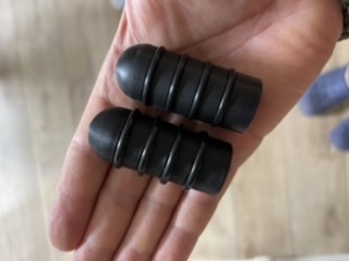

Another thing you can do is add o-rings to the bolt handle. Gives you more surface area to pull against.

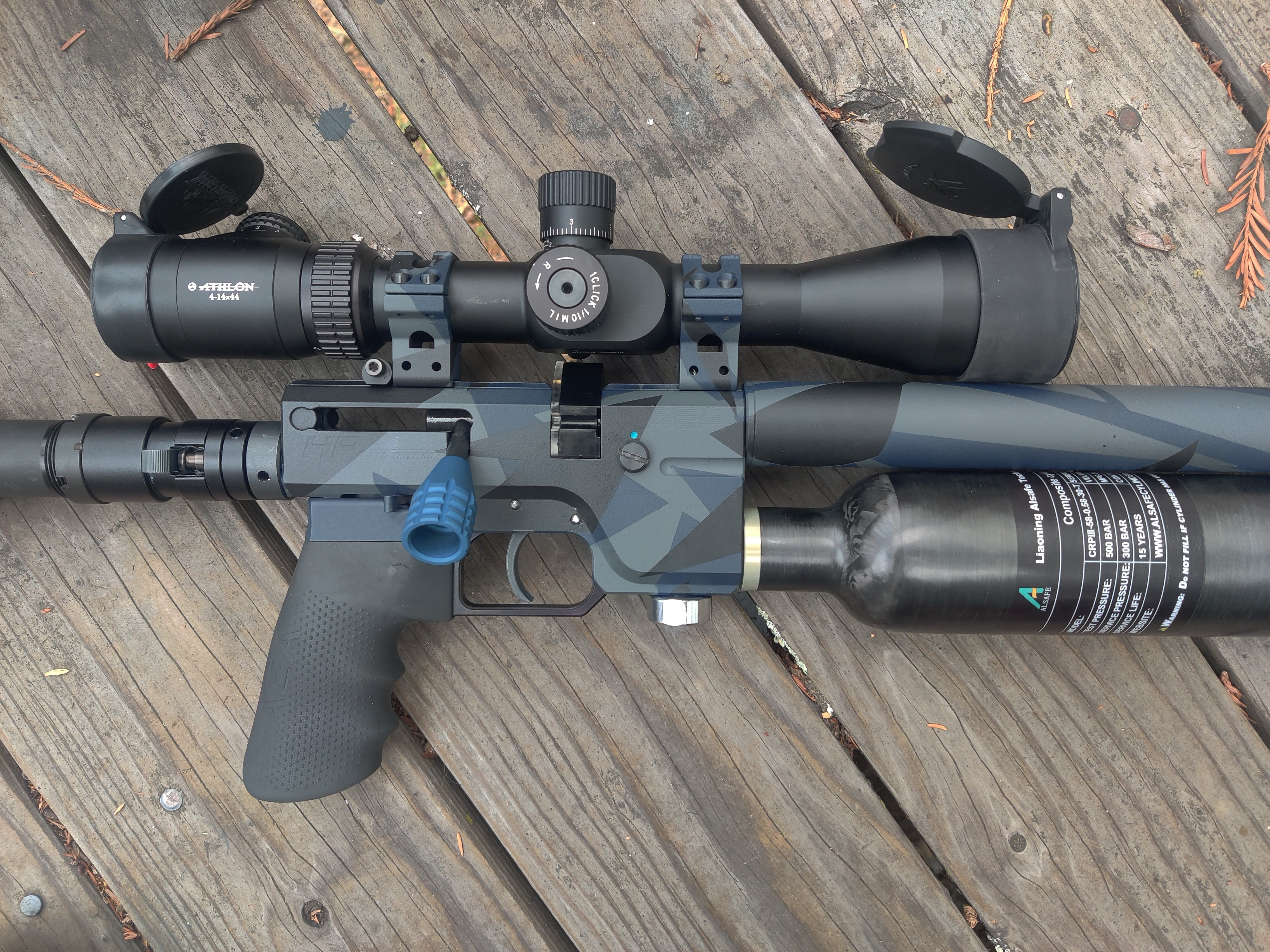

Like FelixS said, use your thumb to help. Here is what my Bantam looks like and it works great:

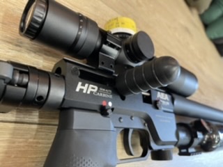

Through some experimentation I figured out that it is a LOT easier to cock the AEAs (at least the semi autos) by breaking up the cocking process into 2 steps.
First put the stock against your shoulder, fingers of your right hand around the cocking handle, and the thumb of that hand behind the gun’s action. Now when pulling the cocking handle use your thumb to supply more strength and at the same time also pull the stock INTO your shoulder to cock the gun. (It is the combination of using the thumb to push and fingers for pulling against your shoulder that lightens the perceived workload remarkably)
Release tension when the spring is compressed and the sear is engaged.
Important here is to leave the magazine totally out of the eqation! (Meaning do not try to insert it, or even keeping it in your supporting hand while performing this first step.)
Secondly, only AFTER the gun is cocked as in the step above, with the bolt fully FORWARD, insert the magazine with your supporting (left) hand against the side of the closed probe (i.e. put it in until it can’t go any further as the probe in forward position is blocking it. It is in only about half way, but it is clamped and will not fall out. Now pull the bolt back, which will be easy for the first 75% of the way, as there is now only little spring tension since the sear is already holding the valve spring as accomplished in step one. Then pull the last 25% of the way, (to clear the probe fully into the action) and push the magazine all the way in, then release the bolt to it‘s forward position.
I have these cocking supports (see pic below) but by using the technique above, I find that I mostly don‘t need to use one of them at all…
