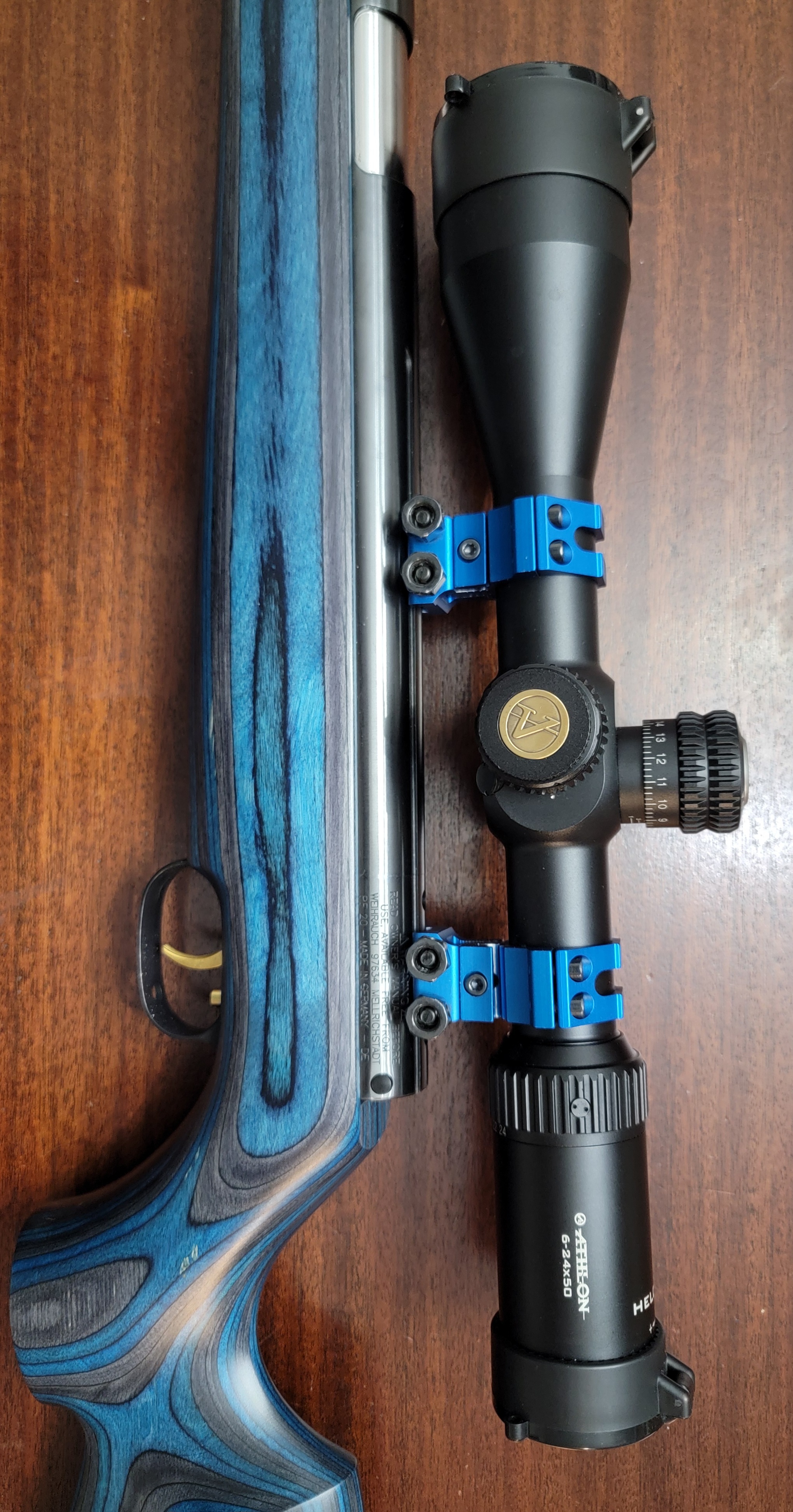

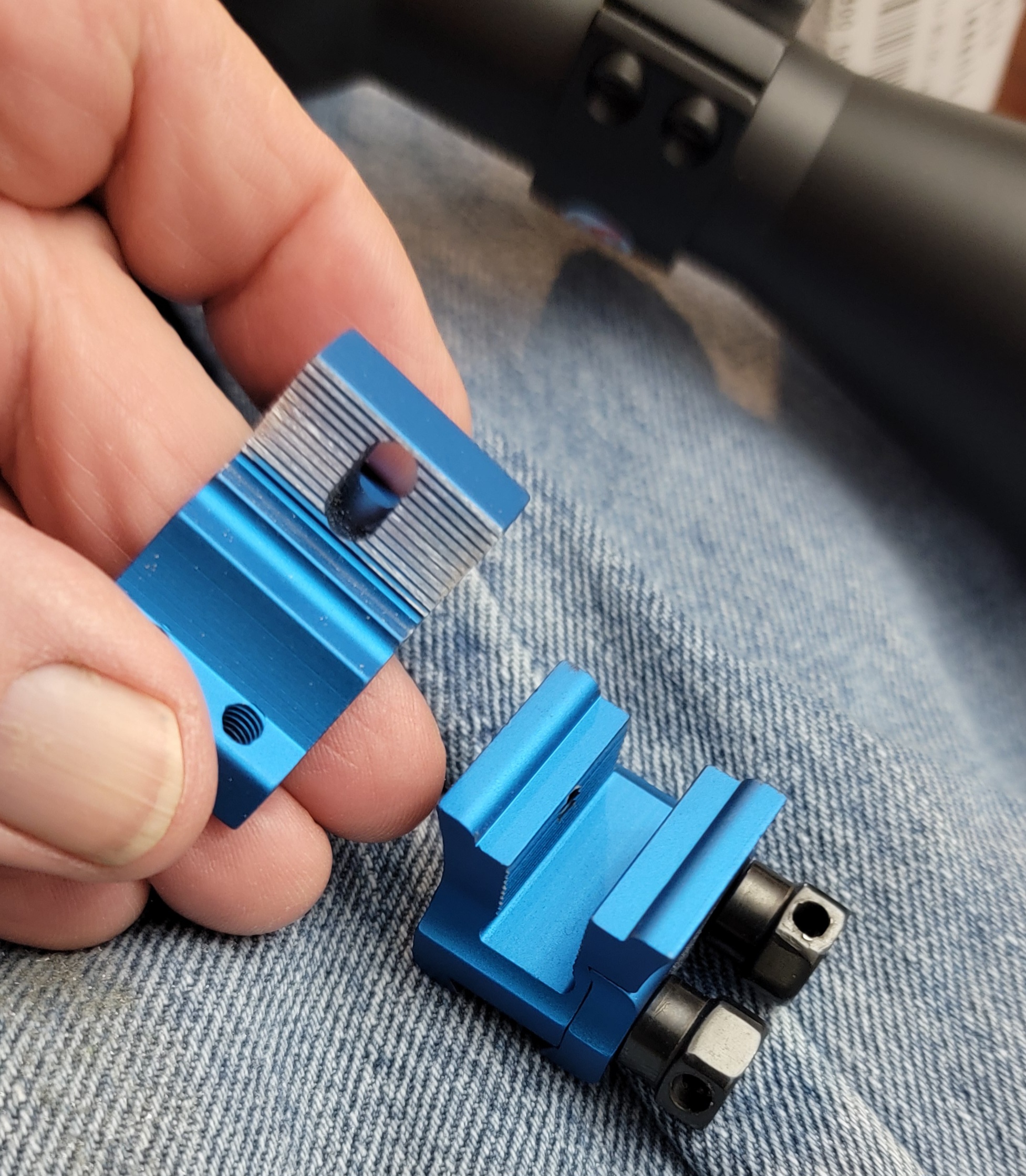

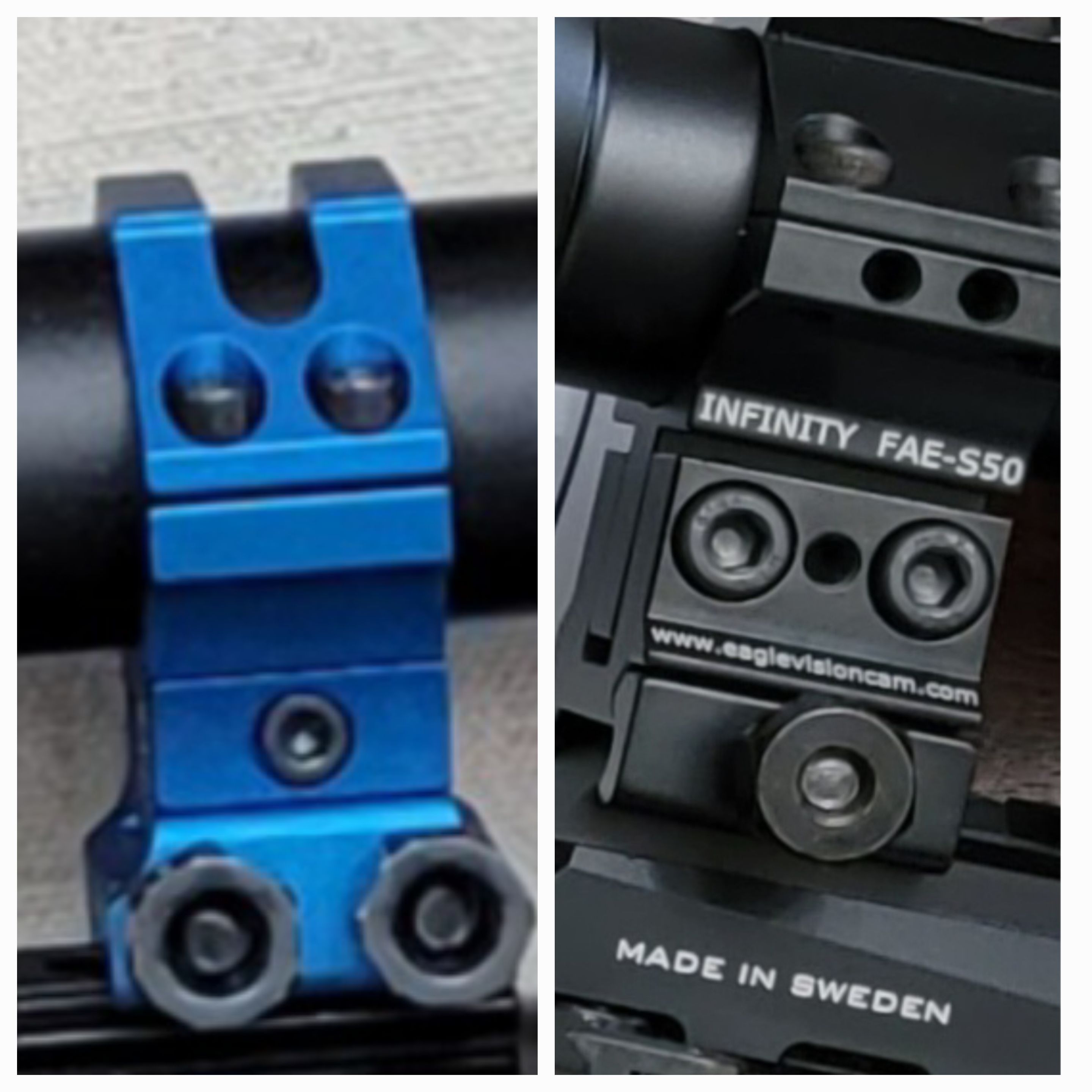

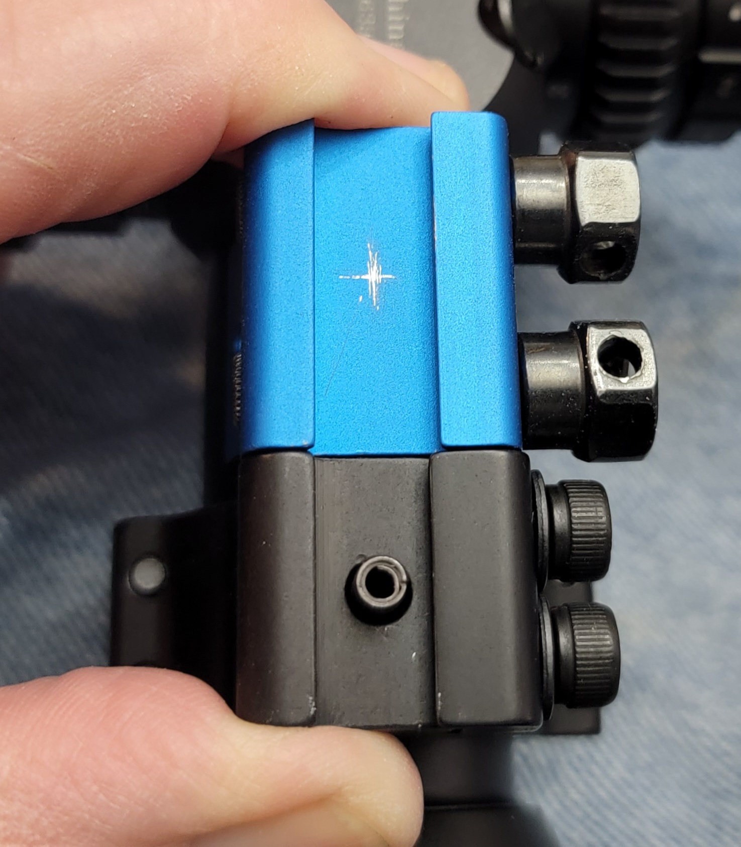

I want to be clear that I am not recommending these West Hunter rings. I am recommending a posible repair to convert them from adjustable height to adjustable MOA for people who bought them thinking that they were MOA rings.
I sanded the grooves in the center ring just short of flush. The grooves make it easy to see and maintain a flat cut.
I haven't drilled the lock pin yet, but I am ready for testing
I didn't measure the MOA angle. I just picked one.
Testing time tomorrow!
Reactions: Dairyboy
Again, I want to say that I am not necessarily recomending West Hunter rings, just getting MOA usage from them if you bought a set thinking they were MOA rings.

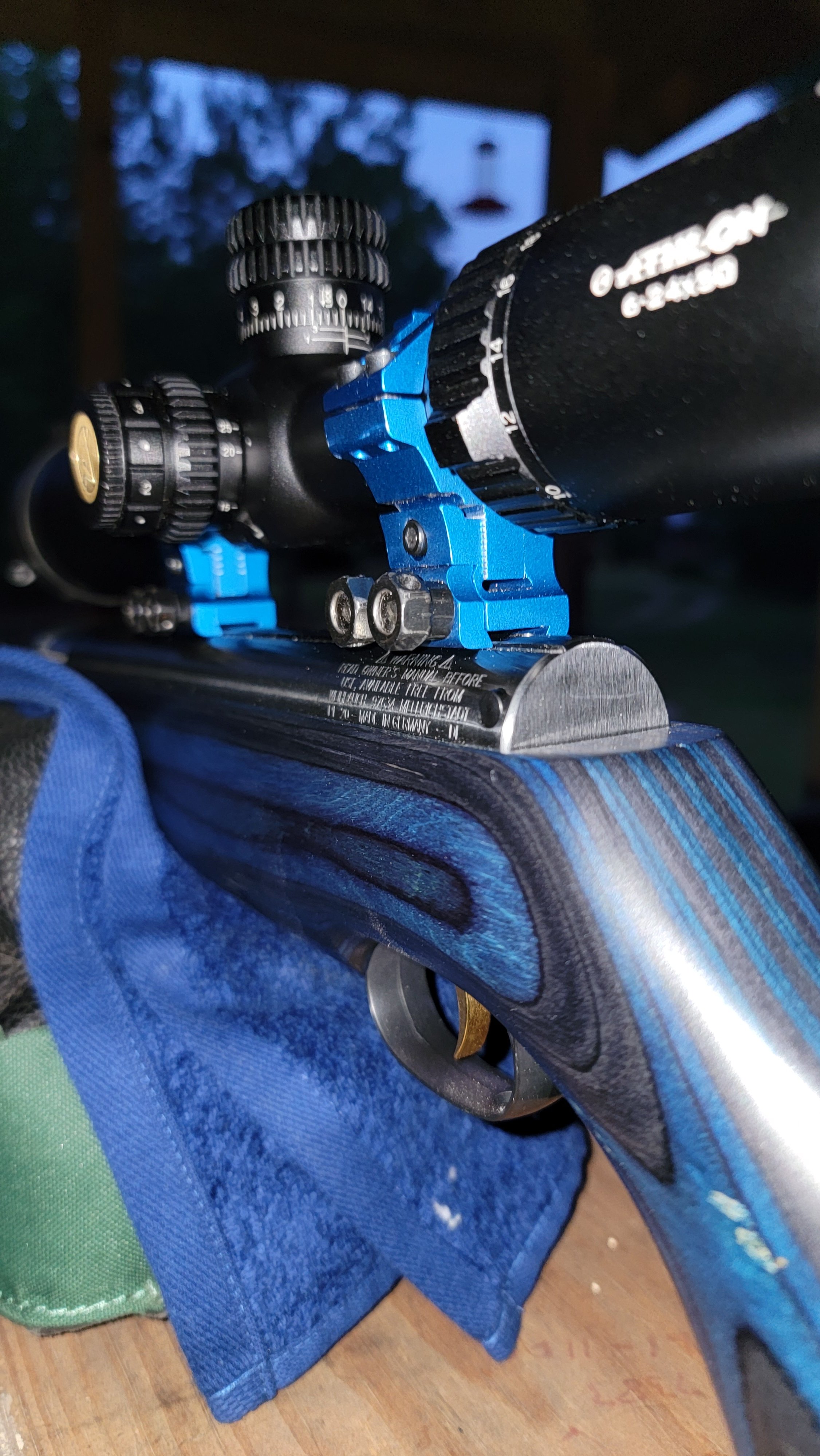

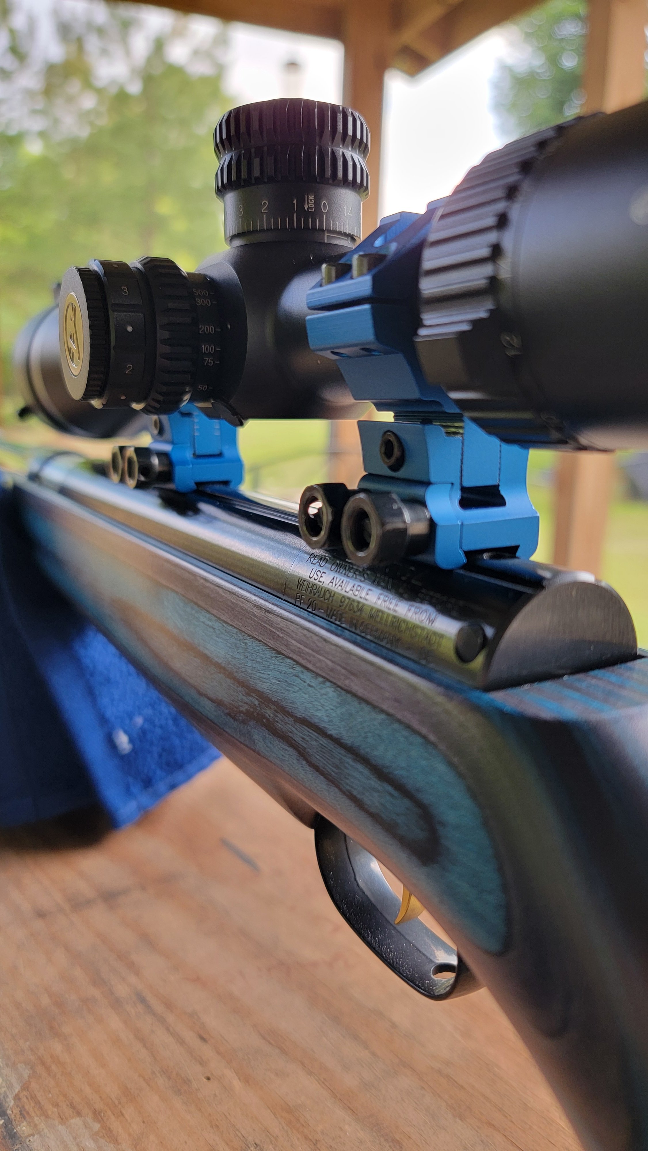

My purpose is to shoot on my range which has a 30 and 75 yard backstops, and not be too far from scope center for the safety of the scope, because I am shooting a springer.
The rings are working well, but that first set up was way to much. I went the full range of the scopes adjustment from full up to zero at 75, to full down, and I mean every click both ways.
I have made two adjustments to the rings since, and I'm currently set to have 44 clicks past scope center of up for a 75 yard zero.
I haven't tried a thirty yard zero yet, but with the scope centered it was grouping was 2 1/4" high at 30.
This adjustment will likely suit my purpose.
I just don't want my scope against the stops with a springer hammering on it..
I also hope that the WH, rings hold position as time goes by..
