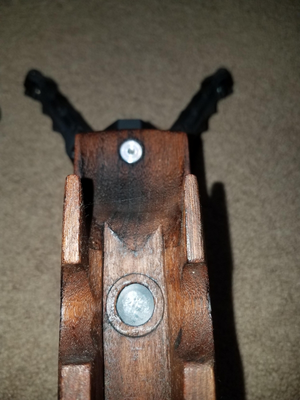

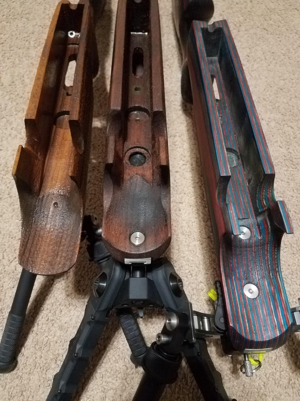

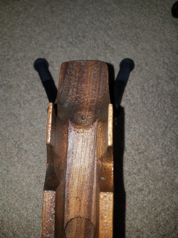

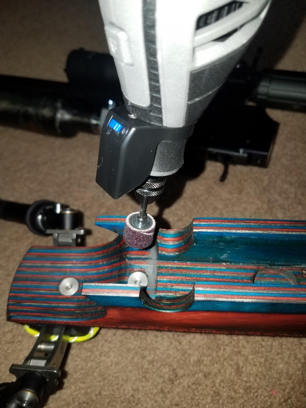

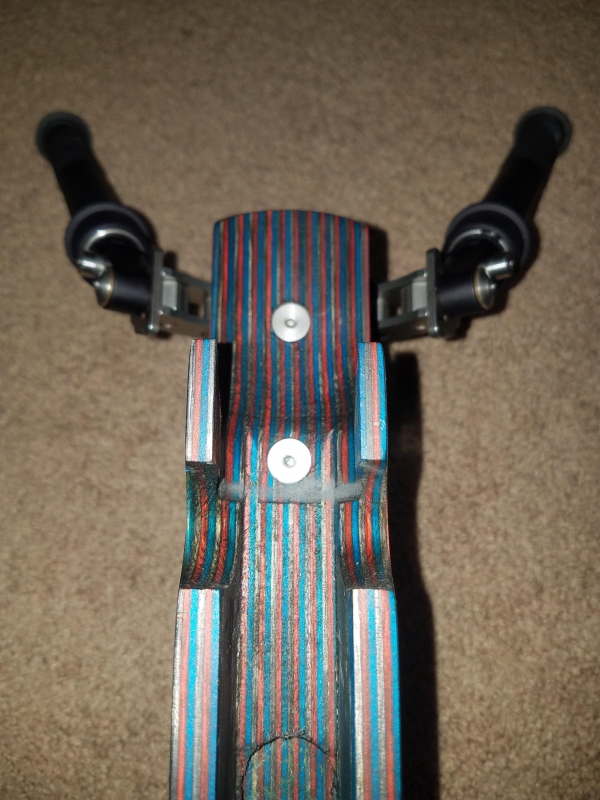

But wait...why don't you take a dremel tool & carefully sand down the "ears" so you don't have to unscrew that dang bottle that's in the way? (Sorry, I don't have any before sanding pictures...just after the sanding pictures)...

Makes SENSE correct? I've disassembled my RAW/Theoben rifles many times for cleaning/tunes/shipping & I was tired of unscrewing my bottles every time so I did the procedure myself on 3 stocks. Just take your time, be careful and your good to go. I probably sanded about 4-5mm off both insides of the ears, smooth sanded the area out to make her look original as possible, & test fitted her to make sure the action can easily slide out of the stock.
After slowly/carefully sanding w/ the dremel, just apply a clearcoat finish and your all set. No more unscrewing your bottle, no more cracked "ears," no more crying, no more depression & sadness.
