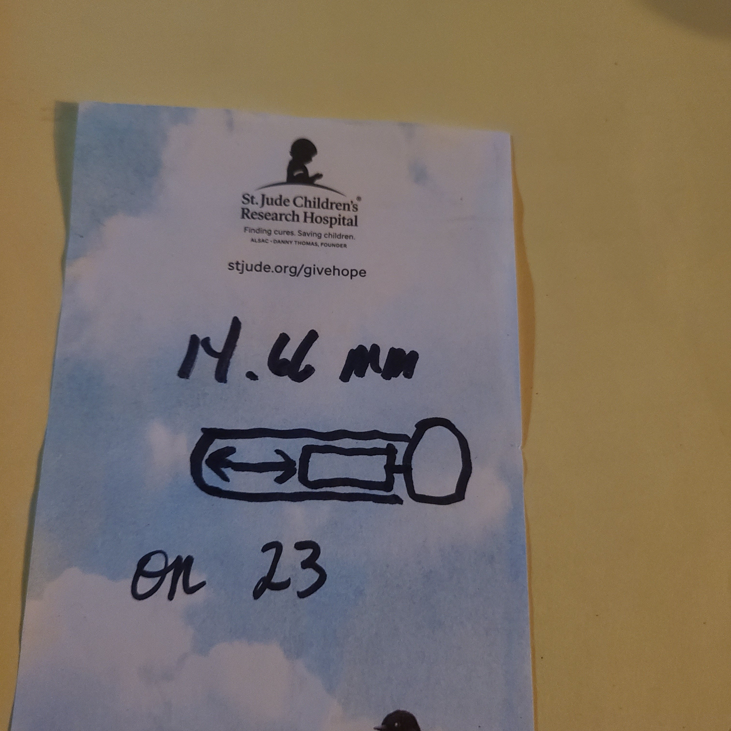

Getting to the same place from different directions.
I found for me, going to 23 then adjusting preload so there's no movement up to 24 then backing off a tiny bit. Then go to 21 on the pw and start increasing reg pressure till i get close to the velocity I'm looking for with the heaviest projectile i want to use. I then shoot for groups.
This post was started to find away to fine tune the internal pre-load in an attempt to find that sweet spot where harmonics are balanced, matter of dwell, imo. Equal forces acting opposite but equally, while being able to shot groups. As the Crown is manufactured, love the gun, this is extremely hard to due because you have to take off the stock to tweek that pre-load. Yes, it takes loads of time and help. Lots of help here, the rest is up to you.
Have fun, take good notes and pictures. You'll get just right for you. View attachment 289258
Hi, just curious, when you max out on 23 why do you drop back to 21 to start with.
