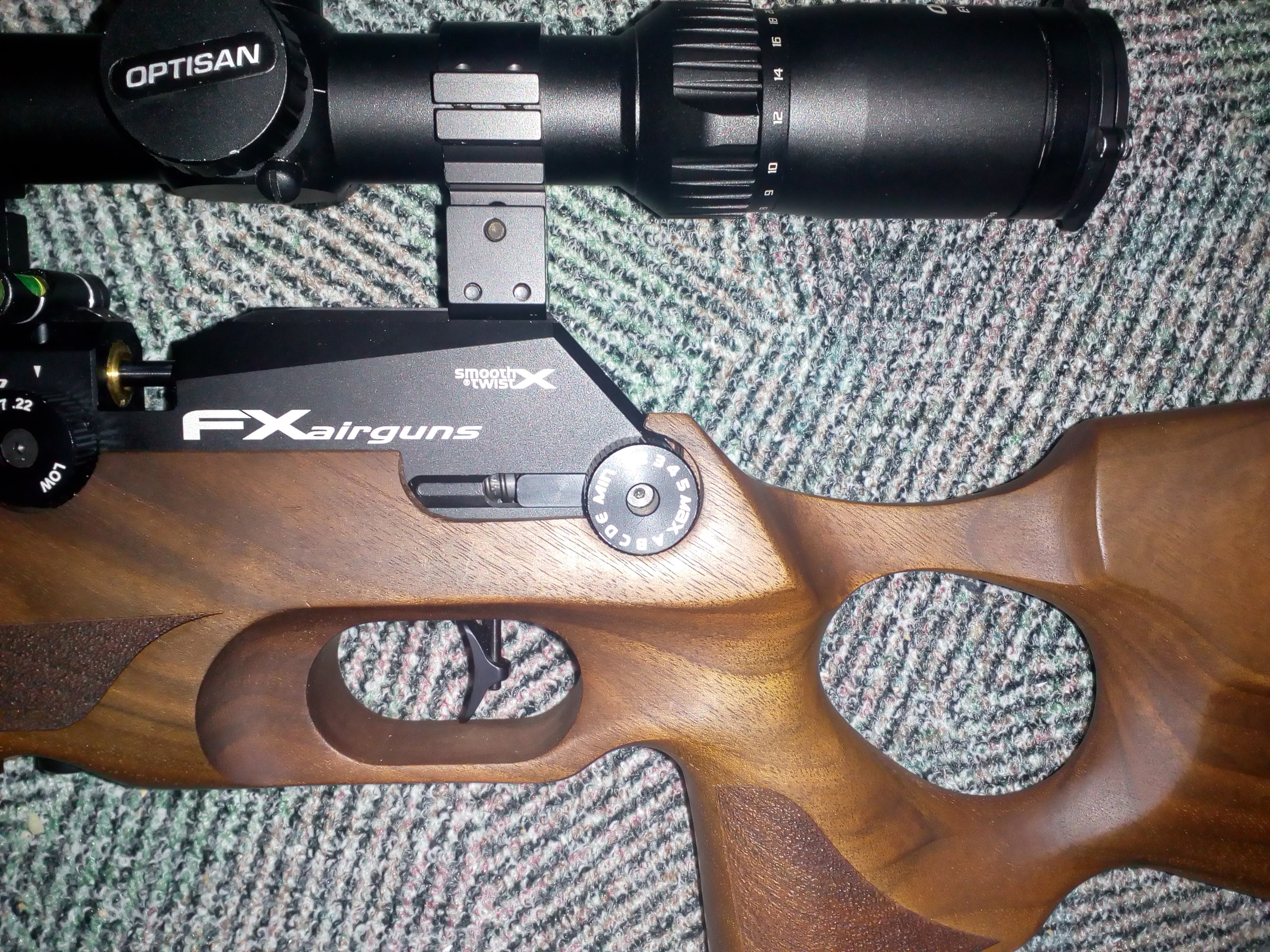

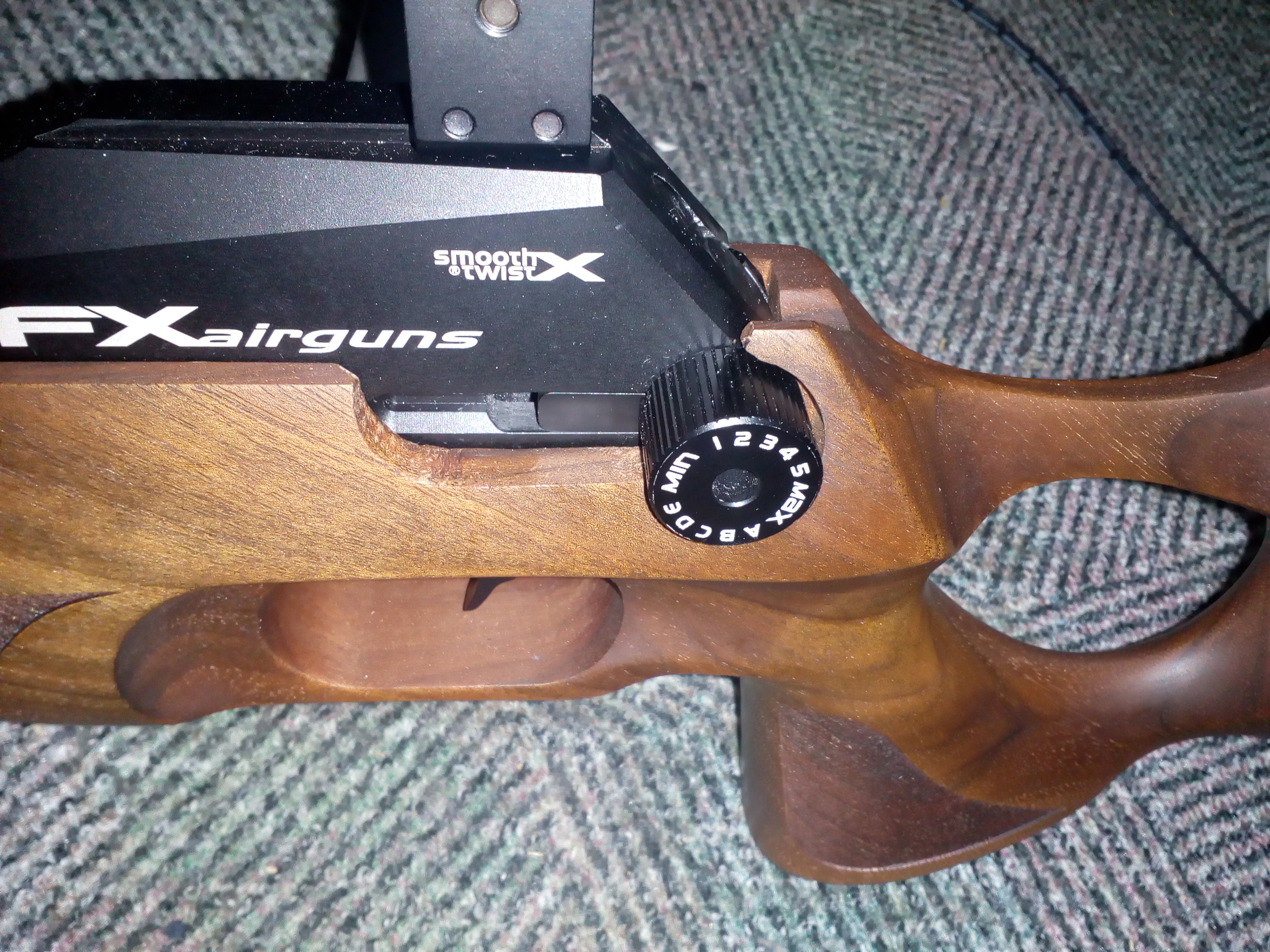

I did this a couple of years ago. It may make your gun less valuable if planning to sell it, as some may not like it. Maybe it would look better without the lip, over the wheel? It personally does not bother me, as the gun feels the same when shooting it.
I think it makes the gun more user friendly when adjusting it. You can reach the internal hammer adujster with an allen key, with the stock on.
Those are great photos on how you modified your Crown. Great access for fine tuning.
That mod might even increase the value of you gun.
Thanks for sharing.
