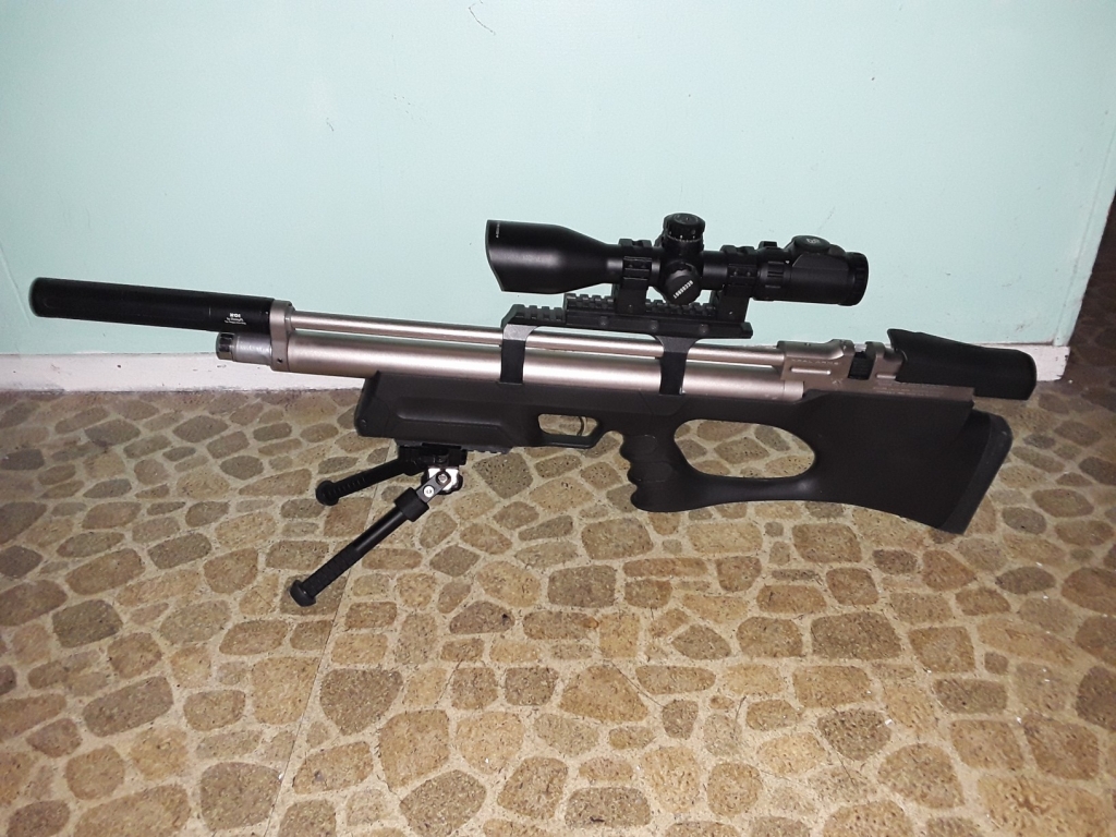

Donny has a notice on his website that gives a heads up about the suppressor bore diameters..
Always up-size one size from the pellet size that the rifle will be shooting. This will help prevent pellet-clipping.
I have a few of his suppressors in .30dia for .25cal and in .25dia for .22 cal.
Just for kicks, I used both the .25dia and the .30dia suppressors on a .25 rifle,
and there was no difference in sound. There was no POI change either.
So just up-size like he recommends, and you'll be just fine!
