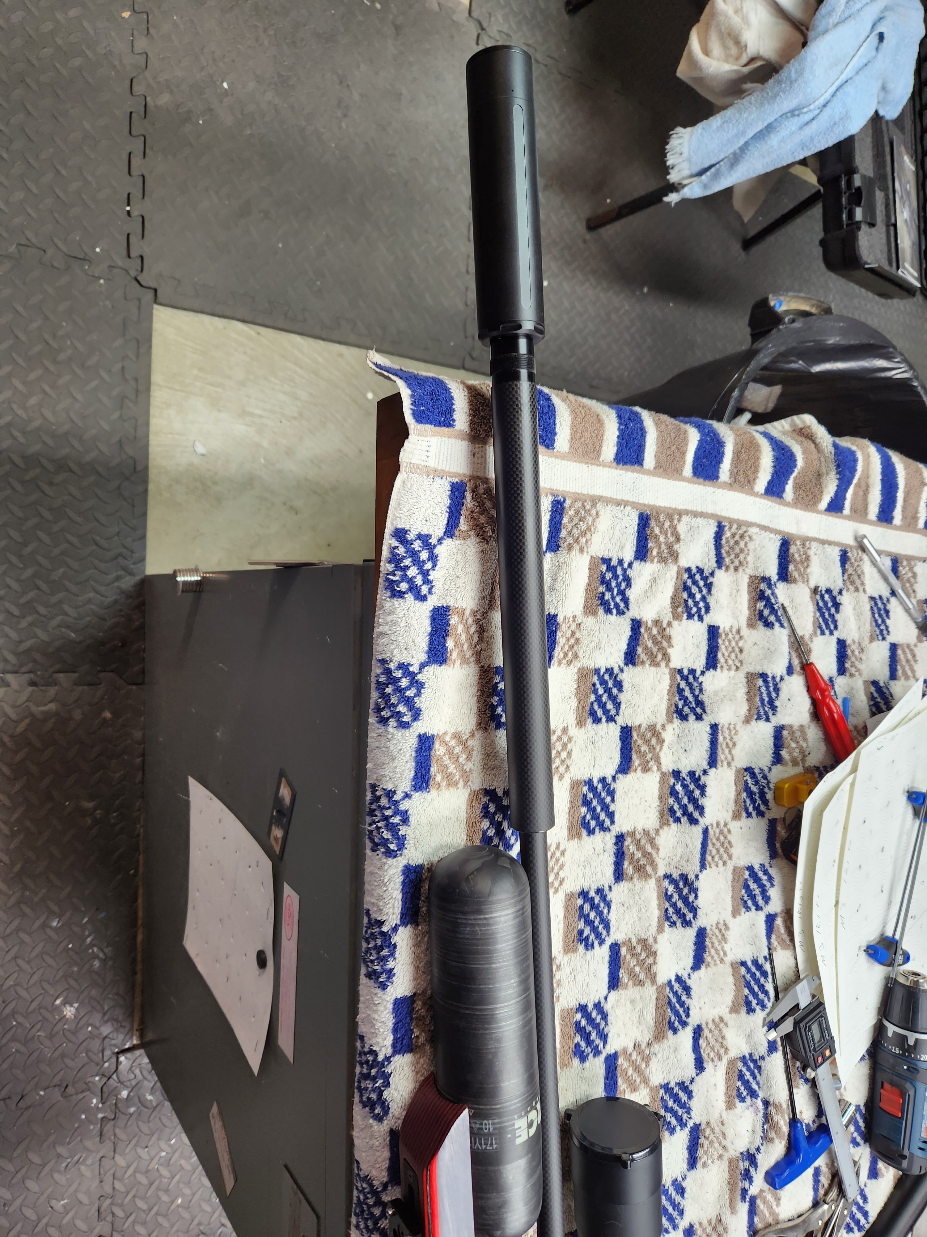

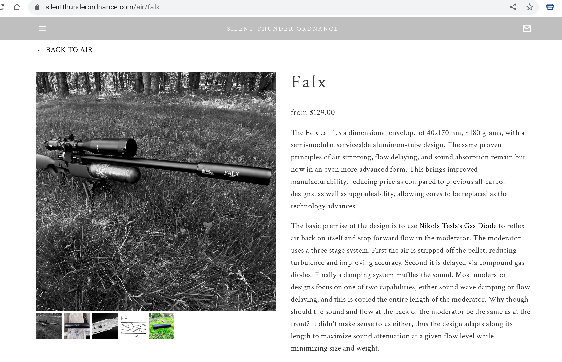

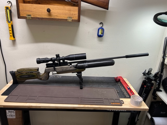

I currently have the Silent Thunder Falx on my RAW .25 cal LRT. At 60 - 62 ft lbs of power, I find that it does a stellar job of toning down the beast. I have also had very good results with a Ramus Trident moderator at about $100 dollars more. Both work well and do not introduce any unusual deviations in accuracy. As with all things, your mileage may vary..........

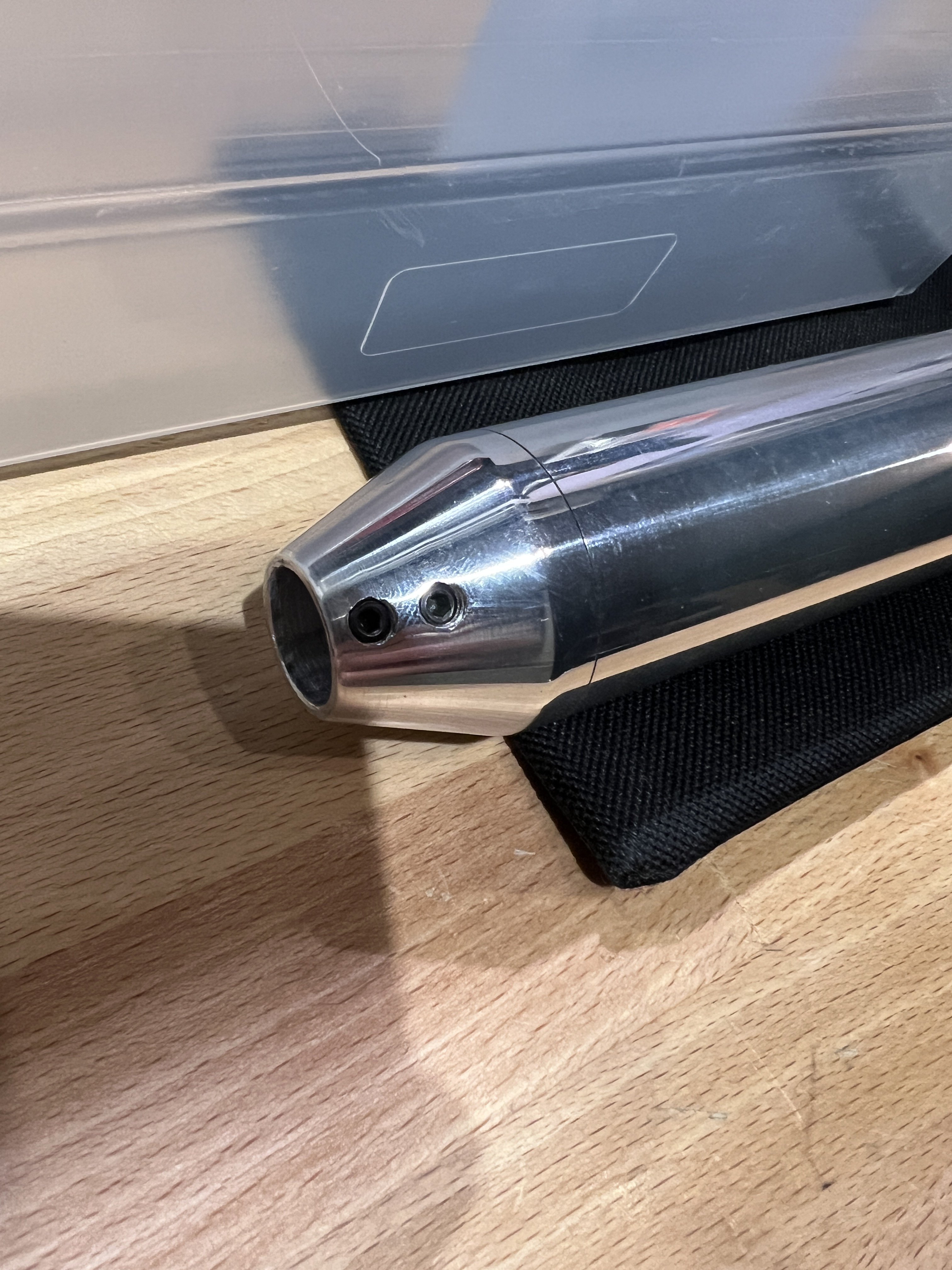

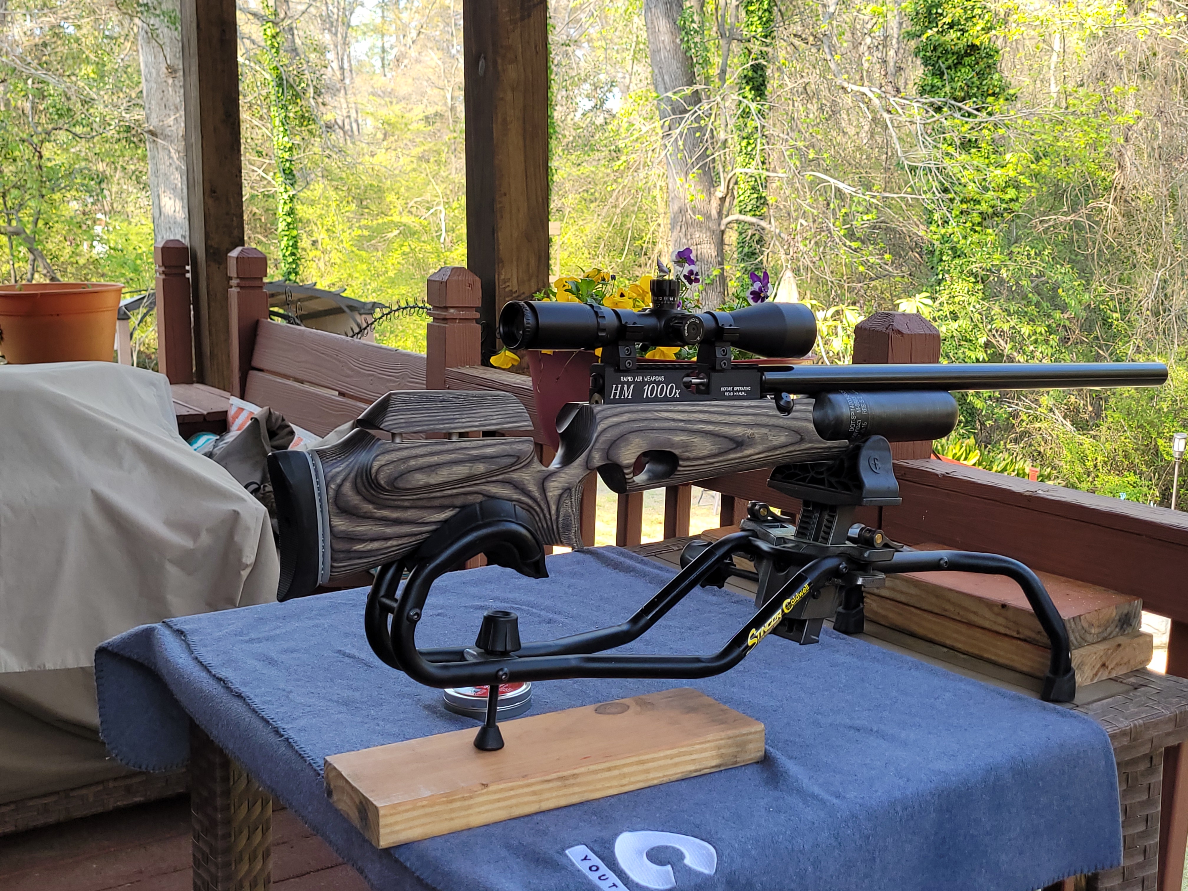

Kind of gimmicky but for an experiment I took a shrouded harmonic balance from an M3, took the weight off and unscrewed the rear plug. The shroud has an air stripper and fit my 22 1000X fine. then I found a shaft oil seal that fit the ID of the shroud and after removing the spring I was able to get it over the barrel 'nipple'. It was still tight on the barrel and shroud. This alone made a big difference and with a Shumo it is now back yard friendly.
Kind of gimmicky but for an experiment I took a shrouded harmonic balance from an M3, took the weight off and unscrewed the rear plug. The shroud has an air stripper and fit my 22 1000X fine. then I found a shaft oil seal that fit the ID of the shroud and after removing the spring I was able to get it over the barrel 'nipple'. It was still tight on the barrel and shroud. This alone made a big difference and with a Shumo it is now back yard friendly.View attachment 348482
That is a clever workaround, and looks great.

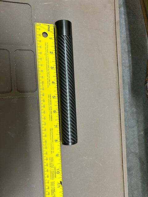

I spoke with Mike over at TKO about this for my RAW .25 after he did such a great job on the Moderator for my Feinwerkbau 800FT 20J .
As usual he knew Exactly what to do so i turned him loose, a week later i had my custom 205mm moderator and it does an outstanding job of taming the beast.
I know he also did a custom for a friend of mine in Baton Rouge after Richard saw mine.
There was Zero POI change with mine on either gun, the Feinwerkbau or RAW.

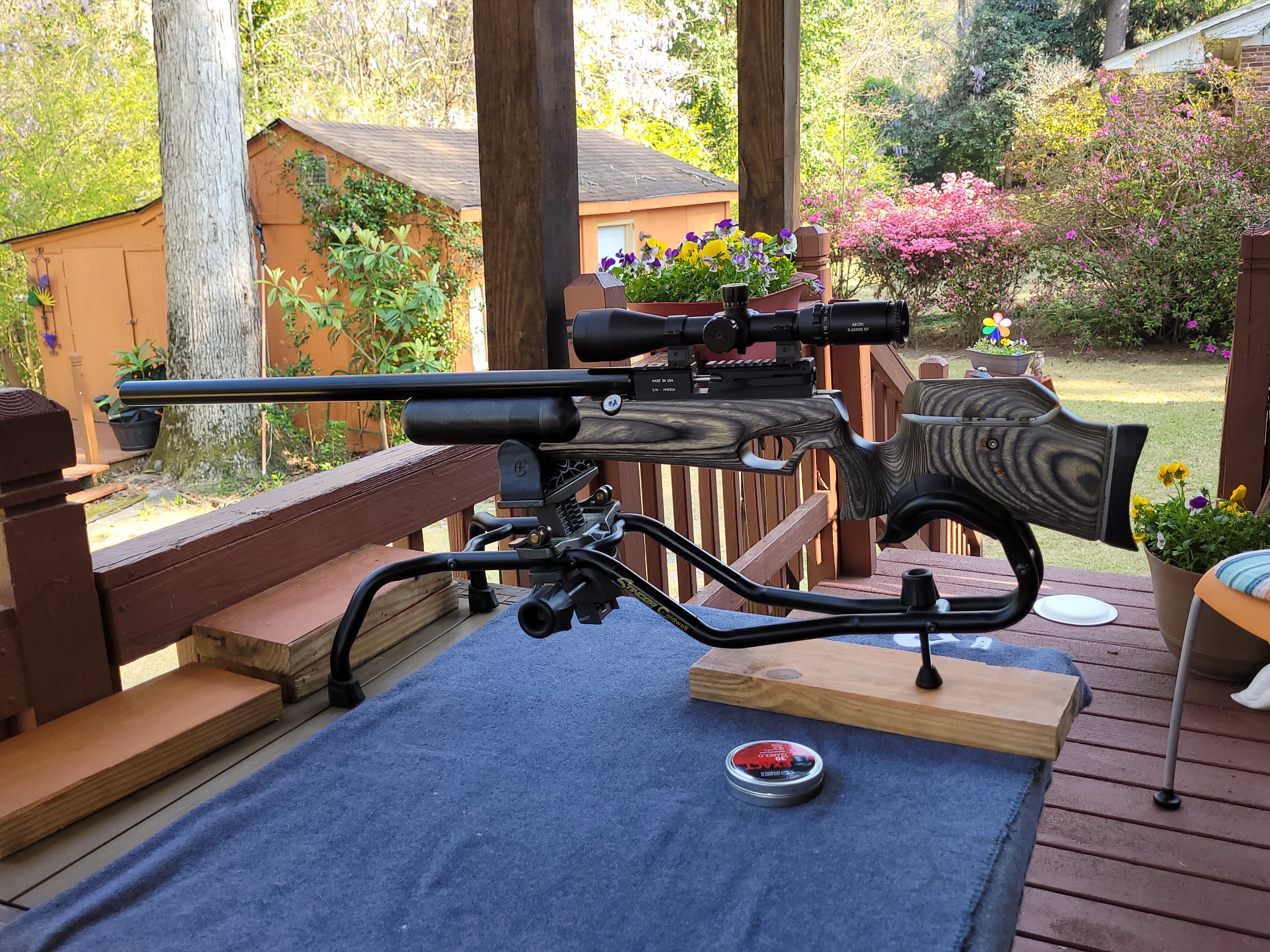

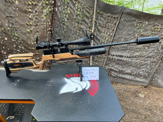

I purchased a use Ronin here and it is the only moderator I found that made it backyard friendly. I purchased two other used DonnyFL's of different sizes and had one from BuckRail made. None of them were up to para. It's got a big bark. Now if you are in the neighbors yard, all you hear is the pellet slap when it hits the target.
Sure it a whole lot better than that muffler that comes with RAW guns.
