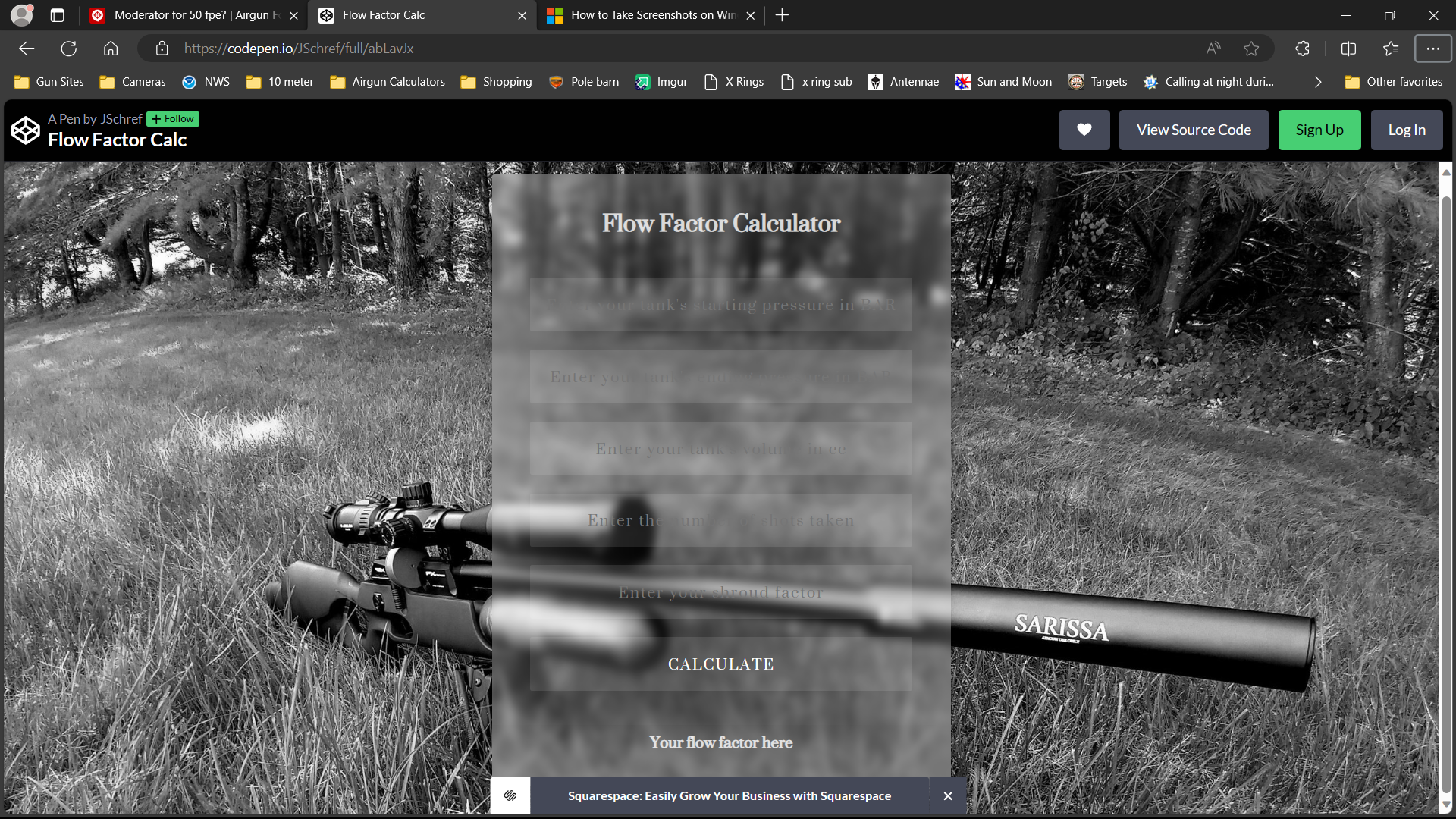

Who's the dunce who designed that webpage? I can't even read the required values.
