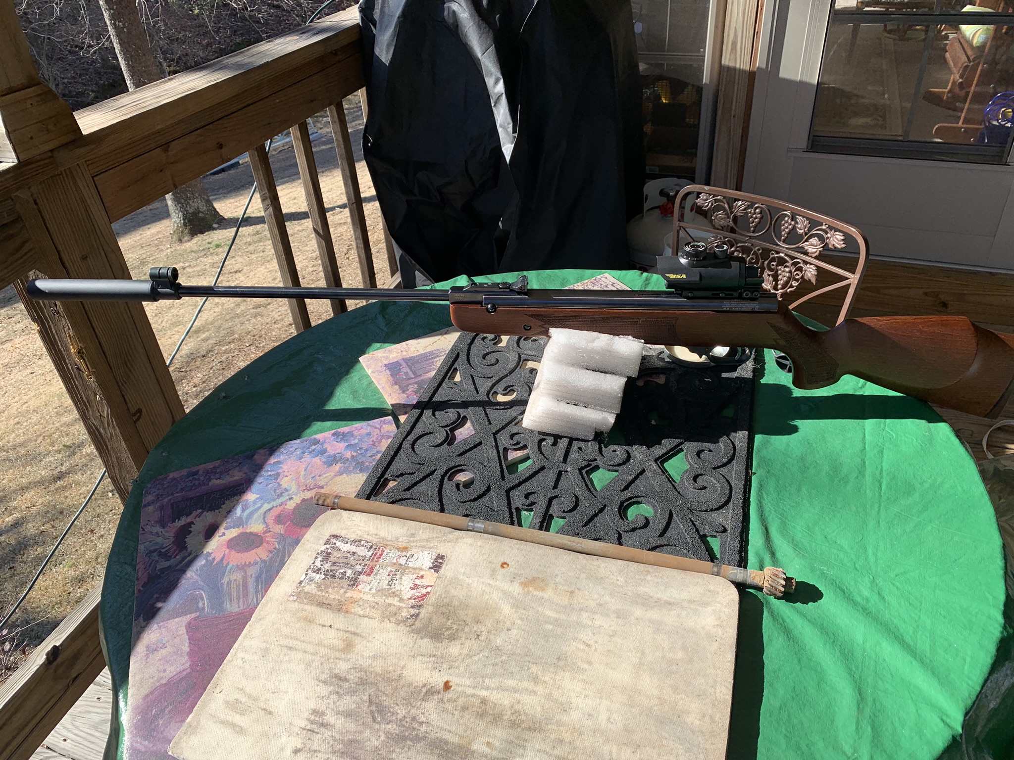

HW95L factory moderator connection works great and very solid.
They work fine. I have the Weihrauch slip on on my HW90 and a slip on from BSA on my Gamo Urban ( got rid of pickle). I have had no issues with any of them. You will need to tighten the allen screws holding it on the barrel from time to time as the shock of the weapon firing will loosen them. Some blue locktite will help this issue.
