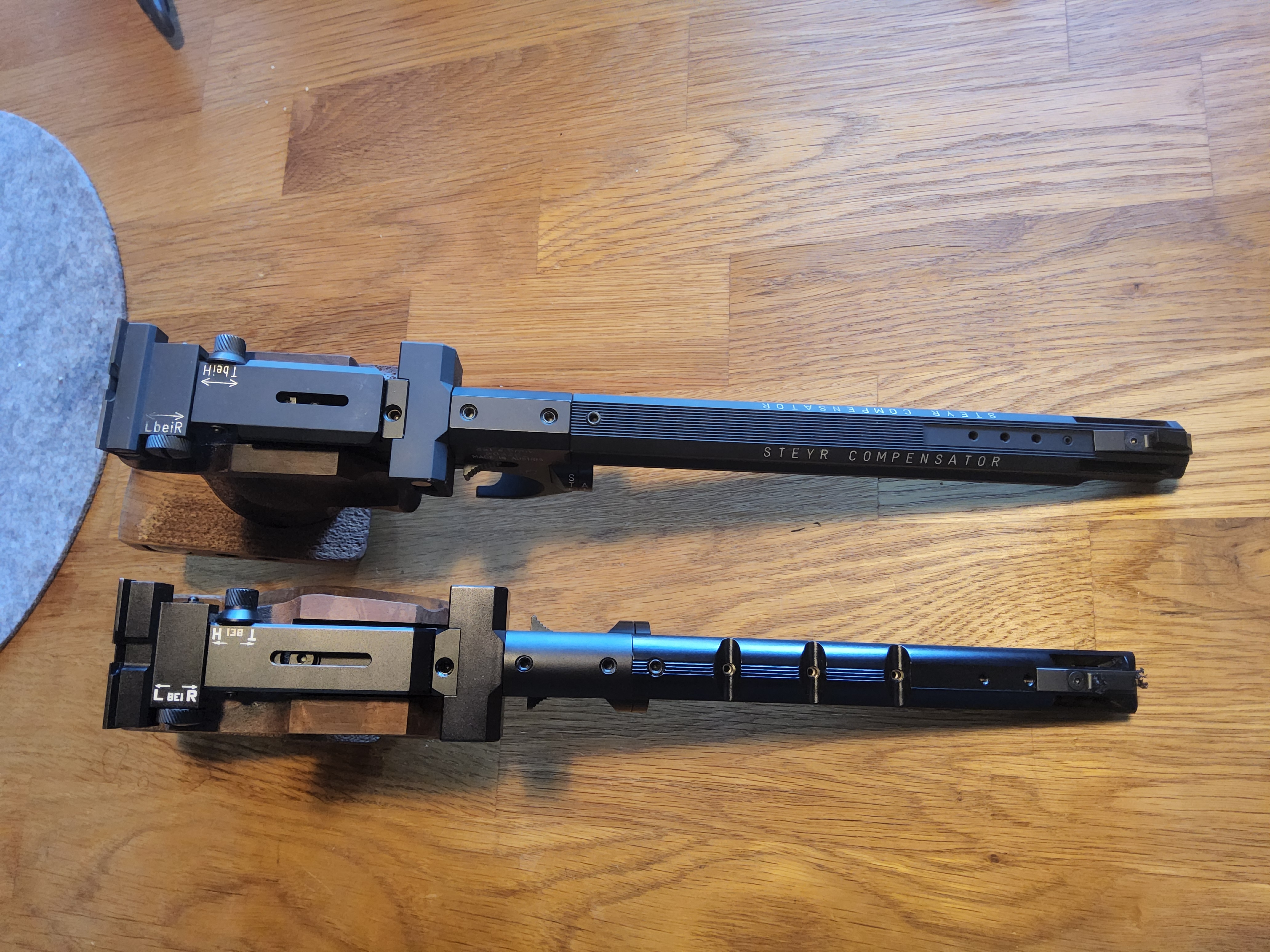

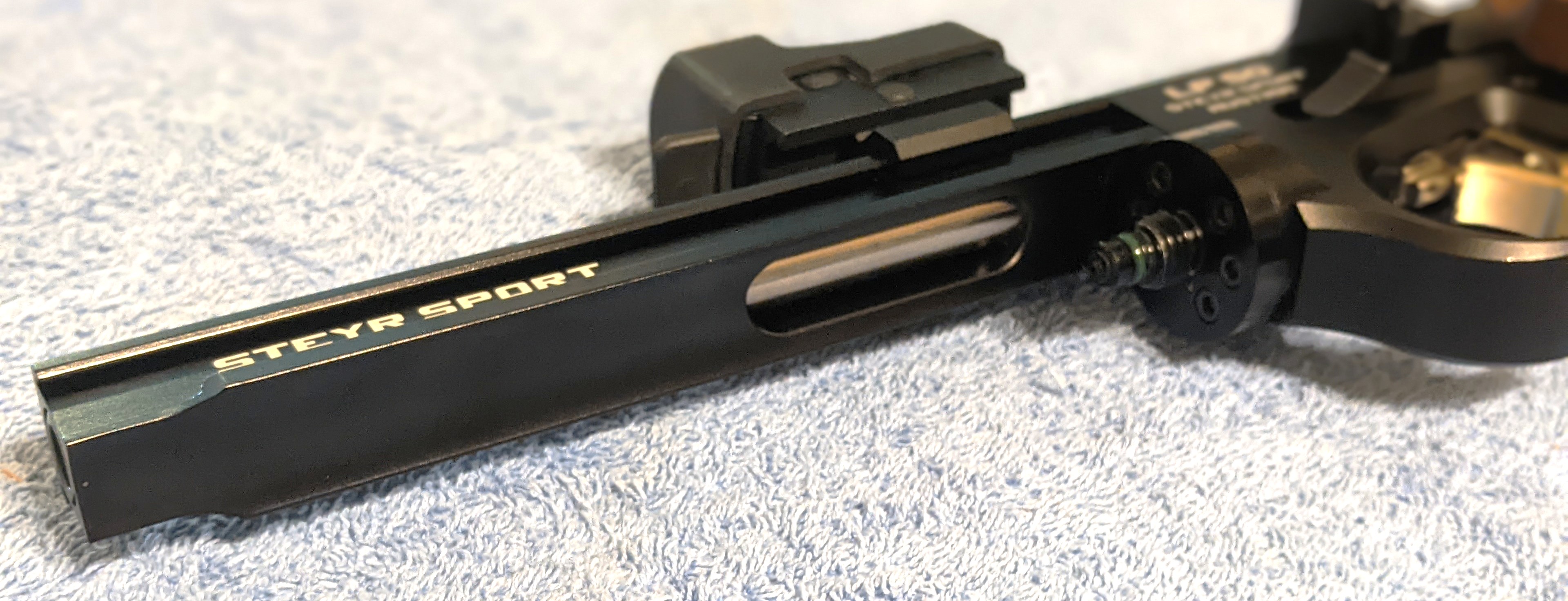

The shroud for the LP5 do not have these holes on the top, as the LP5 did not have the 3 compensator holes at the top of the barrel that the LP50 has (one of the very few technical differences between the LP5 and the LP50). And the LP5 shroud fits right on the LP50. Though I do not know if the LP5 shroud is available as a spare part any more. But worth a check?

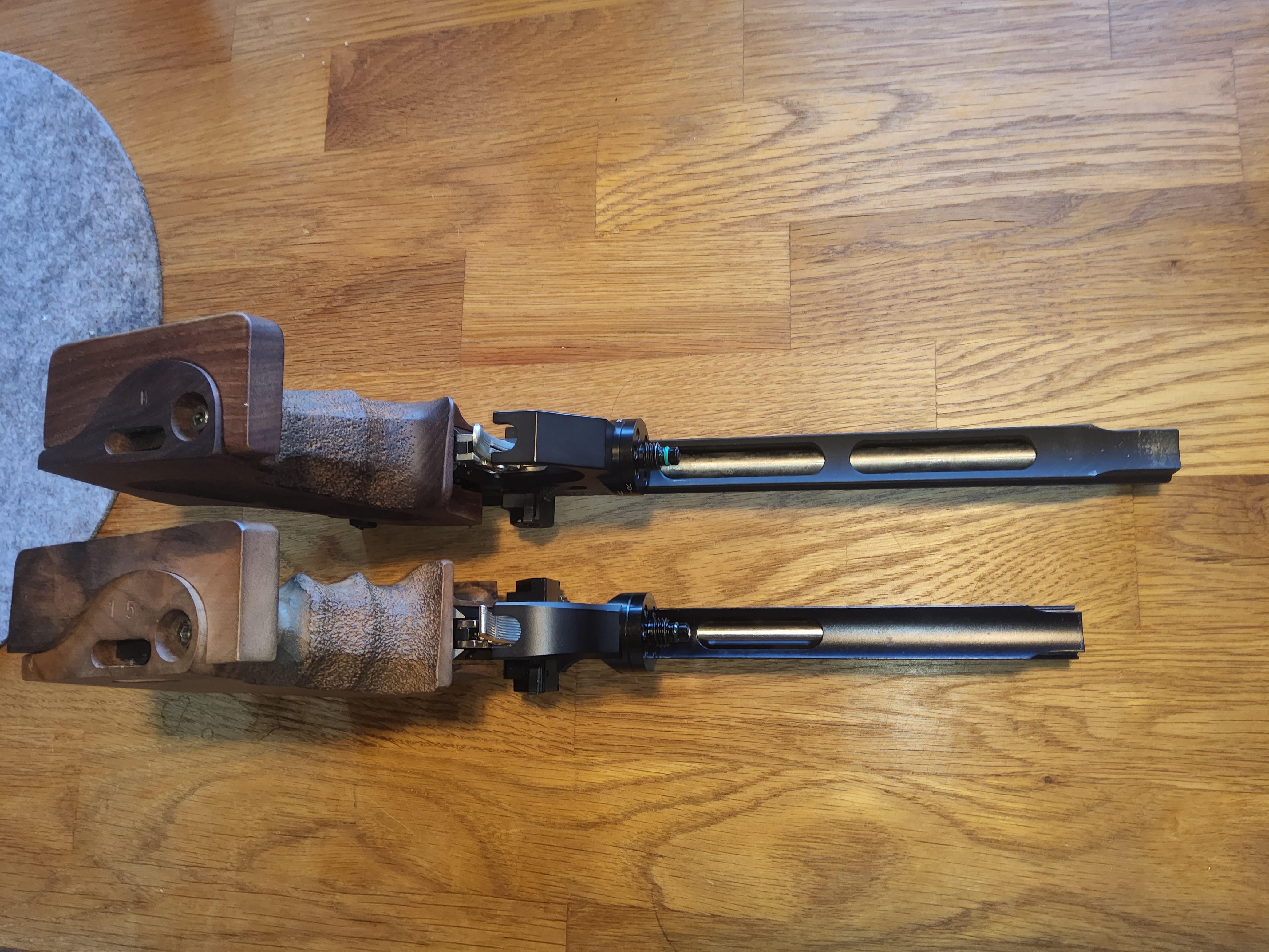

Does the LP5 shroud have the hole on the bottom of the shroud (above the air cylinder) like the LP50 has, or is it a solid piece of material?
Good point SAZ! I would think this would be a source for the sound to escape also, just like the ports on top of the shroud.
Helmet: Since you have both LP5 and 50, could you post pics of them side by side with respect to the barrel shrouds? Thanks!!
Reactions: SAZ
The LP5 shroud also has slots on the underside, but the gap between the barrel and the shroud is rather tight, and the sound has to go past some edges before it gets out into the open air. That slows down the speed of the air and dampens the sound. Not 100% optimal of course, but much better than the air escaping directly into the open air through the compensator holes. And remember that the 5-shot pistols will always make some noise because of the semi-auto action.
I'll post some pictures later today.

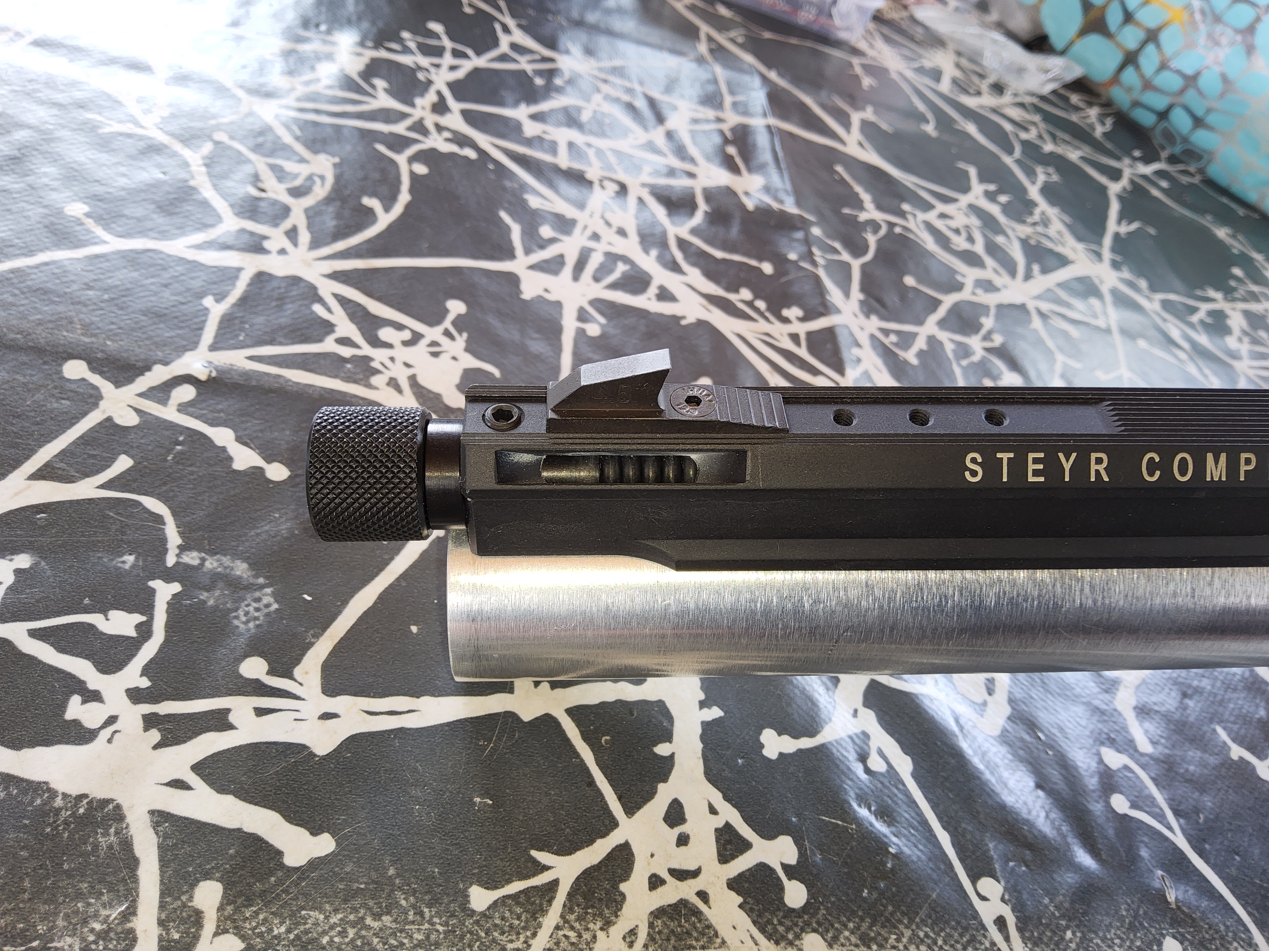

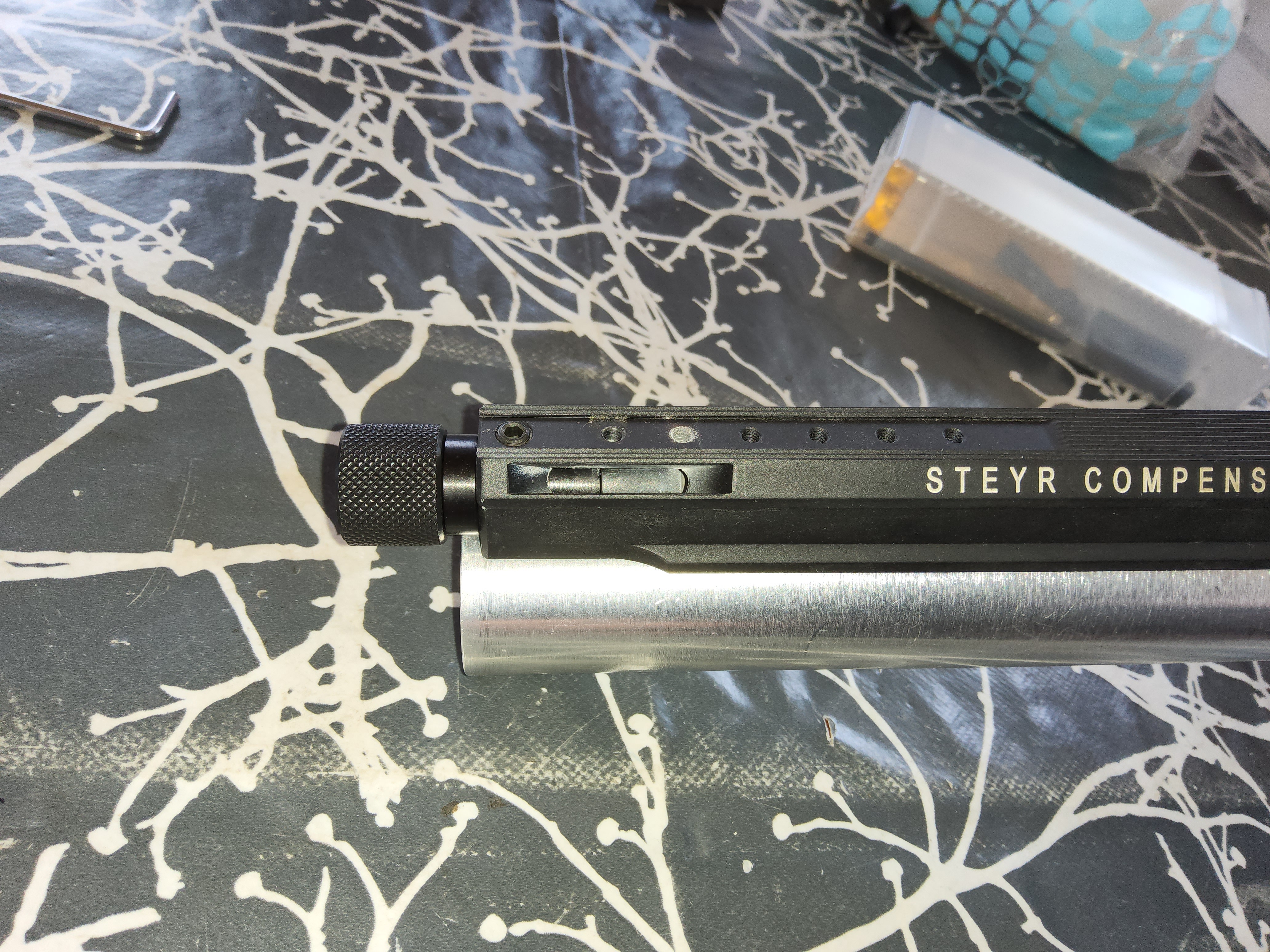

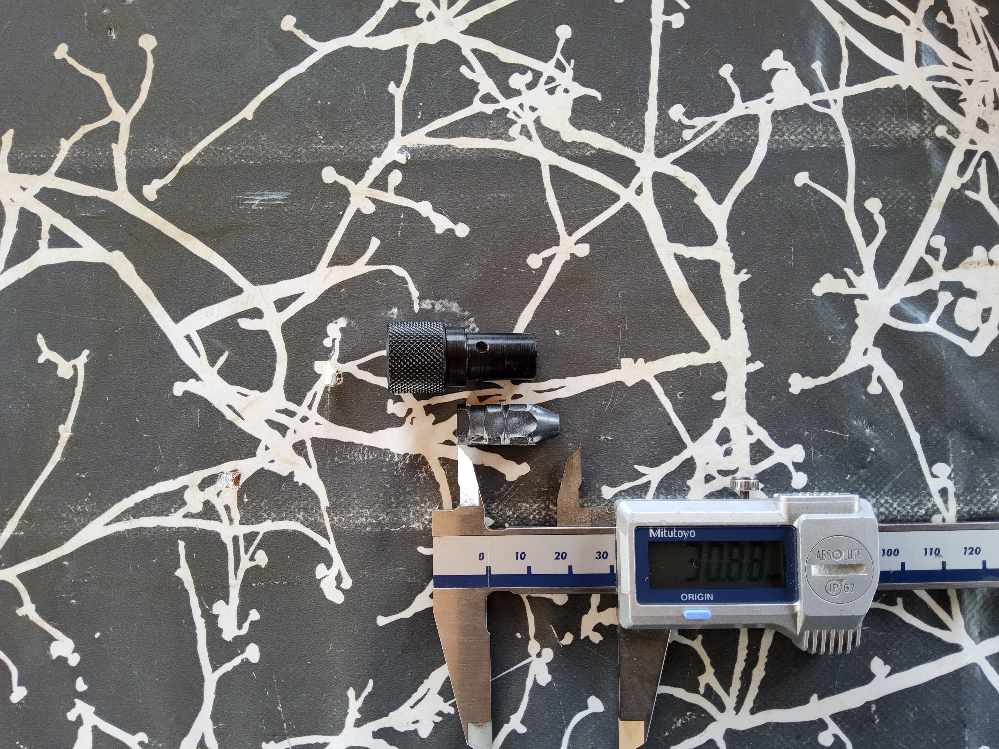

I saw a little more into this today, and it turns out Steyr did some changes to both the barrel, the shroud and the compensator/diffusor for the update to LP50. The result is that the 1/2"-27 moderator adaptor will not rest against the muzzle, by far. About 13-14 mm actually. The barrel outside diameter is the same on both LP5 and LP50 so it is possible to stack a row of o-rings or something to close the gap, but that is not anything I would have done. Sorry I was a little trigger happy on this. :confused:
Reactions: Gwelo

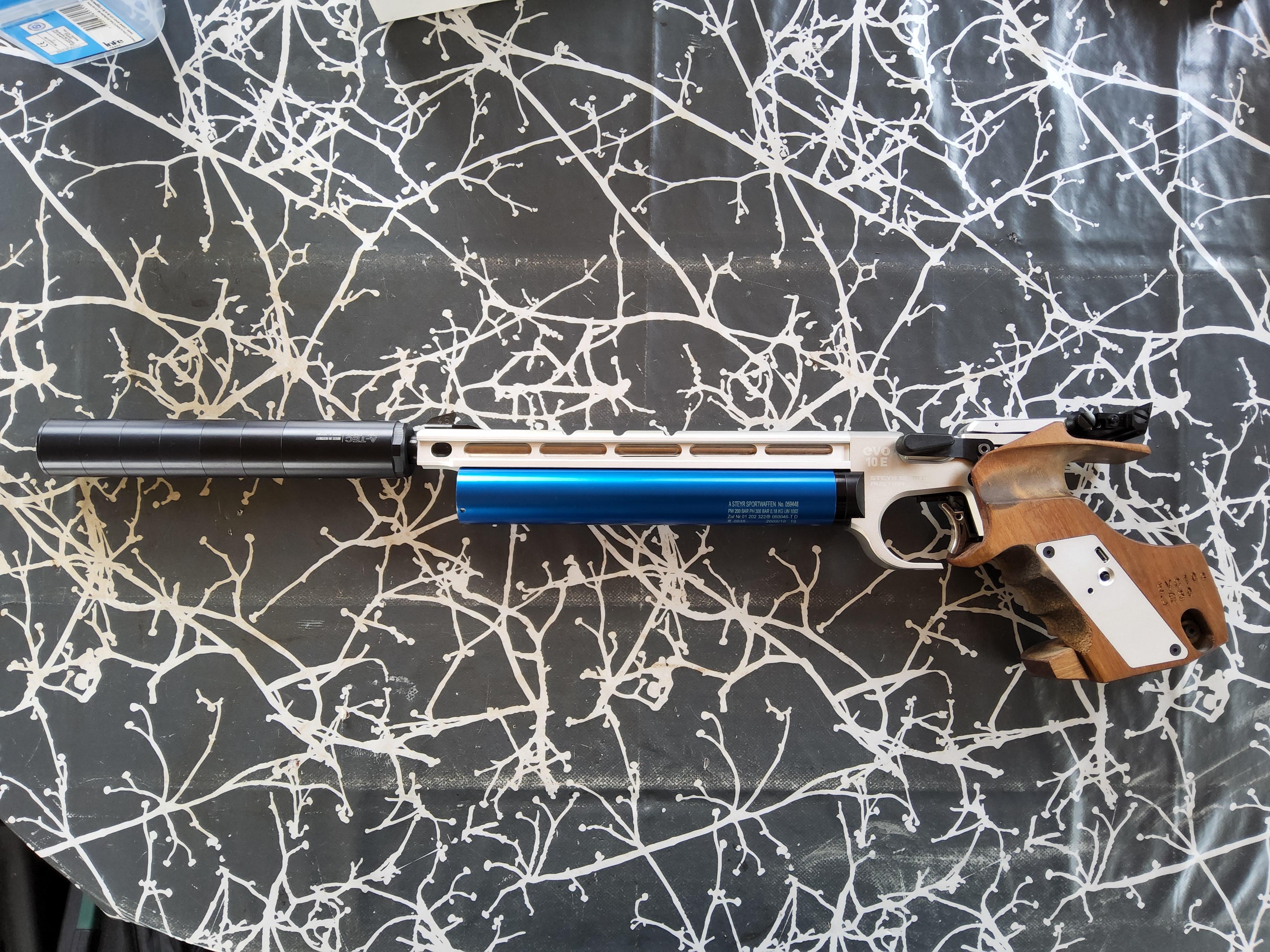

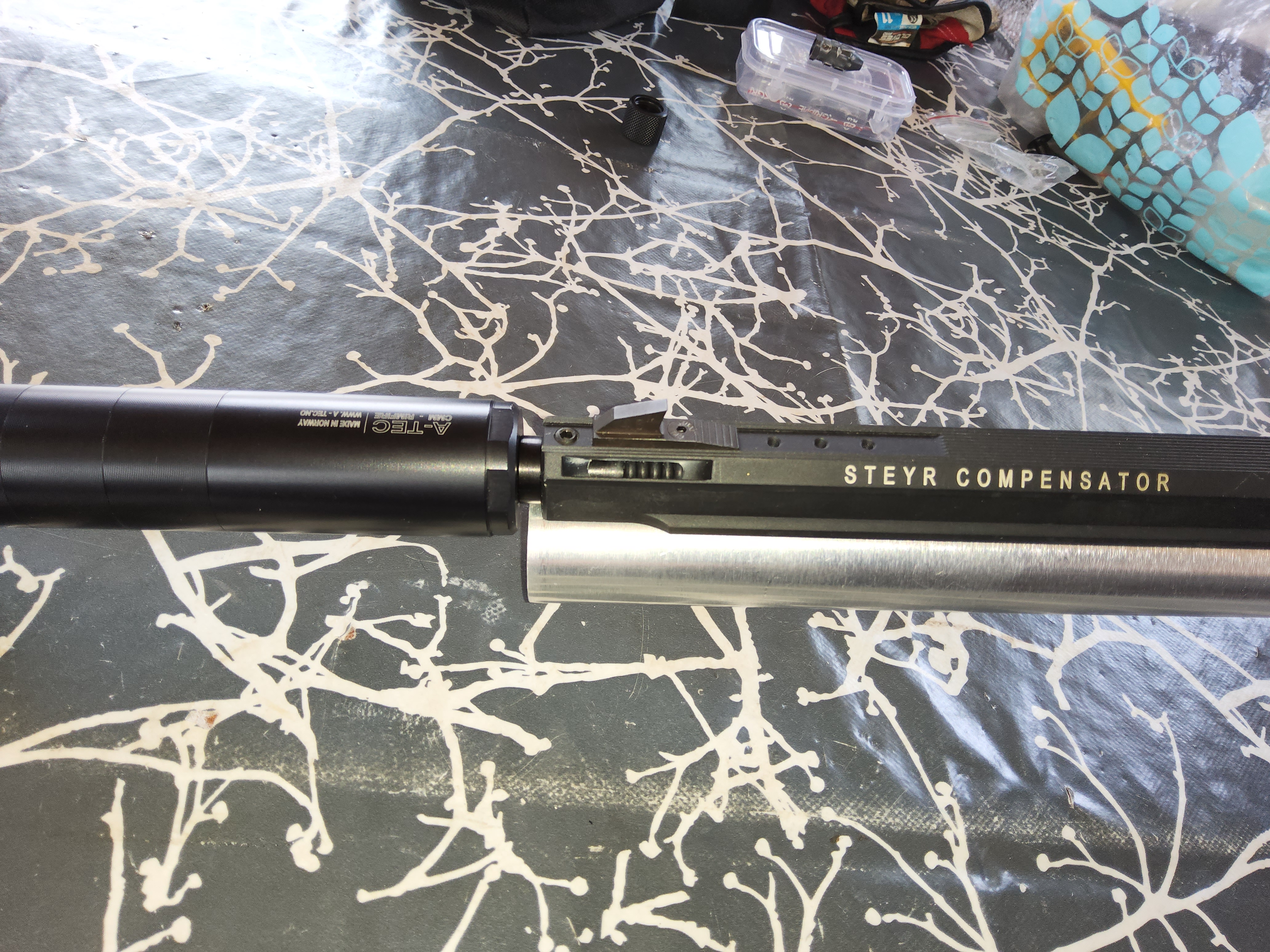

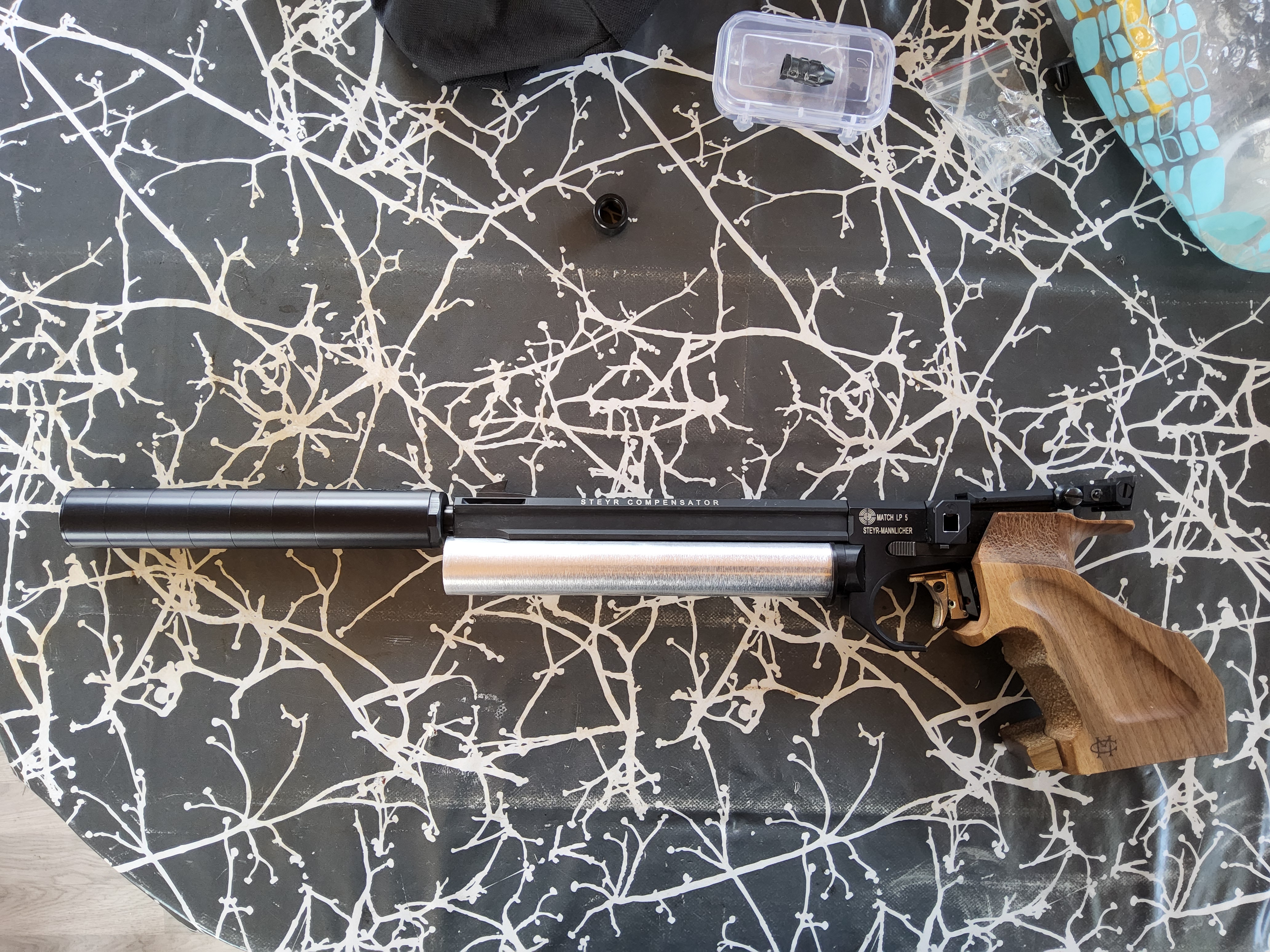

I did some testing with the 1/2-27 UNF adapter from Trajectron and a LP5 pistol today. I removed the compensator piece and pushed in five o-rings (ø6x3mm) before I mounted the 1/2-27 UNF adapter at the end of the barrel shroud. The five o-rings close the gap between the barrel end and the adapter end so there's no air (and sound) escaping the moderator. The semi-auto action still makes some noise, but the difference with and without a moderator is significant. The result was a 9,4 dB noise reduction: 71.7 dB with adapter and moderator installed, and 81,1 dB without moderator (factory setup). Remember that the LP5 does not have the three compensator holes on top of the barrel that the LP50 has.
The equipment used for measuring dB is a cheap Uni-T UT353, so the precision is not on a scientific level.
I moved the Trajectron adapter and silencer over to my Steyr Evo10e today, and shot some pellets with it for a quick comparison. The average for 5 shots with the Evo10e was 71.3 dB. The difference in noise between the LP5 with silencer and the Evo10e with silencer was 0.4 dB in favor of the Evo10e. And that is so small that it is negligible. Especially considering the 5 shot average and non-scientific measuring equipment.

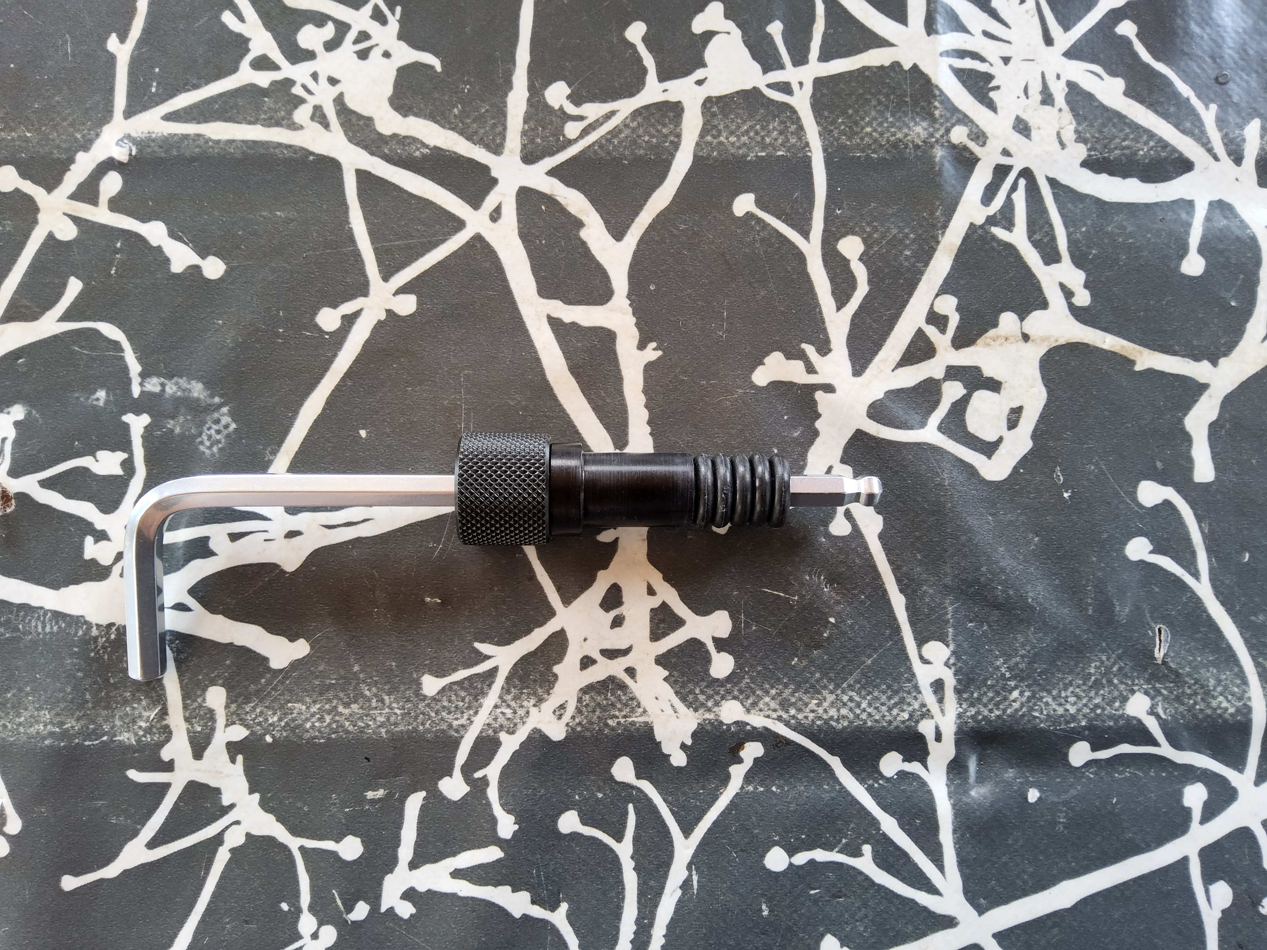

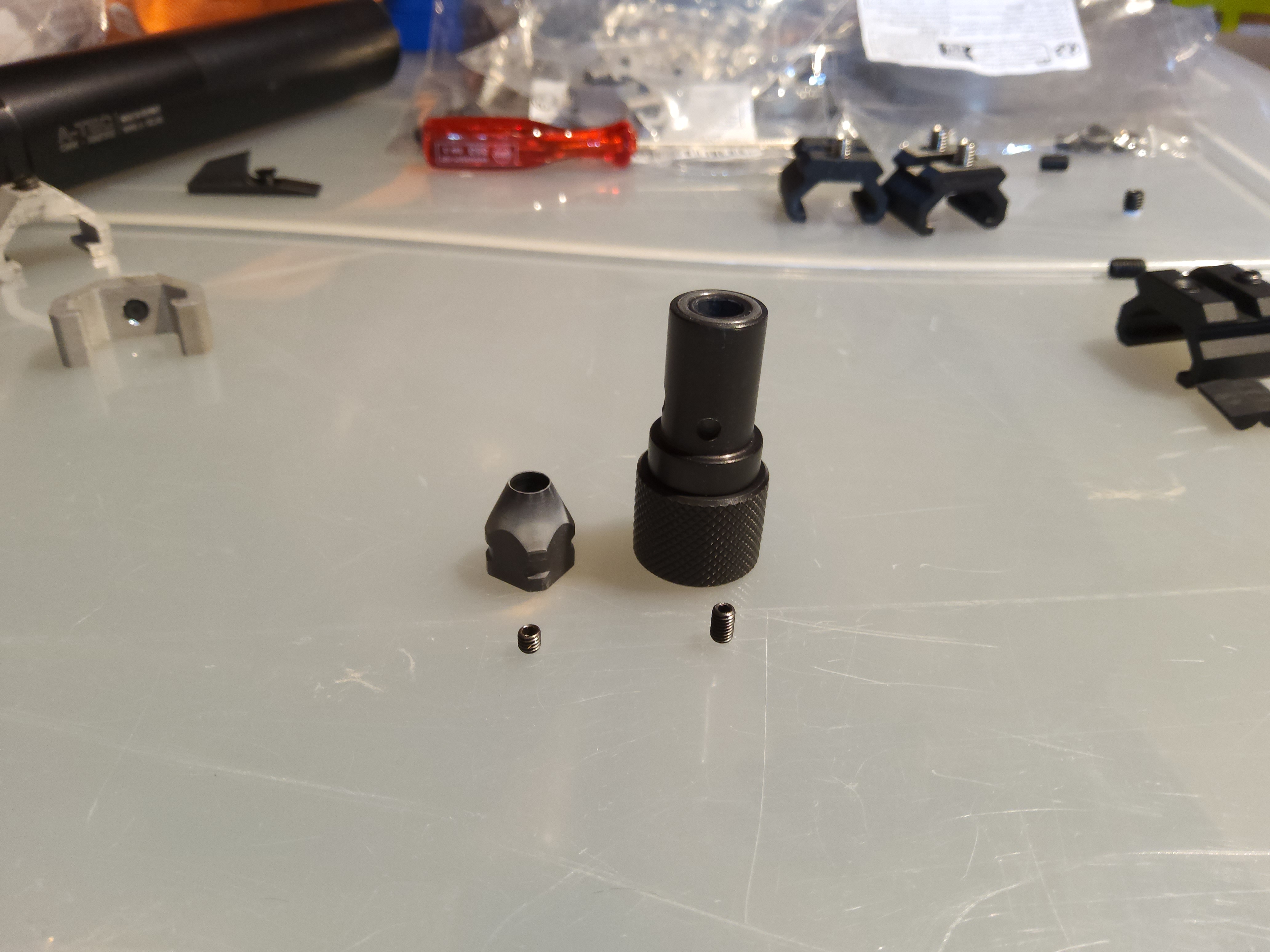

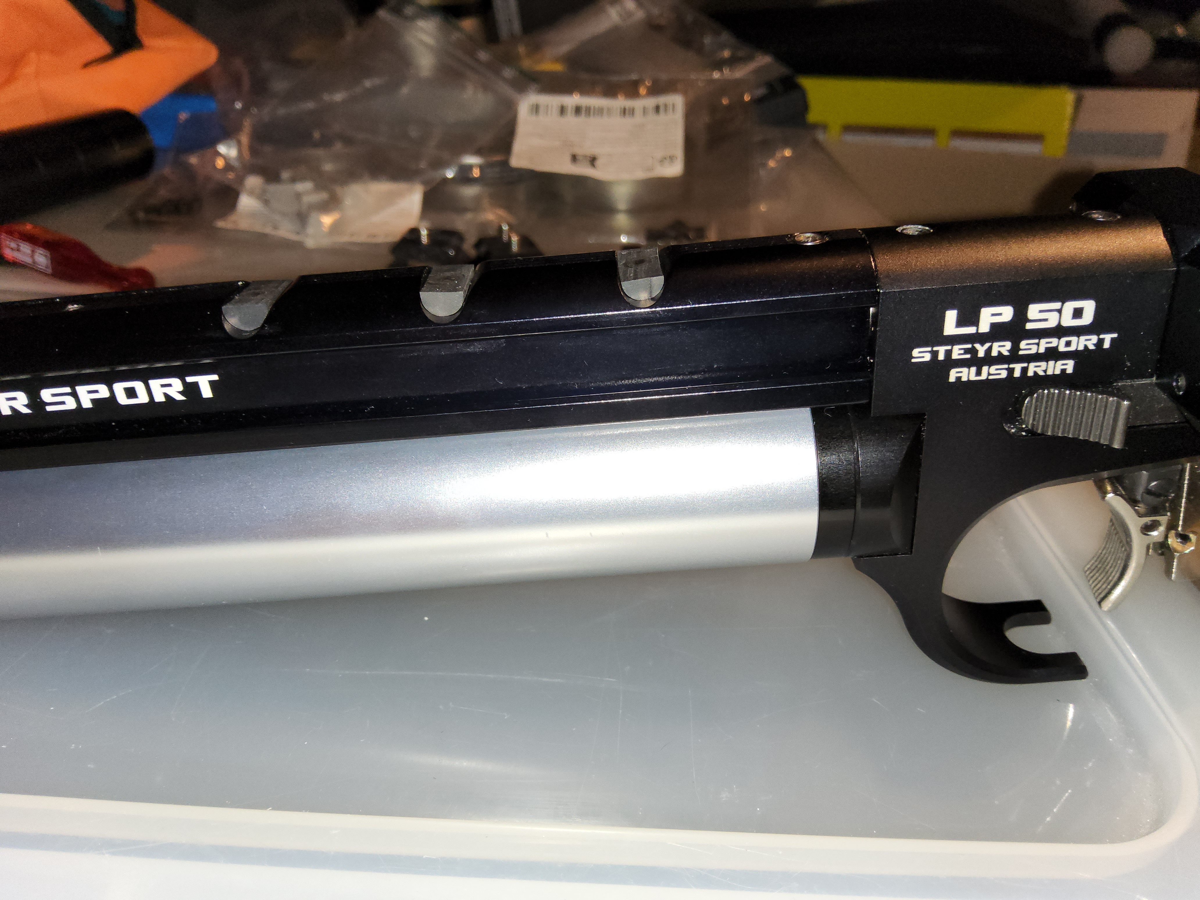

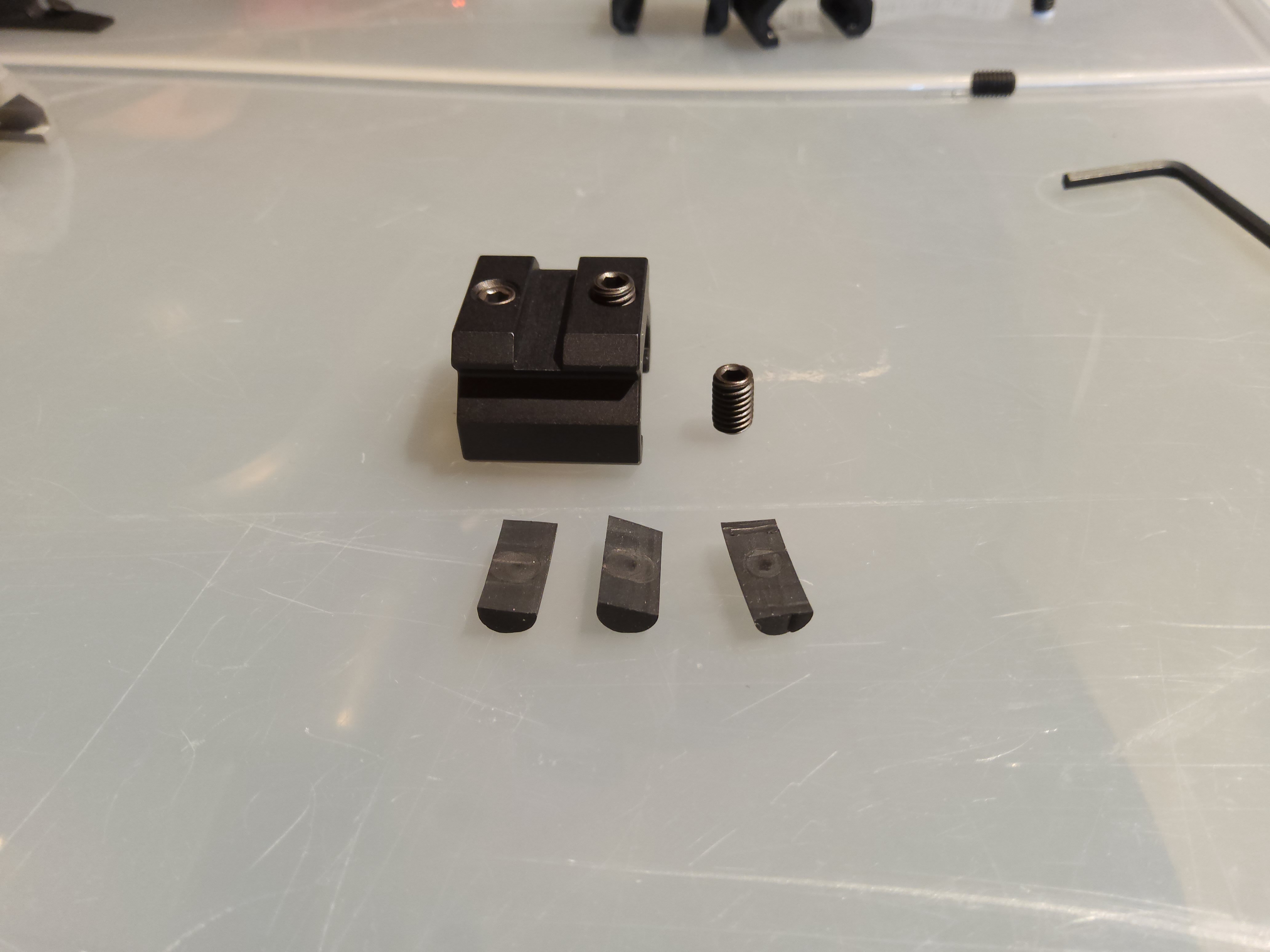

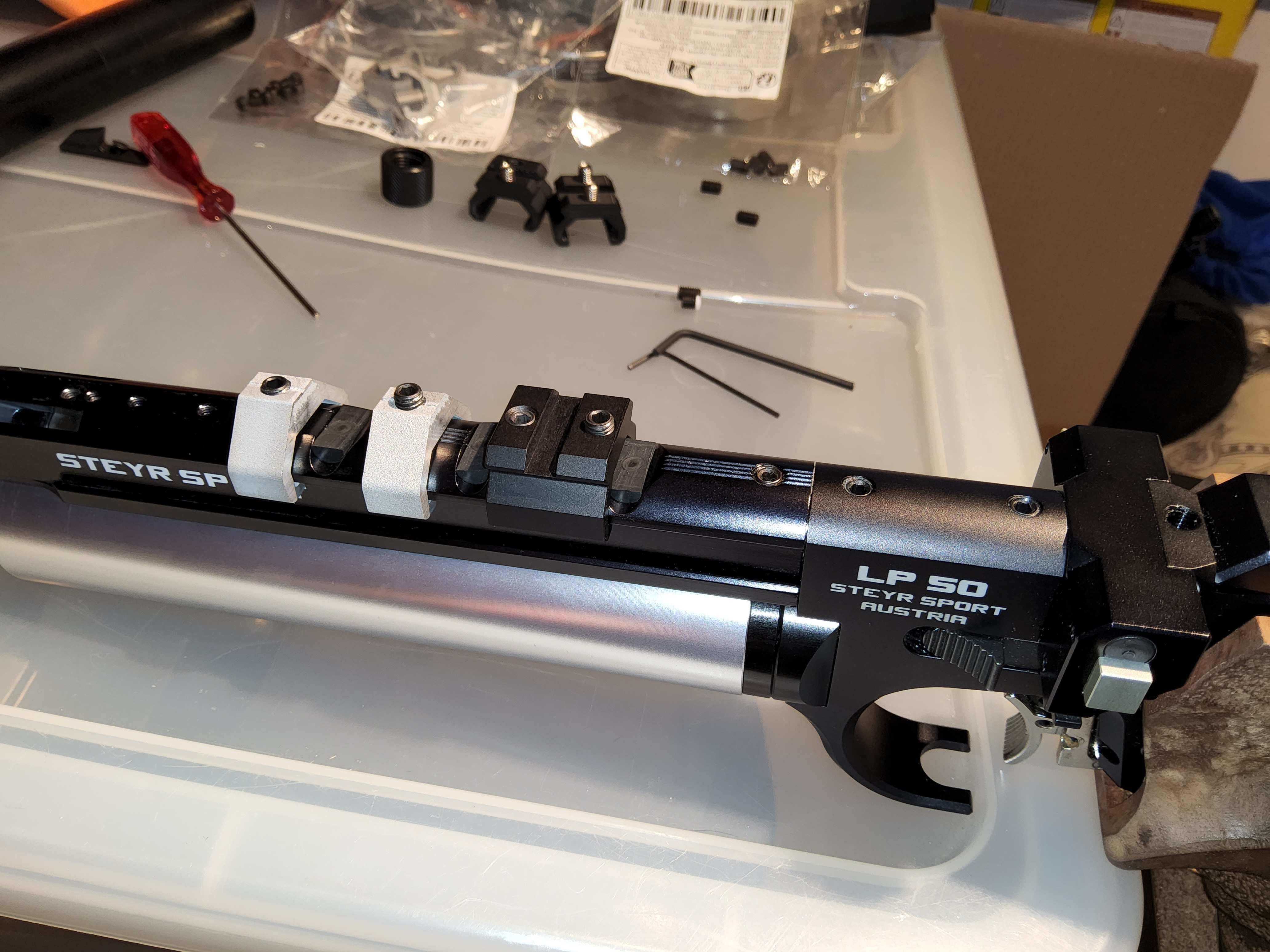

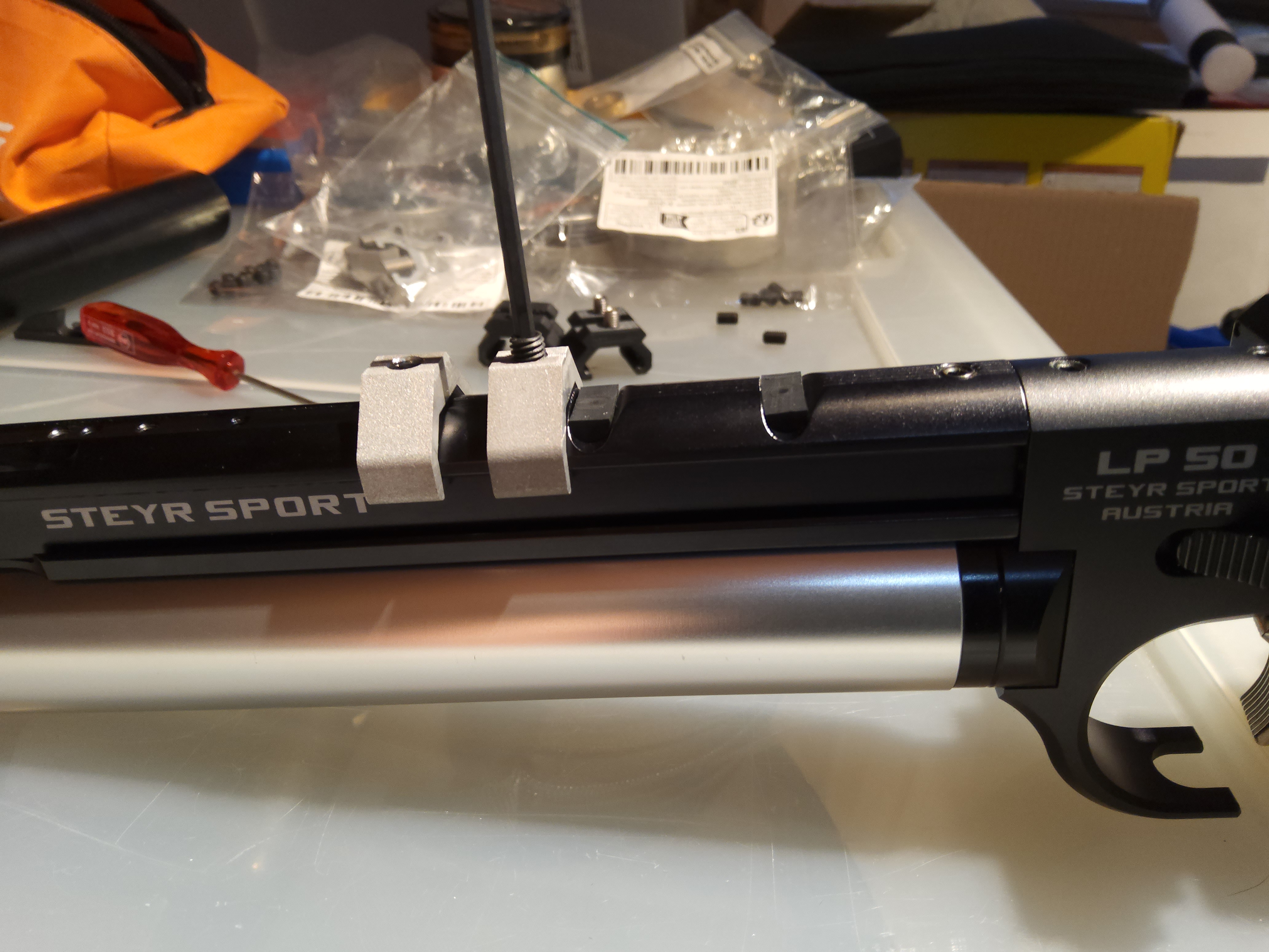

Now I've found some time find a way to seal the compensator holes in the barrel on the LP50. You need a 6mm (or 1/4") rubber cord and three Steyr LP Weaver rails (or similar ex. 3D printed rails).
Cut the rubber cord (preferably NBR90, but NBR70 will also do) in pieces of 13mm (1/2") length and then split them i half.
Replace one of the fixing screws in all three of the rails with an M5X8mm set screw (the set screw that holds the splited rubber cord in place.)
Replace the M3x3mm that holds the front compensator with an M3x5mm for better grip when the 1/2-20 adapter is installed.
Reactions: SAZ and Gwelo

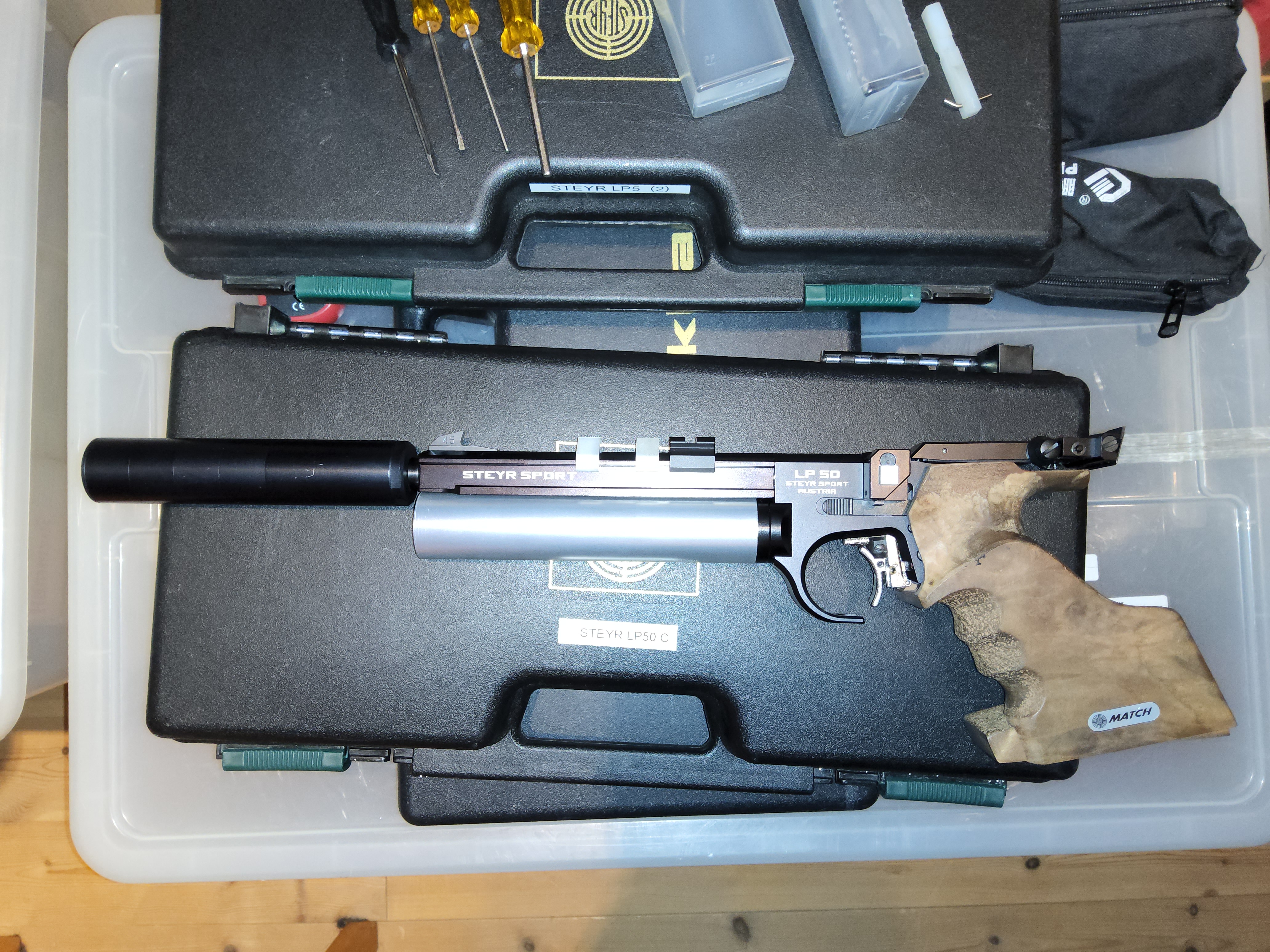

What I found though with my LP50RF was after sealing the upper holes you still have the big hole in the lower part of the shroud and maybe yours is different, but I found it still had a lot of noise coming out the bottom.

I guess you kan use 5mm or 6mm plastic beads also, but I didn't have anything like that lying around. I haven't got to the point where I can measure the noise yet, it's a very rainy weather in my area the moment.
My Steyrs also have slots in the bottom of the barrel shroud, but the gap between barrel and shroud is only a few hundredths of a millimeter and the sound has to change direction several times between the barrel and the shroud before it reaches open air, and that in itself is sound dampening. But I haven't tested this properly yet, so I don't really know how much noise escapes through the slots on the underside of the barrel shroud. But I take your word for it.
Yes the Steyr Weaver rails are disproportionately expensive, I got a colleague to Wire EDM a few for me, but I have 3D printed a couple of variations also, that I will test when the clouds break open, the sun comes out and it dries up again.

The previous model (LP5) had a barrel and cover without the 3 comp holes on top. However, a difference in barrel and cover length between the LP5 and LP50 means that the 1/2-20 adapter does not fit directly, but 5 pcs. ø6x3 o-rings between the 1/2-20 adapter and the barrel muzzle fixes that problem. The new LP50 Action seems to come without the comp holes in the barrel, and with a 1/2-20 adapter already installed. I don't know if the Action barrel is a direct drop in, but I guess it is. Another issue is that Steyr pistols and parts are utterly expensive, so I feel it's worth putting some effort into this. And besides, it's fun to tinker around with this. :)
