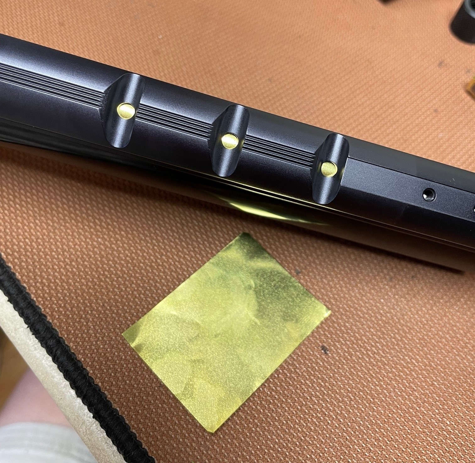

I went a step further and took this thin brass sheeting (a little thicker than aluminum foil) and used a little 3M spray adhesive on it to stick it down over the 3 ports drilled in the upper barrel on my LP50-RF. The clearance is so tight between the "shroud / barrel surround" and the barrel that's the only thing that would fit and still let me slip it back on.

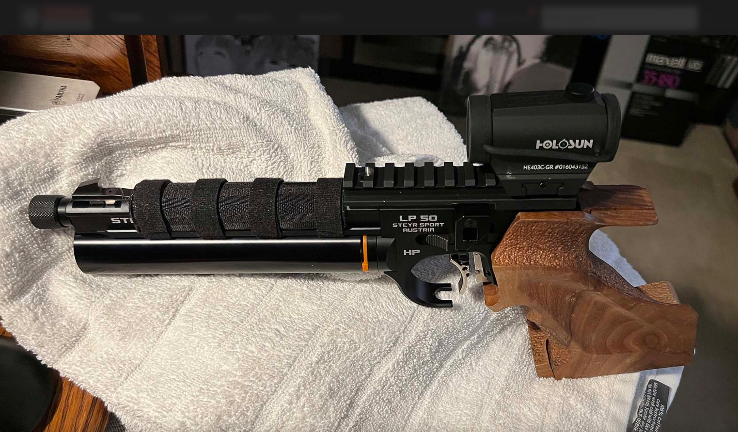

I couldn't use something like @stoutblock is showing in his picture because there isn't enough clearance between the air cylinder and the bottom of the "shroud / barrel surround" for the velcro straps to pass through. VERY tight clearance on mine.
Anyway, it does block off the air from escaping but the pistol, but, even with a Weihrauch moderator on it is still louder than I'm comfortable with for "backyard friendly".
For a pistol that's tuned to 4.8 fpe, it sure lets out a heck of a crack when you pull the trigger.
The thickness of the Velcro straps I use is quite thin (the photo only shows where it is doubled up). Although the fit to the cylinder is snug, it does not hinder the cylinder’s installation or removal in any way. I like your method also but a more permanent solution which I wanted to avoid. Even though mine is the HP version, when combined with a STO Falx I find it easily quiet enough for back yard use.
I used some Dynamat material attached to some Ballistics cloth and wrapped it around the barrel with small Velcro straps. Works great to snuff the ports. View attachment 504202

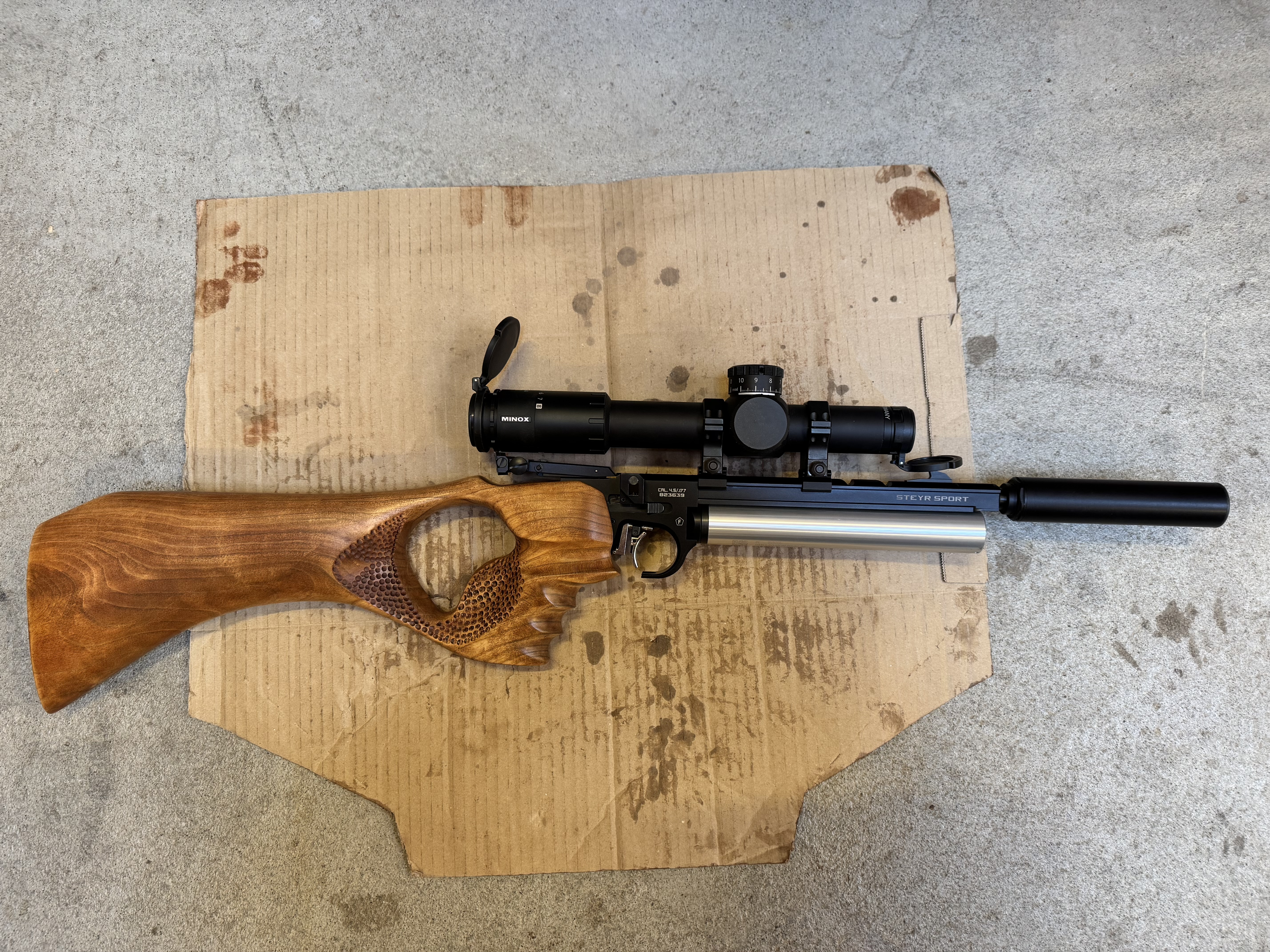

If that`s the case, I probably order the HP version in stead of waiting for the "Action"-version to come out. Any how I am not interested in the butt stock. I bought my RF-version from Krale. Maybe they know if the new barrel cover is available. ...
GT, very nice thumbhole stock for your RF!
Did you inquire at Krale as to the availability of the barrel cover?
No I did not. I saw the release on Steyrs website, and Krale did not have the Action or any of the new parts listed, so I decided to build a stock for my RF. With the silencer the bark is acceptable, and with two single rails the pistol now is complete so to say.
