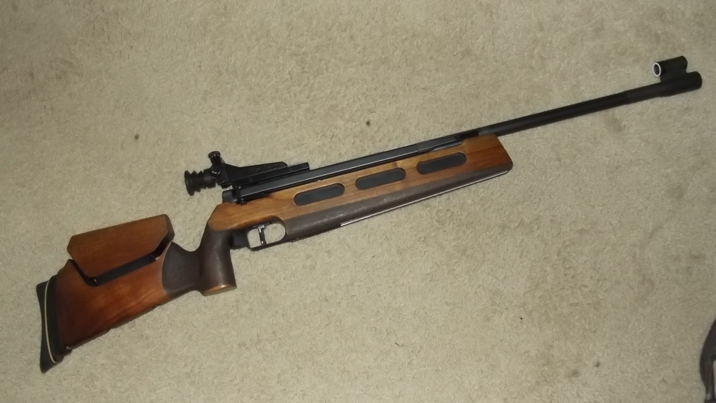

If a 10 meter rifle? ....... DIANA 75 with the RWS a marketing brand for the USA market.
This my personal RWS / DIANA 75 HV model ... all the 75's mechanically are the same, stocks and sights differ tho.
parts hard to fine not really if you know where to look but there not here in the states

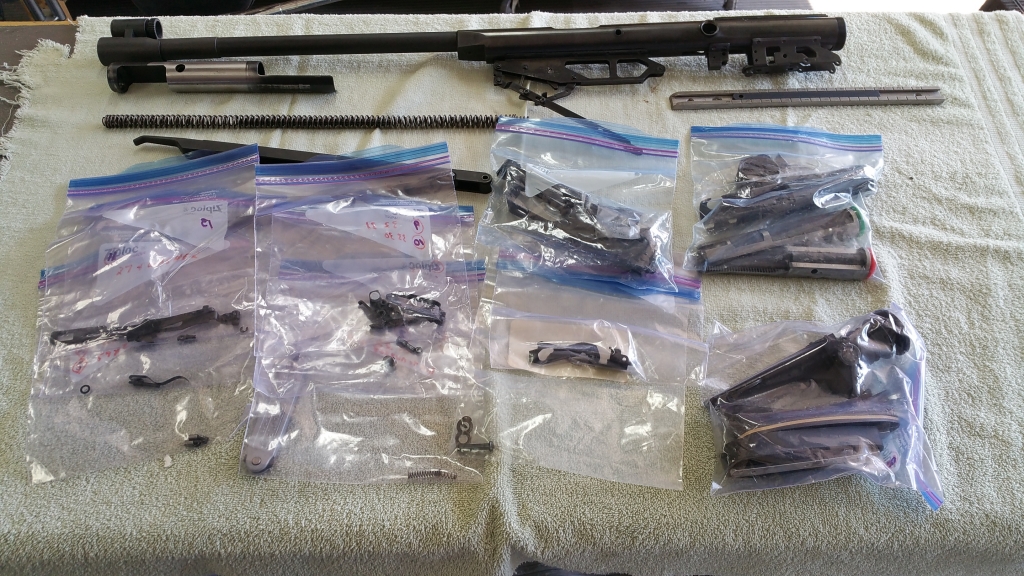

I have as MH, rebuilt many and owned many. Here is one Joe R sent me! This was a rebuilder's nightmare. Oddly all
 parts and pieces were there💀 This was a Condor version . Same gun as the D75.They were all not branded DIANA. IN those days there were several importers as in the FWB 300/300s.
This gun was for real torn completely down to the bone. Try one sent to you like this if you want a challege.lol😱
