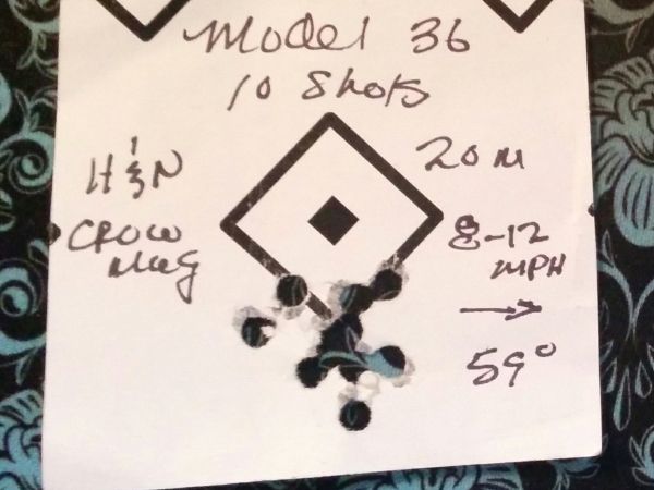

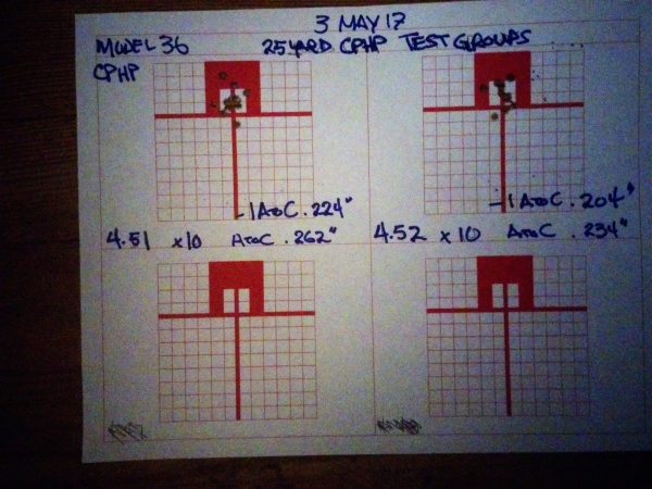

Last fall I was testing pellets and I set aside a tin of CPHPs that were shooting horribly. They wouldn't hold 1.25" at 25 yards reliably on a calm day. The rifle liked (may still like) H&N FTT's but I don't have any right now. At that time it shot this group with H&N Crowmags at 22 yards.
Which is probably why I still have some of those left. Never the less when it was holding a dime at 22 yards with Crowmags it was not holding 1.25" at the same distance with the CPHPs, the EXACT same tin of CPHPs which I tested today after I got it back from John.
Clearly he made a difference! Mind you that was in a 5 to 15 mph gusty wind from 3 o'clock. So yeah, I'm happy.
