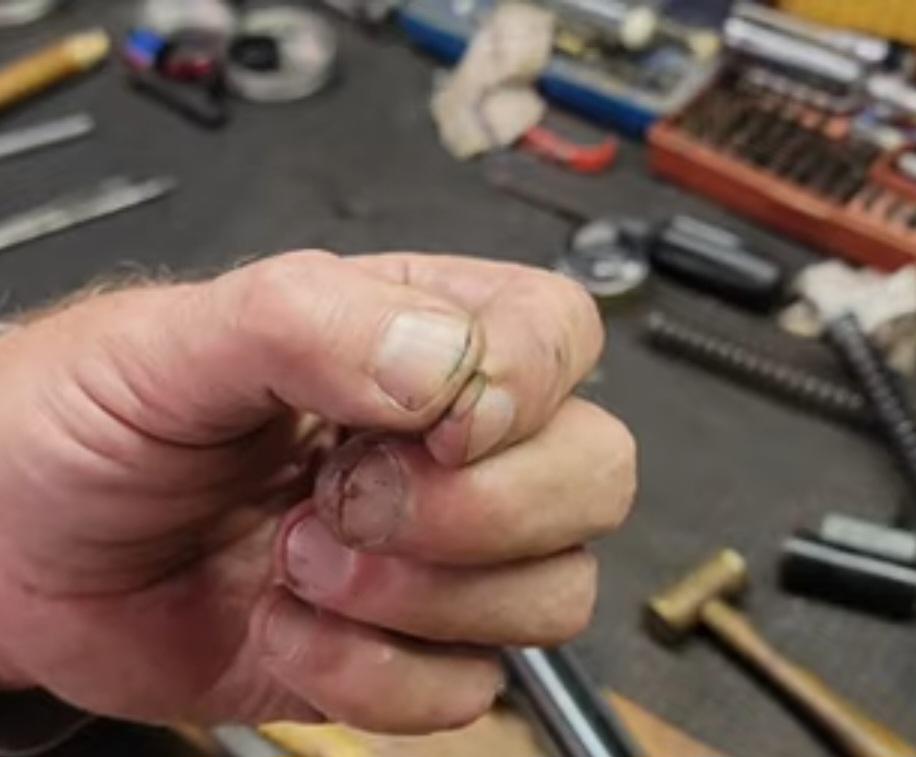

I took it to the 50' smallbore range a bit ago.Shooting with the irons it shot pretty well considering a suspect sight picture.I had played with spring length and made a tophat and a tighter rear guide and after a bit of tweaking I got it to just Under the 12 fpe I was looking for.
This one is a trail plinker and I didn't need power,I wanted easy to cock and quiet.
