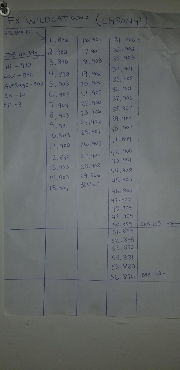

Dont know what mk2 you shooting buddy
but I have mk2 compact and jsb 25.39gr flaying 890 making one hole on 50yards
try lighter pellets maybe that help
in my opinion mk2 compact not like 33.95gr
