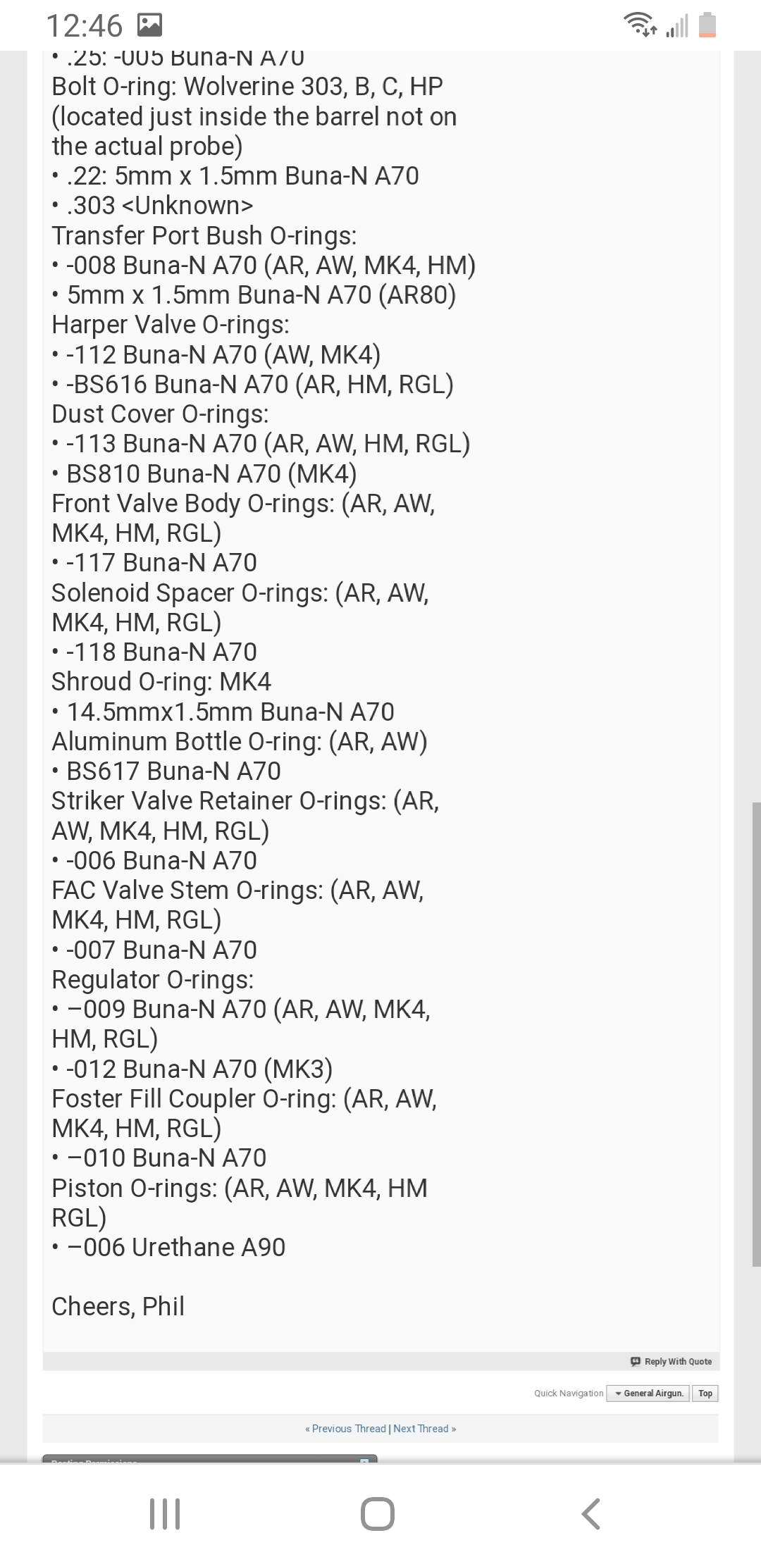

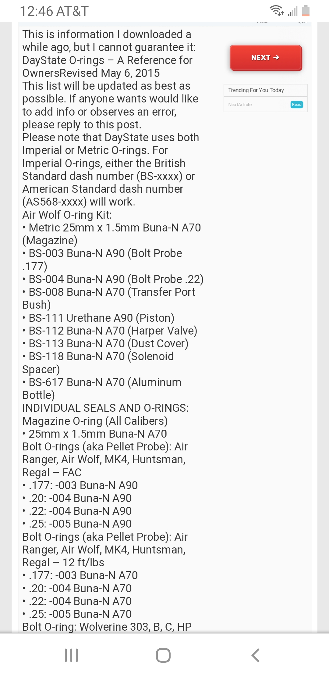

When I was looking for sizes for my MK4, I found a listing on AirgunsBBS.com . I'll post the screen shots. I did order a complete set from AoA but also purchased some separately to have extras for the bolt probe seals. Mine was leaking at the front plug air tube seals.
Thanks Phil, most companies will publish oring sizes, with Daystate it’s a big secret. I didn’t want to spend $30 for a dozen or so from AOA, and Daystate wanted to charge $80 to ship overseas. There are some companies in England that are reasonable. I figured I could always measure them with my calipers as I pull them off. Rick
