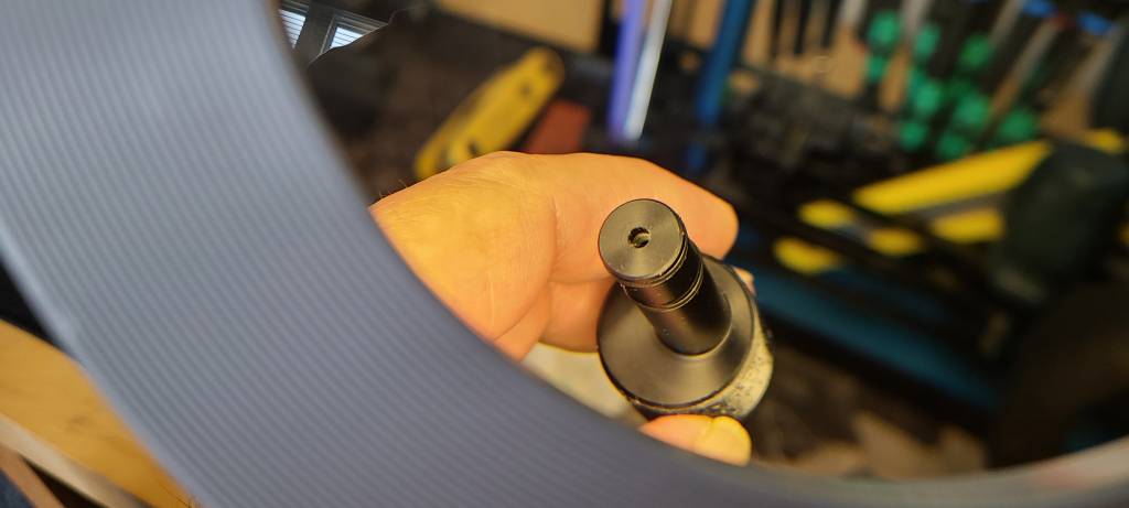

I am noticing some wear on the white "oring thingy" (B25.2) inside PP End Cap,
I remember I could not find anywhere this white PUR90 oring, but in my eyes look more like a sleeve or bushing and most likely some teflon material (or silicon or similar ?? ). Or there are two pieces of B25.2 inside?
I have a same size oring (B25.2) in NBR90 a full bag. Would that rubber work over a prolonged time and under heavy load :) ?
Last year I made the peek valve poppet and I remember high polishing the long valve rod for a purpose of minimizing any friction between parts, but still that white oring shows some signs I don't like.
If I could pull the original out in a decent way...
Thanks, I sent an email to Travis if he can give me some from he's Service kit. Also emailed oringsandmore to advise for material.
For now I will just leave it there inside a pocket, tomorrow a friend of my will rework the peek valve poppet on a lathe.
{This was my mistake designing the OD 9.1 mm instead of 8.1 mm. I would never notice a difference if I would stay with pellets, but just recently I converted the Impact to shooting slugs and here it shows for first time that the air path is restricted.}
