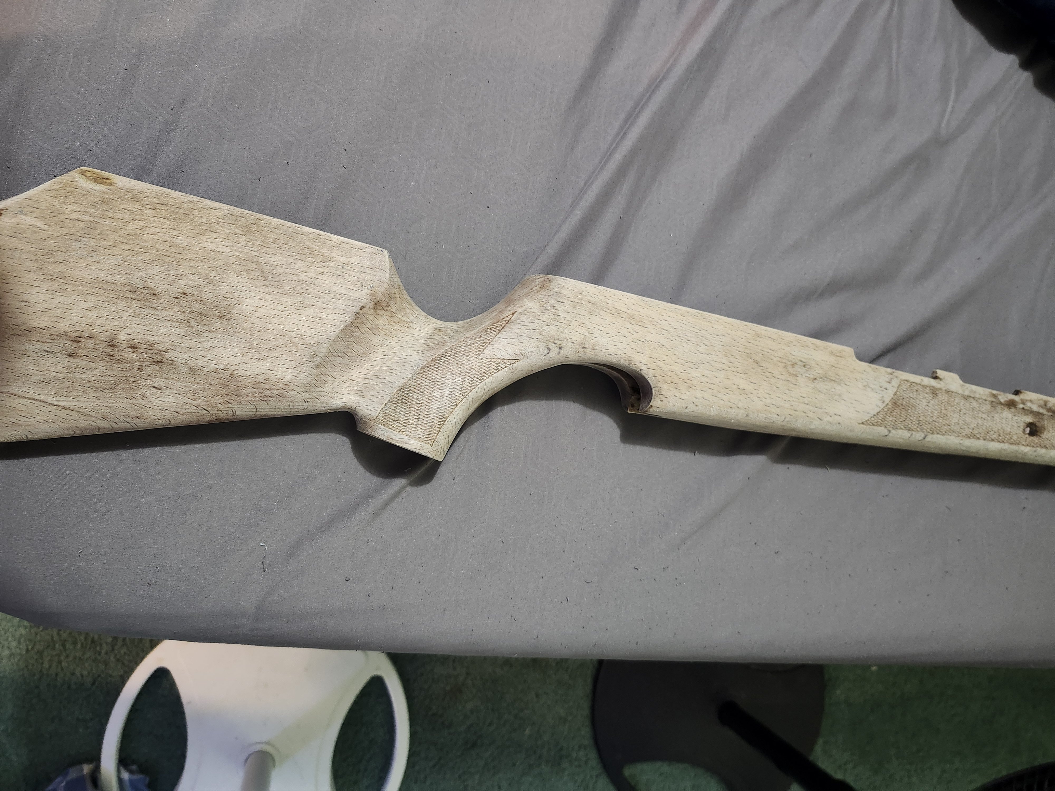

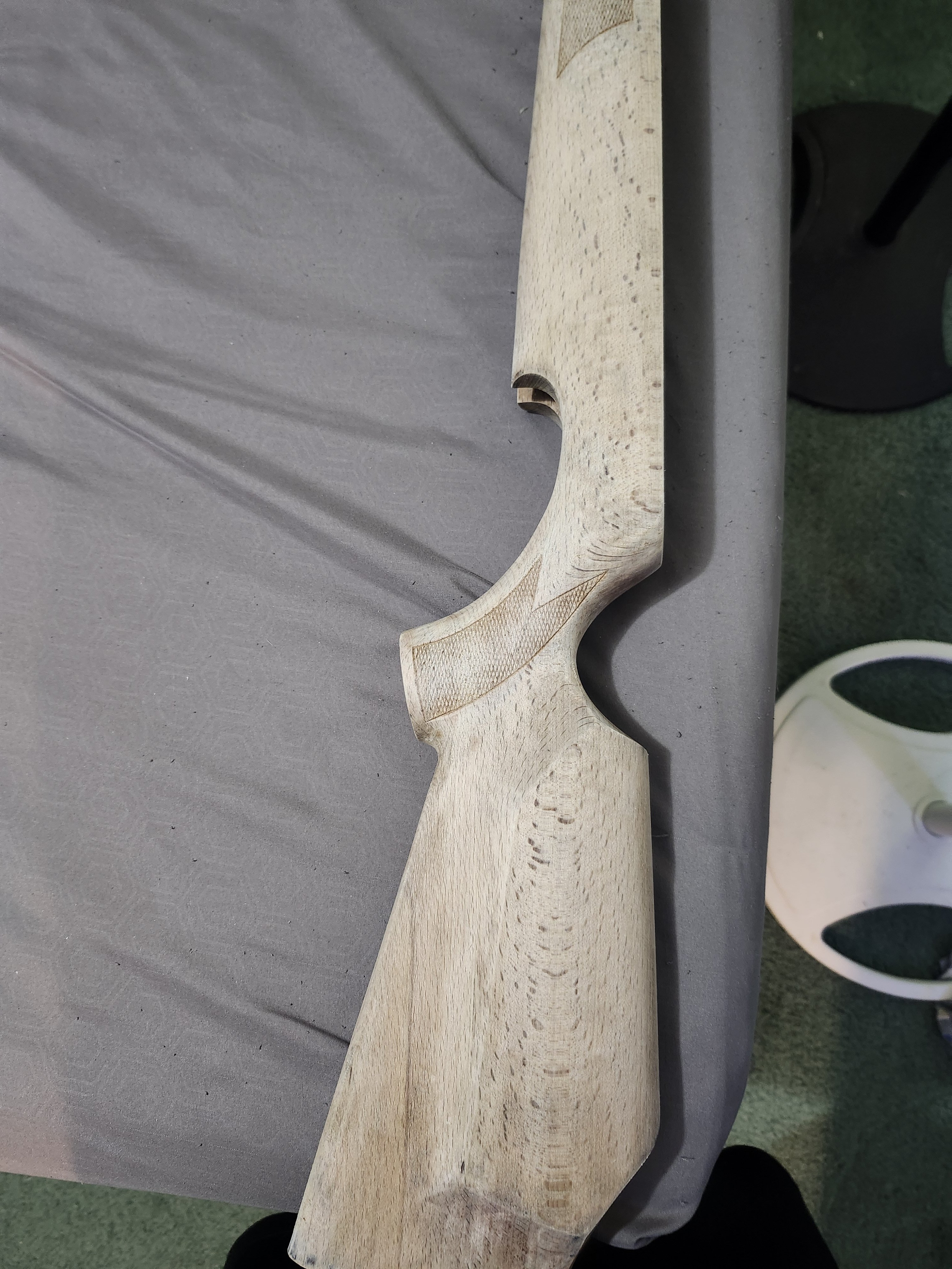

Refinishing dads beech stock i think his is the mk 1 or 2. Beech is a pain in the azz to stain and i have some danish dark walnut oil and i am going to try it mixed with oil artist paint in cocoa brown and crimson red and hope the grain doesn't do that dark crap. I also have some wood die and mineral spirts and see if that will work. I have used rit dye before with sucess. Guess we will see.

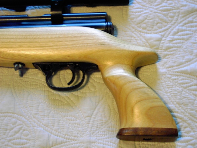

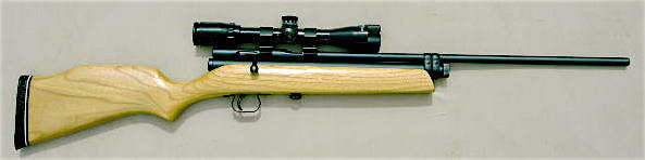

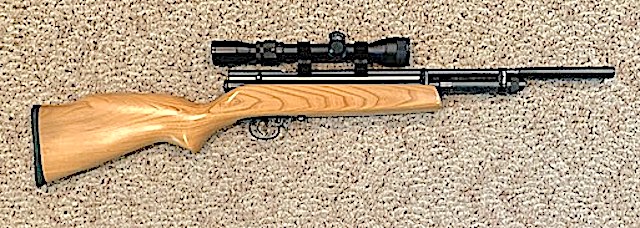

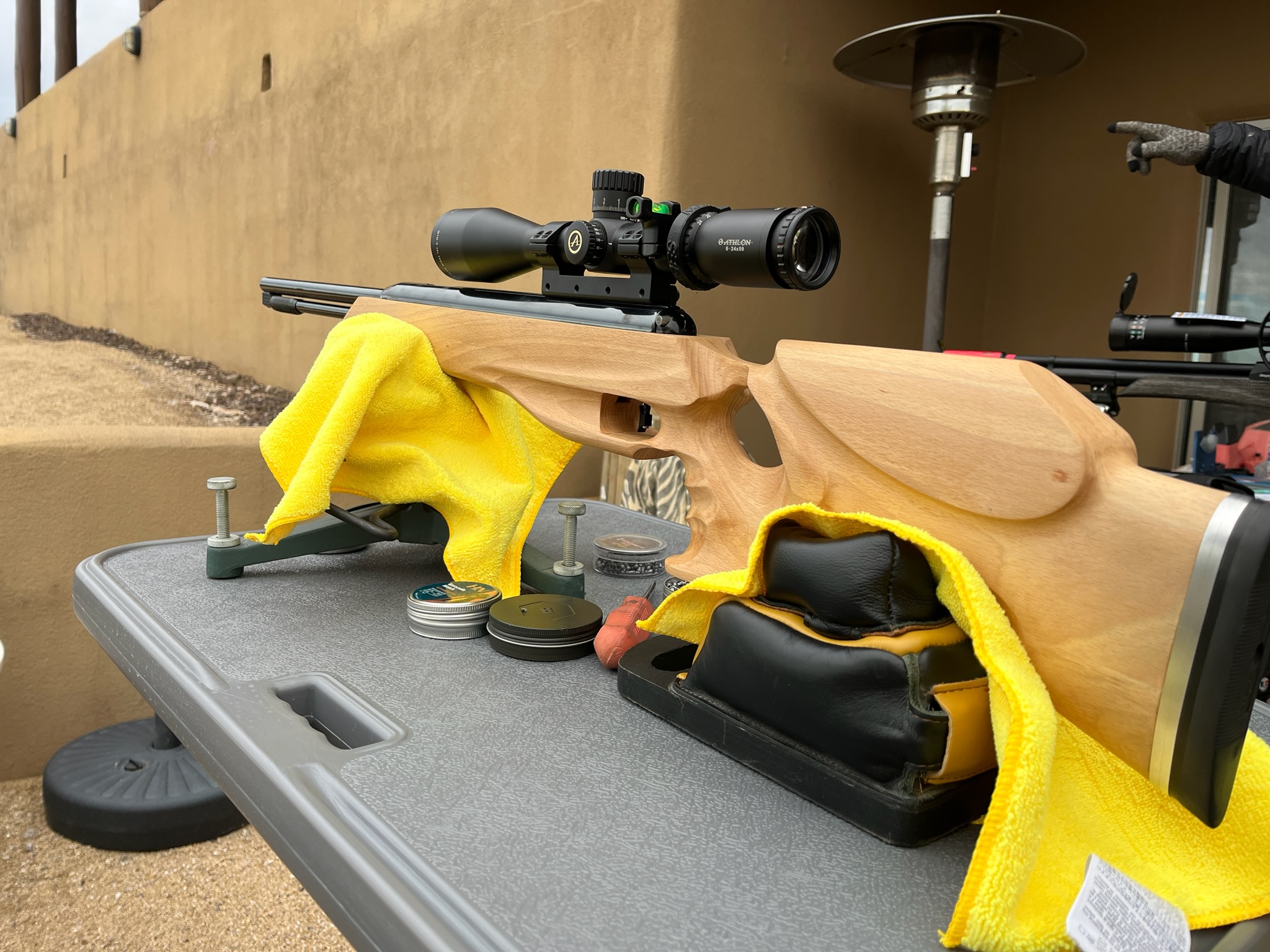

I don't understand why many wood-workers feel compelled to disguise nice natural wood with walnut stain. I see enough personality in that wood that I'd leave it 'in the white', and exaggerate that natural personality under a magnifying-glass of quality soft satin sheen finish. Like these-

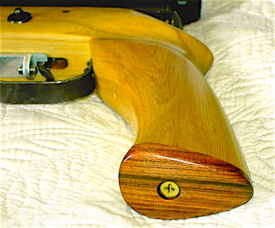

BTW, your stock is begging for a nice, contrasting grip-cap. Like these-

Dads is going to be a lighter color i tested a water based coca brown and red in alcohol and it didnt blotch real bad then i put danish dark walnut which unless its walnut it isnt really that dark with beech. Hopefully it will turn out we will see.

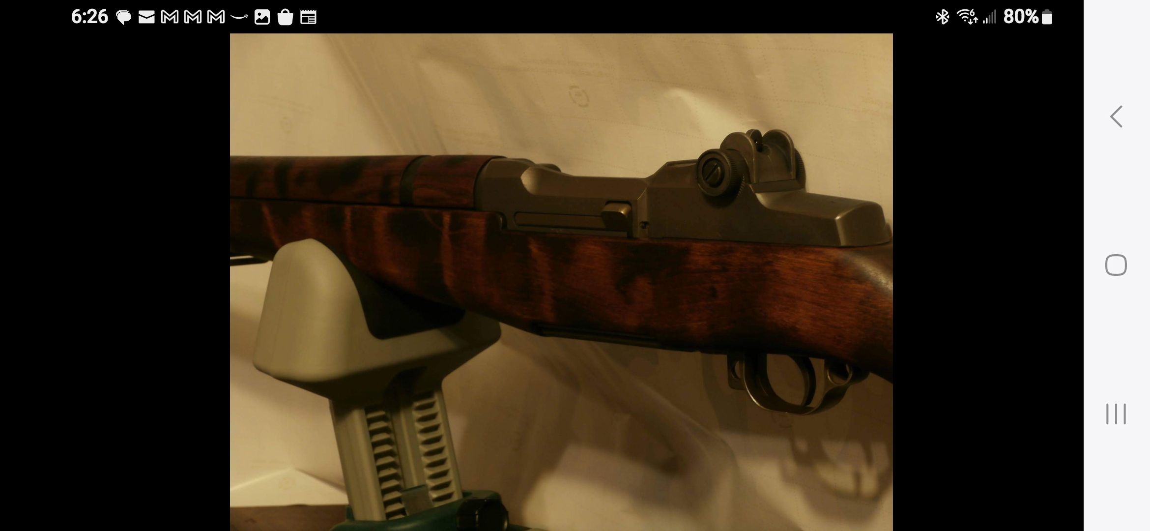

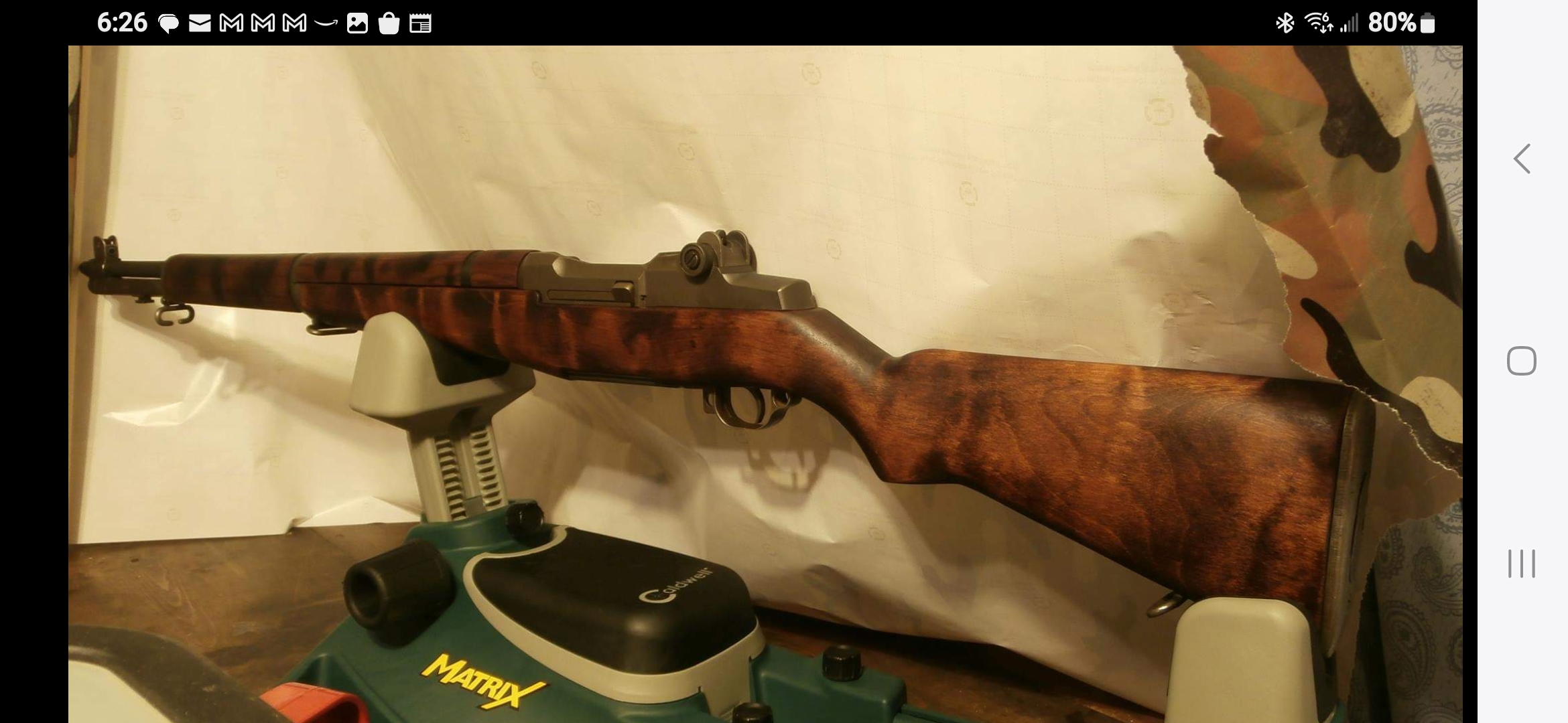

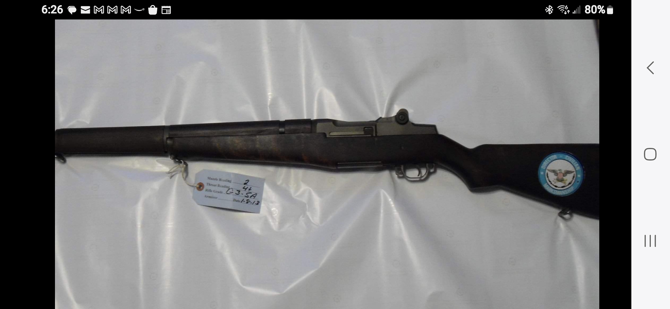

I tested it last night with alcohol mixed with wood dye then i put watco danish dark walnut over it and it seemed to blend nice and one section i tried a hickory gel and it covered grain to much. And plain oil was to light. In the past i have used rit dye on older beech stock it was tiger berch or tiger beech whatever its called. I used a the rit dye to get the red in the stock period correct and used a m1garand oil and a m1 garand bees wax mix to keep it period correct. I done this m1 years ago my Hr and my springfield.
Very Nice!.. I’m glad you were able to get the results you were looking for….nice Garand..one of my favorite rifles..John
