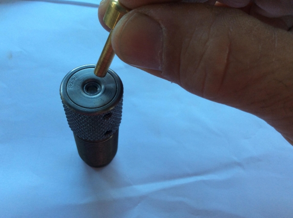

Purchased a head gauge which allows, say in 6.35 , a range from 6.32 through to 6.42. First tin of jsb kngs 25.39 gauged.
Result 60% 6.38
35% 6.39
5% 6.40
So next stage is to assess whether the 6.38 stck in mag and any difference in Chrono figures
